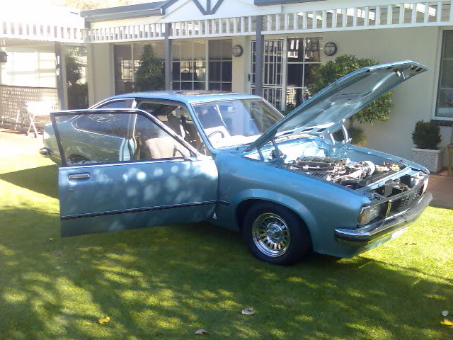

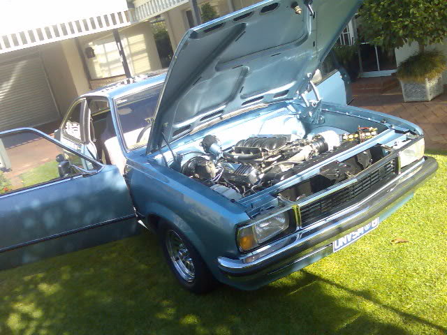

well it wasnt the throttle body... hmm its sounds very much like a vaccum noise but i cant find where its coming from... car seems to be running fine besides that very loud noise.. anyone got any ideas? its at the front of the motor im sure..

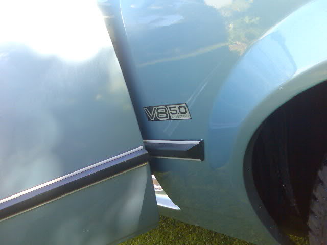

anyways took the car out for a wash much needed wash too! heres some pictures sorry they are from my phone but turned out alright
and a little something i bought the other day to finnish it off :D

What did you do to isolate the throttle body from being the noise?
These are noisy at idle with no aircleaner and if thats a pod filter in your pic, that would hardly mask the noise.
Lift the throttle a whisker off idle and see what happens.

I see you have a pod filter on there, Those throttle body's do have a very loud induction noise at idle, i wouldnt worry too much about it, Best thing to do if you think you have a vac leak, Get some CRC or WD40 and spray a mist around all the possible area's, If the engine Pics up a little from one of the area's you sprayed Thats more than likely the prob, But im going with everyone else on this, its the throttle body noise,
