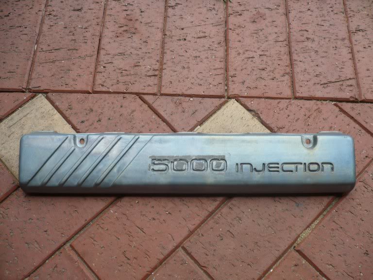

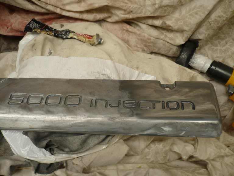

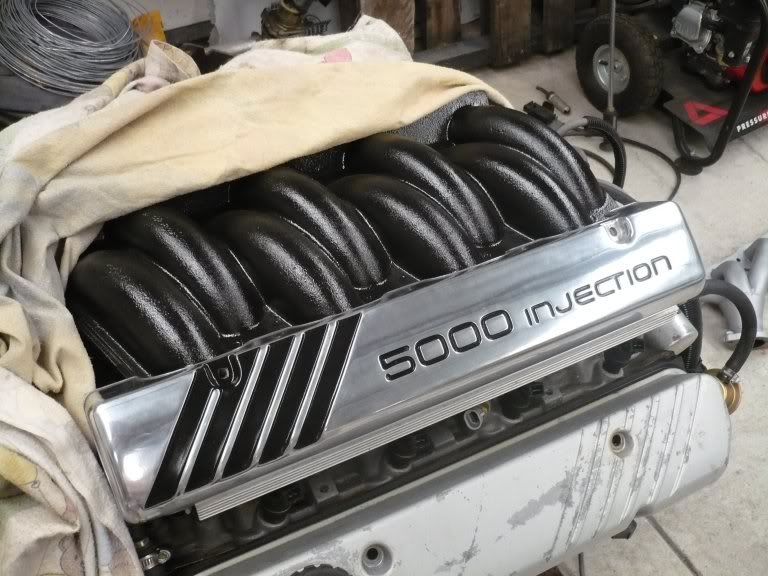

alright guys an update!
began polishing and painting parts on the motor
today i polished the engine covers and added a little paint let me know what you think!
before:
After:

Starting to look good...nifty trick I read on streetcommodores site was that you can turn the injectors around & hide the wiring under the covers.

how did u polish them up? they look great!
#35 _UNVSM8_
_UNVSM8_
Posted 16 December 2007 - 01:28 AM
well i started out by sanding out the scratches with rough sand paper then went up to 1500 grit then buffed them up with my buff on the drill :)
the reason i did it myself was cos i got quoted 600 for someone to do it for me so i was like F#)%($@ that!! haha im pretty happy with the results
Ben

Very nice result, I'd be stoked with that too! What did you use to mask it up to precisely?

well what i did was mask the majority of the area off then spray paint then wipe off the paint where i didn't want it while it was still wet :) now i just got to do the rocker covers and the front piece and i'm done!

Thanks mate, that is a good idea that didn't even cross my mind. I thought you might have just polished the flat faces again after it was dry :P
Silly me, look forward to the step-by-step shots.

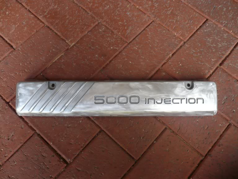

hey guys haven't been on for a while cos my internet has been stuffed thanks to optus but heres what I've been doing while i have been off line
the engine covers are comming along nicely heres what ive done:
wet and dry sanded them up to 1500 grit starting with 400 i think
polished them up with the air drill and polish wheel
and this is pretty much where im up to atm!

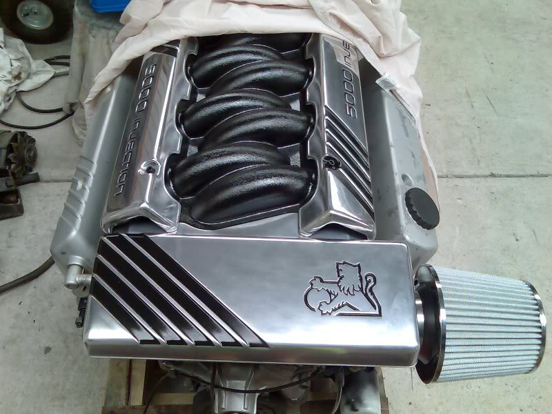

And a small update on the engine
ive pretty much done everything i want to do to the engine and the gear box and wiring loom should be arriving either tomorrow or next week and then just got to get a few more little bits then it will be going in :)
