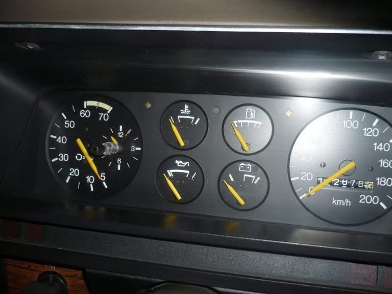

installed the dash the other night which lead to reinstalling the stereo after seeing how poorly it had been done. like who ever did it must not of had a soldering iron of sumthing cos the connections were literately twisted and taped together
heres it in:

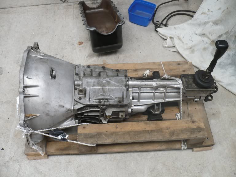

also the gearbox finally came.. some how they forgot to put it on the truck when it was suppose to be anyway its hear now

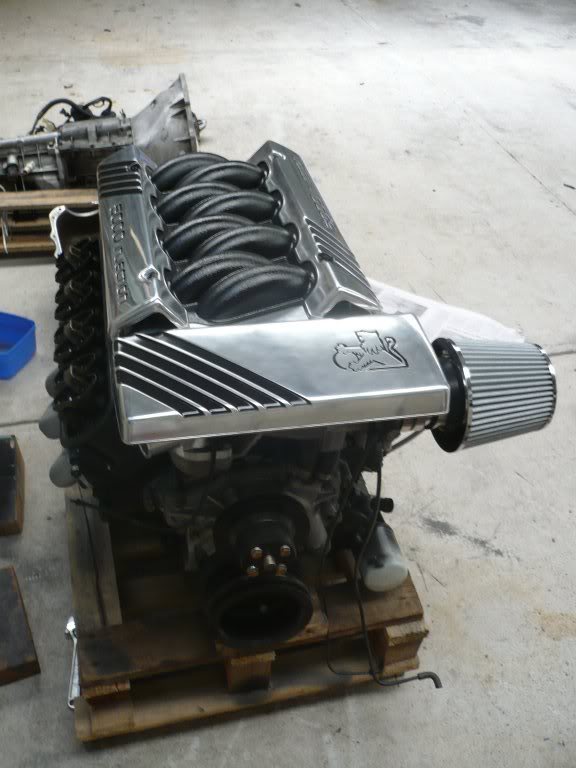

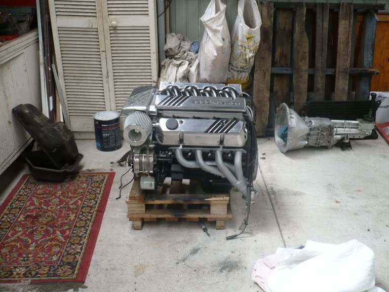

and just a few other pics i took of the engine
Ben

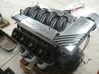

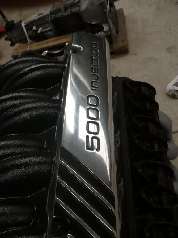

_UNVSM8_
Posted 25 February 2008 - 01:26 PM
hmmmmm!!!!!!!!!!

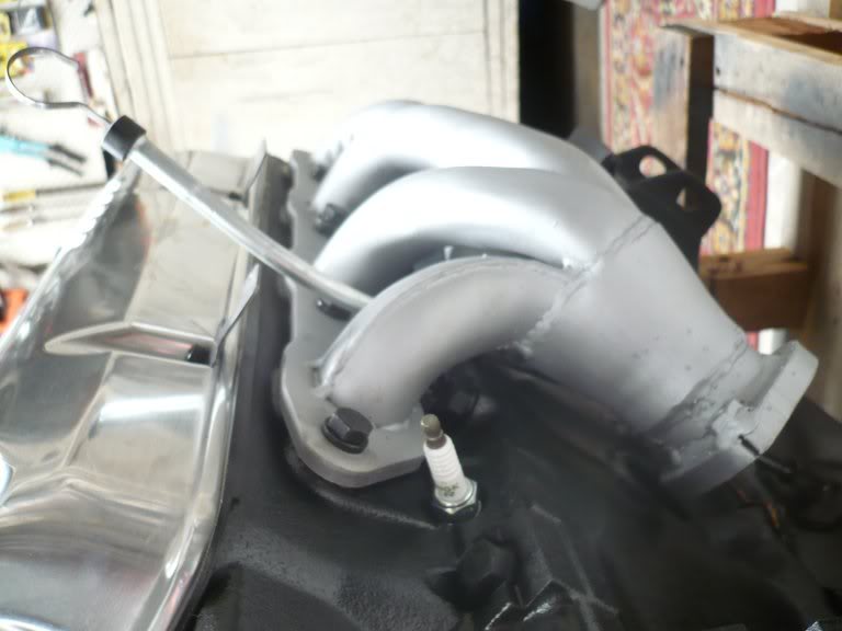

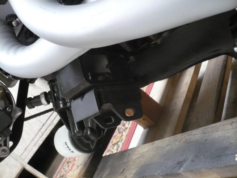

fitted sump is this alright through the middle of the extractors?
and picked up engine mounts
the guy i got these from is the owner of the LX LIMO!! thats right i saw and touched it
sent wiring loom and computer to castlemain auto electrical to get adapted suited for the UC and checked also ordered fuel system through them
ordered low mount alternator bracket off ebay hopefully should come soon
still to get:
Exhaust
radiator
Au thermo fans
if anyone can help me out with them that would be cool
coming along but slowly im out of money so its up to dad now haha
Ben

Posted 26 February 2008 - 05:58 PM
Your A/C is def not going to fit. Rares spares or ebay has the alternator braket, one other thing is to take a knotch out of the firewall where the dissy sits or you have to take the motor out just to get the dissy out. Standard heater box should be fitted and not nead to be modifyed , i found it easyer to take the heater out of the car from under the dash then place it back in one motor is fitted. I used a supra 5 speed so i dont know how you box will fit againt trans tunnel. Use the VN fuel rail (sorry could not remember what motor you have) as VR-VS will hit heater box. It will be a tight fit but well worth it. It should go hard
Chears Neil

#92
_UNVSM8_
Posted 26 February 2008 - 10:32 PM
The extractors are HSV items and we are hoping the will fit with a bit of luck!as i got em with the motor if not will probably opt for the pacemaker ones
hahaha im hoping it will go well
Thanks Brewster i think its probably the most practical setup!
CHeers Guys
Ben

Sorryr late reply my net died, Yes my tailshaft fitted perfectly i used a gearbox yoke from CRS and fitted 1st try. The place were the dissy wont clear the firewall is were the two pieces are spot welded across the fire wall, i have not chopped mine out yet as it was two late one my moter was in (its getting replaced when car gets painted) but i looked at trimming a small bit out with a grinder then re welding were spot welds were (i would take a photo but my cars not at home) I also tryed to fit hsv extractors but i had to get the local muffer crew to chop and change were the oxy secer hit the firewall. You will also find that the coil will have to be moved from the back of the moter, i used a self tapper to fit mine under the wiper moter.
