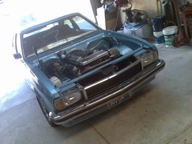

UPDATES!!
shes back on the ground! every thing is in the engine bay now just got fuel system and a few little things... im really excited however i have about 3 uni assignments due :furious: so will see how i go this weekend.
putting it on a trailer tomorrow arvo and taking at around so its there for the exhaust dude thursday (dont worrie it will be going in the workshop not out side lol)
unfortunately i'm going to have to get rid of my sound system to make way for the fuel system but no biggy will make something new up!
looking at the photo above makes me wish i could keep the bonnet off lol

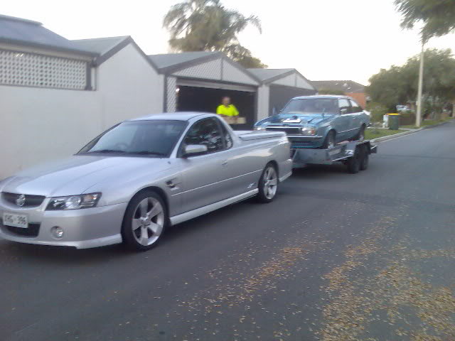

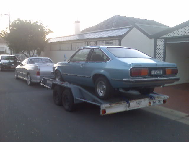

took the torry to the exhaust place tonight was a big pain to get it on because its so low at the front but we got it there and in one piece lol heres some pictures
sorry bout the quality but mum took the camera and keeps forgetting to bring it home..
the exhaust dude is going to run twin high flow cats then a cross over into twin mufflers and up over the diff and dumped out just behind the rear wheels up as high as possible should look and sound great :) and 100% legal i believe well he told me so...

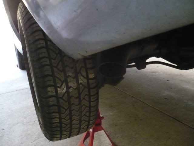

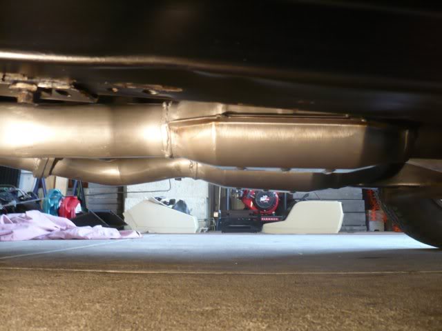

well got the car back this arvo! exhaust guy did a great job very neat cant wait to here what it sounds like! heres some pictures!
tips are nice and high up and looks tough! im happy :)

Looks SICK. I bet it sounds almost as good, love the dumpipes, fits with the more modern look.

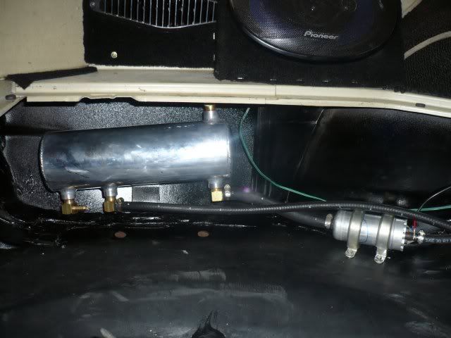

well atm mate should be sweet as in SA no need for engineer and so far have re rego'd the car as a V8 and have not had to go through regency most probably cos the cars in dads name anyhow heres what my fuel system is looking like atm
will make a cover to cover all this up which i will coat in sound detener cos apparently the fuel pump is a noisy bugger lol even if it is i got the exhaust to cover it up and if that fails the subwoofer :P

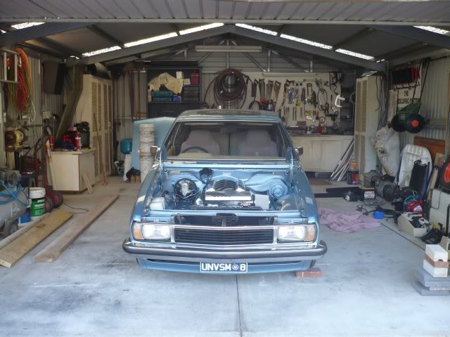

and just one of how shes sitting atm :)

Doing well so far, But your fuel system set up shouldnt really be in the boot If a cop wants to be a right prick and get you a little birdy they will pin that set up if they see it,
Not having a pick, because i know people that run fuel cell's and all sorts
PM LXDAMO His hatch has all external setup with swirl pot and fits really nice,

If the pump closest to the surge tank is the EFI pump then you will have fuel problems on acceleration. You need to lift the front of the surge tank as high as possible and feed the EFI pump from the rear of the surge tank.
It would probably be better to cut the top off the surge tank so you can stand it up.

but mate theoretically the surge tank should be full at all times so this shouldn't be a issue how ever i see where your coming from and will change it..
