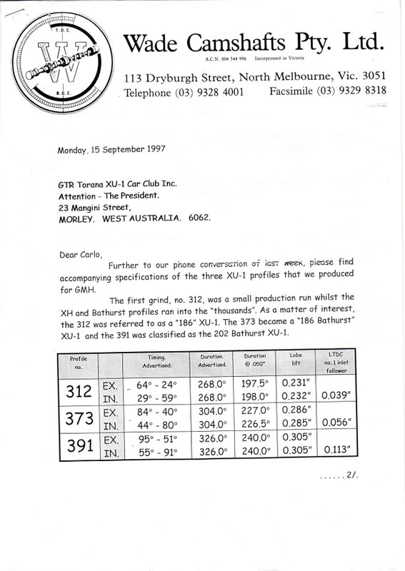

heres a copy of a letter i got from wade cams years ago.

Thanks mate thats great info so the ck xu1 had a 373 seems like a pretty lumpy cam for the street. :spoton:
