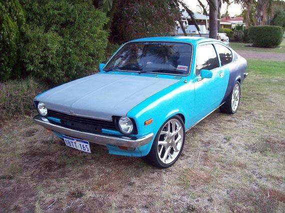

In all her glory before I hit a pole :)
Just after I hit the pole :(
How she was just before I stripped her

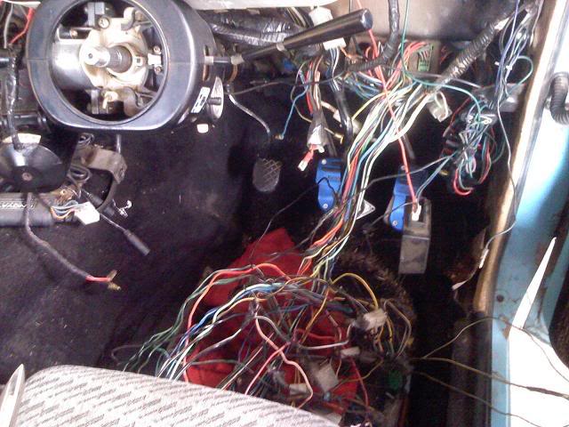

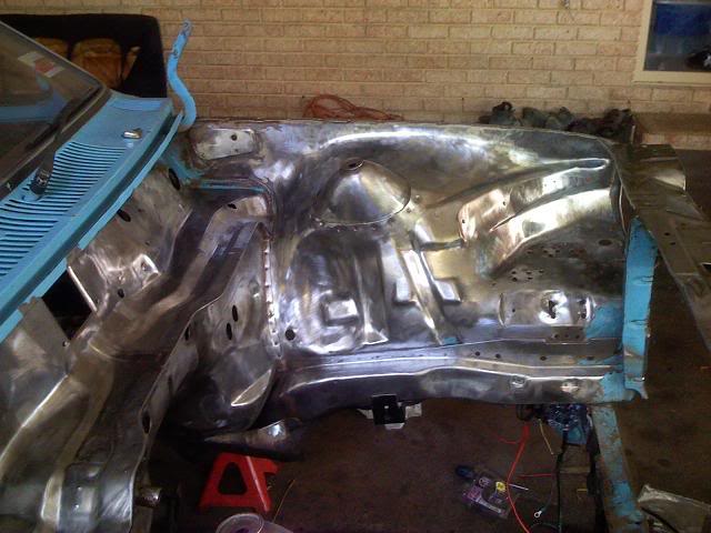

Getting started on hiding the wiring... At this point I was wondering what I got myself into!
Turbo Dummy fit

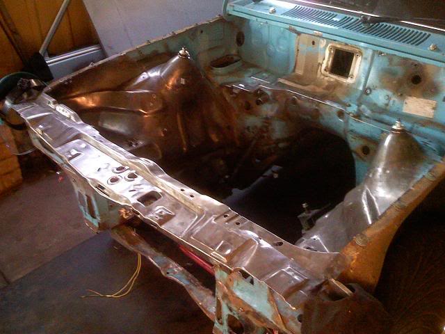

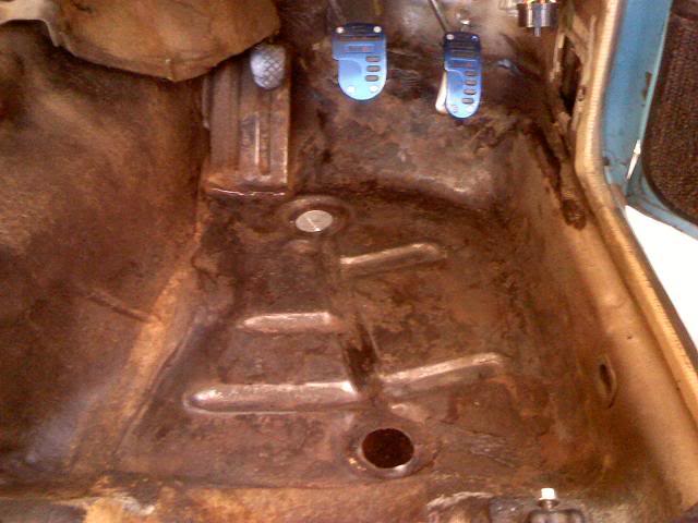

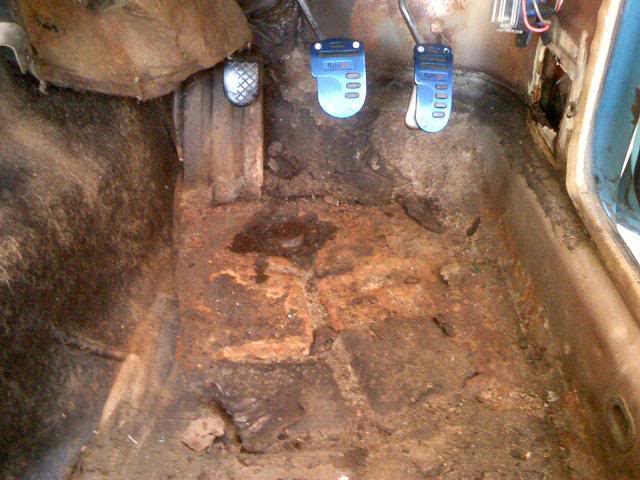

Cancer starting to attack my floor pan!
Retaliated with Grinder and wire wheel

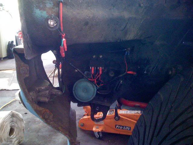

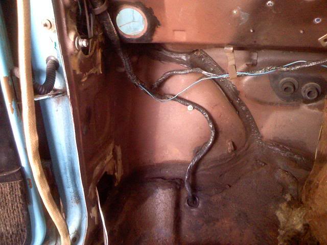

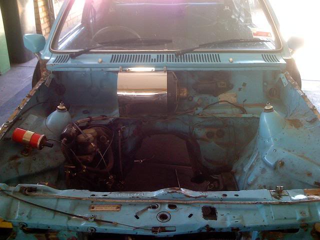

Well Ive all but finished hidding the wiring from the engine bay, Routed it through the chassis rails and out under the guards... Turned out pretty neat I reakon :)
Where I entered the chassis rail through the floor pan on the passenger side:
And where it exited the chassis under the guard. (sorry bad pic) Relocated the horn to here and mounted the headlight relays there too...
Pretty much exactly the same on the drivers side just didnt get pics... Just need to route the EFI wiring and then I can move onto smoothing the engine bay and filling all the un-needed holes :D

Ooops Forgot to update here, Heres my progress over the last week or so...

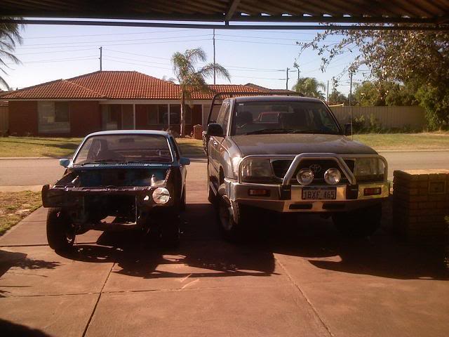

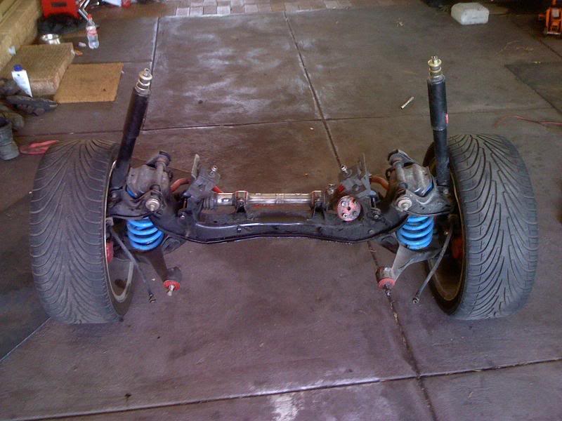

Engine Being Evicted
My Canvas

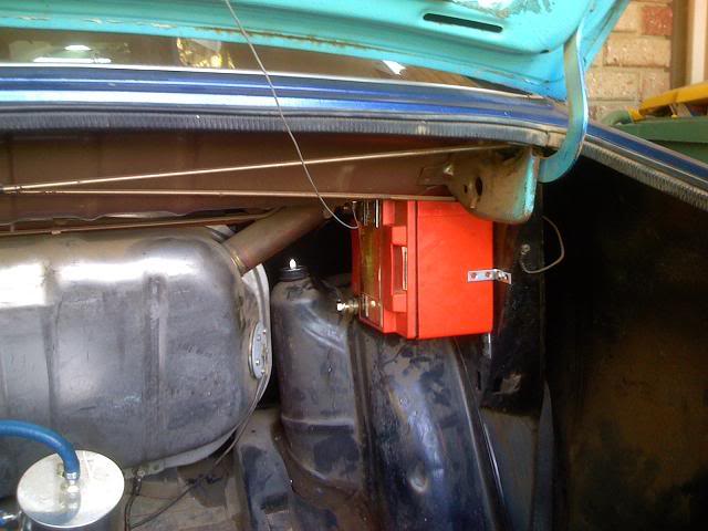

Battery In the boot (dw the mount for the battery is being replaced with a propper oddysee weld in battery mount, made specifically for this battery)

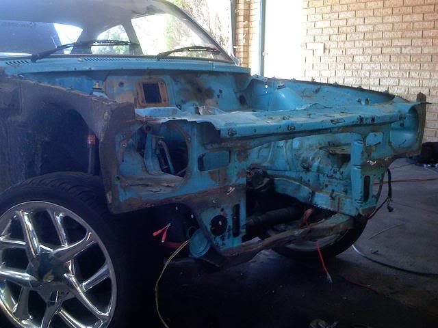

Front Apron removed and bay stripped of peripherals

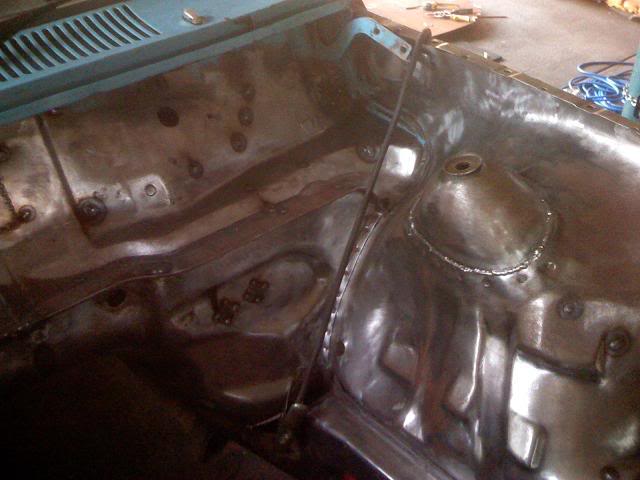

Half way there (this part was not fun!)
Hah Landcruiser dwarfs the Gemi!
My new motor! Barely 1Manpower and runs on Pure hungry jacks!
Front end out, lookin abit dirty after about 6months in service since rebuild
Pretty much all stripped!

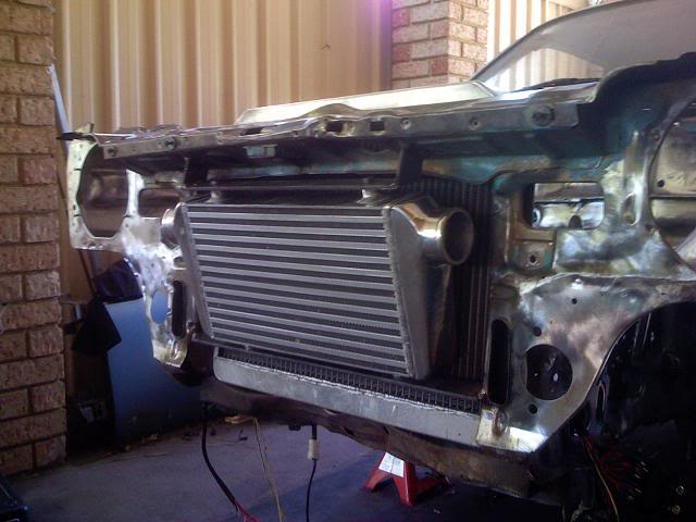

Intercooler mounted :)

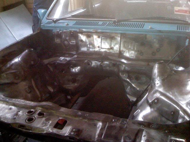

Holes all welded up
And thats about where Im up to atm... All the welds have been ground back and ready for primer and a little bit of filler!

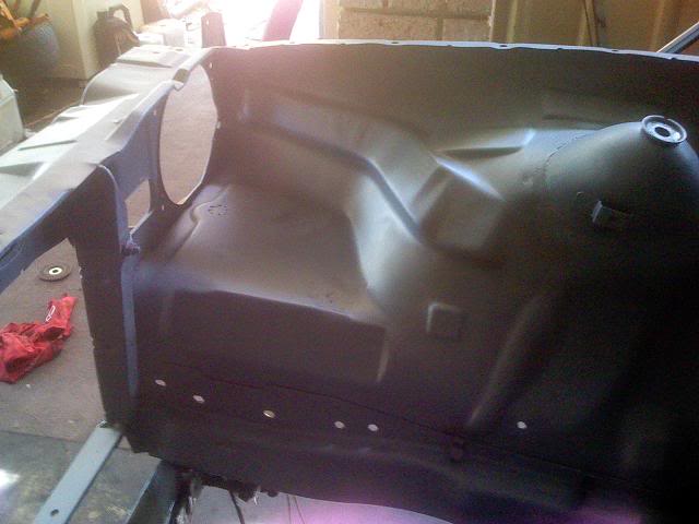

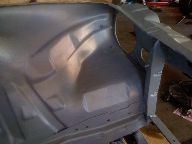

Finished grinding down all the welds, rust proofed it all and got it in primer, yay!

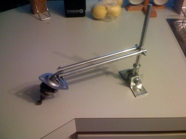

My new remote shifter arrived today also :) looks like it will work well, anyone who's familular with Gemini's will know they got an awful shifter position and a huge throw.. this brings the shifter to a better position and shortens the throw considerably :)

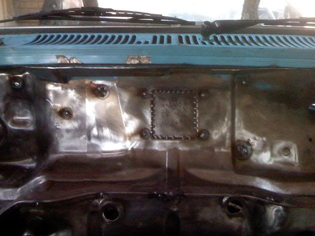

engine bay looks great! what did you use to rust proof it? also, i noticed in a previous photo you filled a square hole? did you weld all around it and grind it back or do you just plan to seam fill it?
#18 _Viper_
_Viper_
Posted 25 January 2008 - 09:55 PM
Por15 on all the welds on the opposite side, Then since the bay was in bare metal for a few days I used the wire wheel again to remove any surface rust I could see then use a Rust Treatment/converter on the whole bay just in case... Then painted in primer...
RE the square hole, just did the spot welds that you can see in the pic, grinded the welds flush and will use filler to make it all smooth, The POR15 actually has excellent build properties and when I applied it from the inside it filled the small gaps that was left..
This is the first time Ive done anything like this, I donno if its the best way but Hopefully works.... Its what I was told to do anyway

Here's that remote shifter installed, Much better then the stocker... about 1/3rd less travel and alot better position

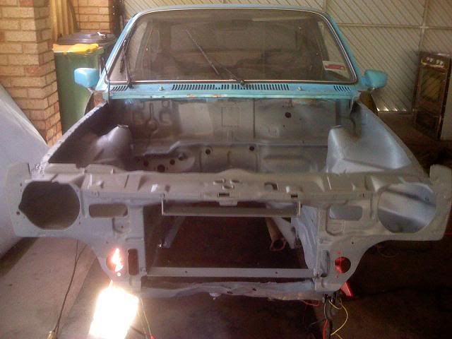

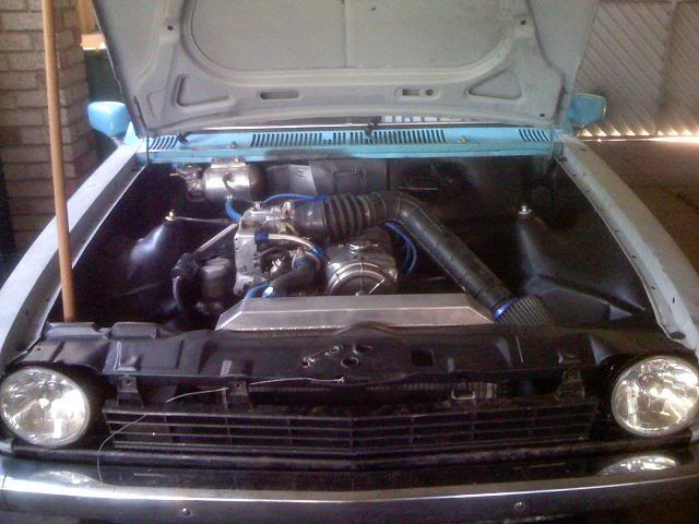

And couple pics of the engine bay with just the N/A Motor fitted.
Thats pretty much all that goes in the bay, The header tank will be relocated to the rear left corner of the bay (mounted on the guard) and another polished alloy tank will be mounted on the opposite side for the windscreen squirters... Oh and the Turbo and cooler pipes of course :D
The wiring for the motor comes out of the firewall at the rear of the motor (barely visable) and a couple wires at the very front for the headlights...
Still abit of filling left to get it all perfect, and Gas struts to be fitted... but im pretty happy with it :D
