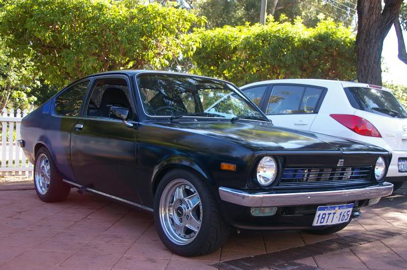

Posted 15 June 2009 - 07:29 PM
Just a pic from the GemsWA.com cruise on Sunday (ignore the seatbelt haha)
#52 _BAILLIE_
_BAILLIE_
Posted 15 June 2009 - 09:04 PM
Nice gemmy mate, looks like you'll be ready to paint in no time.
Great little cars too, easy to work on and really fun to slide around in. :spoton:
