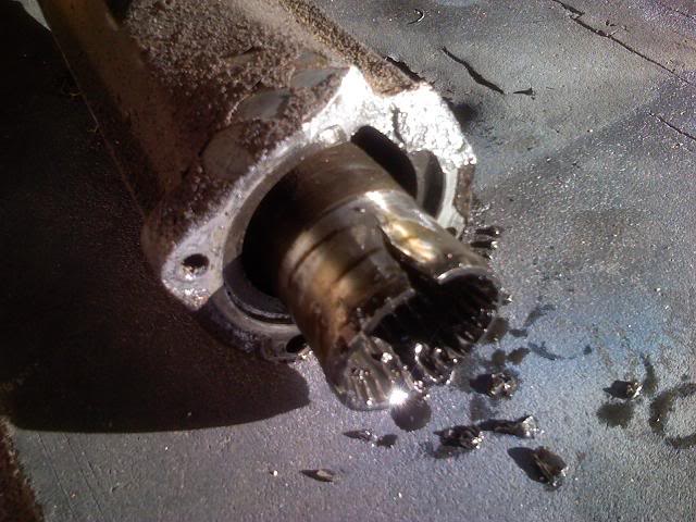

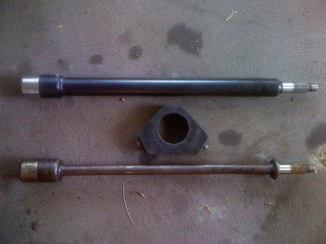

Heh After fitting the new custom clutch and figured I better "Test" It I Blew the Torque Tube apart and damaged the diff :/
What was left of the Torque Tube... Dam I hate those thing, Gimme upper trailing arms any day!

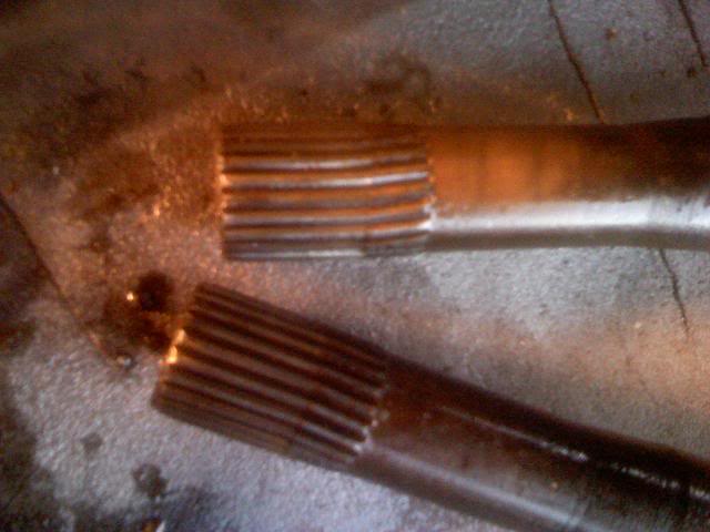

And Twisted Axels:
I actually Already had a Strengthened Torque Tube, just never got around to fitting it... Here's a comparison to a stock one, also shown is the Heavy Duty Torque Tube rubber.
But thats all fixed, Put the spare diff I had in and fitted the Strenghtend Torque Tube + Rubber :)

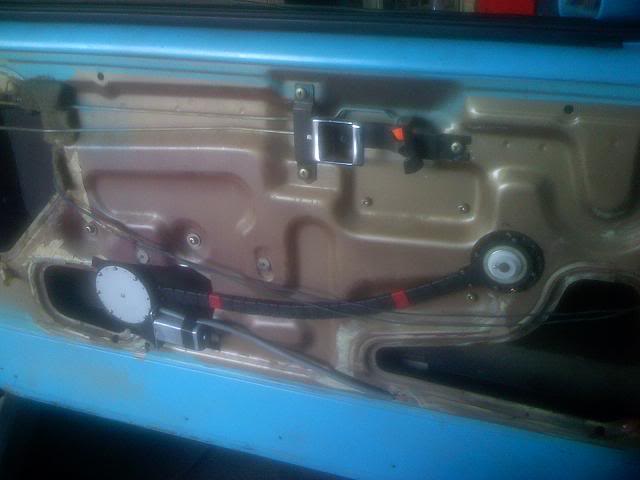

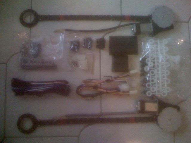

Since Then I fitted a Universal Power window kit :D Works a treat...

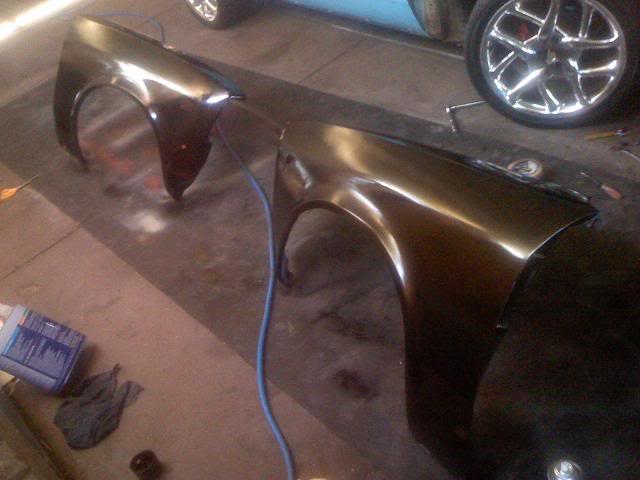

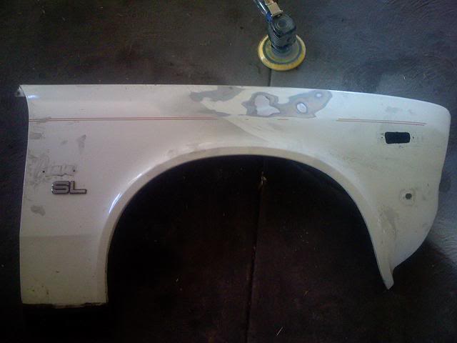

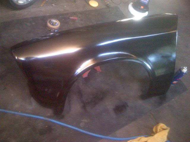

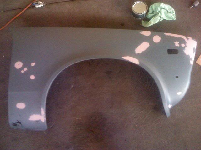

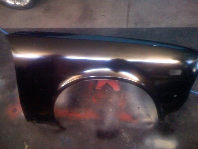

Horay For easter Holz :D Made a start on the panel work over the last 2 days, Almost got the 2 front guards done..
Spare guard I had just as I started:
After I sanded it back and layed down some Etch primer and doing abit of filling:
Bit of rust to be cut out and fixed up in the bottom left cnr of the Drivers guard:

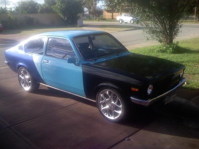

And layed down a couple of coats of Black, just to keep the Rust bunnies away while I slowly get the rest of the car ready for paint (is my daily driver so I goto do it bit by bit) I was actually suprised how good it turned out, Just used pressure pack cans... if it didnt splatter and shit it woulda turned out mint..
Is good that im covering in black first as it shows every little defect and I actually found 2 very shallow dents that I totally missed before hand :)
Will do the Front apron and maybe the bonnet tommorow :D

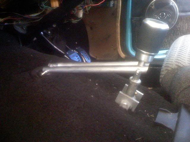

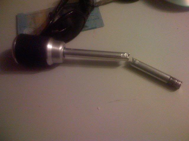

Heh well as some would know I snapped my custom Remote shifter at the drags on wednesday night... I managed to salvage what was left of it and ended up being a Super short shifter... Turned out pretty good actually, I like it better then before :) And hopefully because I wont have as much leverage and I didnt drill the hole as large it wont snap this time!
Before:
Broken:
Now:
Ill polish it all up to a mirror shine later when I can be ass'ed

thats a neat setup with the shifter, i always hated the shifter in my old gemini.
what size rims are you running?
the reason i ask is because i reckon thats why you copped the problems with ur diff.
if you have just stepped up a few inches in rim size, you may need to go for a shorter diff ratio or better diff altogether.
i had a datsun stanza and my when it needed new tyres my mates thought 15in toyota rims looked good,
then 10min later, 1st burnout attempt and bang... snapped the axles,
next day we got some axles in and we were ready to go, this time we spent an hour on the dirt,
then went to lay some rubber on some backroads... BANG... the diff blew this time...
welded the diff, put the original rims back on and it was fine :blink:
Edited by SLR_6, 28 March 2008 - 03:52 PM.
#38 _Viper_
_Viper_
Posted 28 March 2008 - 05:58 PM
There 17's with 215's and yea larger rims and the wider rubber have better traction so easier to brake stuff as it takes more force to break traction...
But yep Im looking into getting a Hilux diff fitted, just goto sort of with the engineer how to do it legally as there is no way to fit upper trailing arms and Have to fabricate a single control arm but needs to act exactly like the stock Torque Tube in order to get it passed.. Got a few ideas tho :)
Edited by Viper, 28 March 2008 - 05:59 PM.

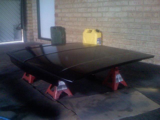

Hey guys, Getting some more practice in with the panel n paint :) Did the bonnet altho Im not happy with it and Ive also been learning to polish alloy as well :D

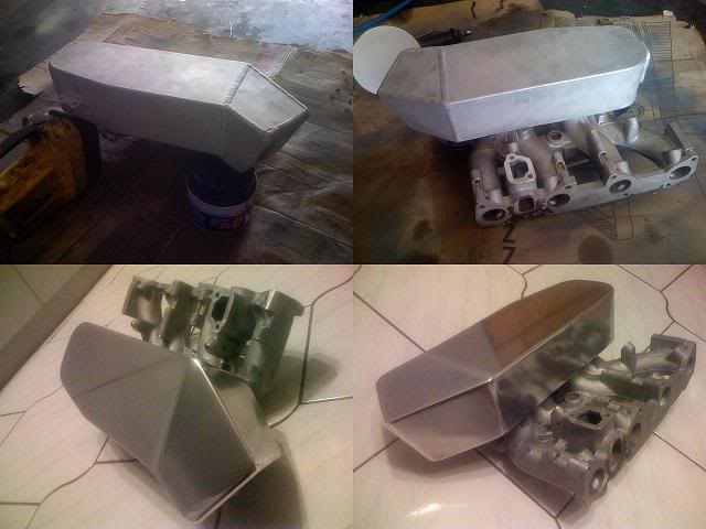

Here's a montage of before and after shots of that intake :)

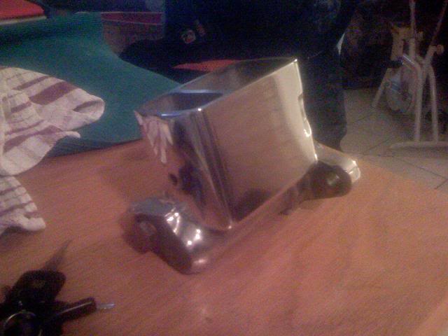

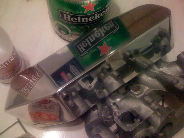

Finished the polishing on the intake:
Lower half is being ceramic coated at a later stage, mainly cos its jus too much of a pain to polish and will be coverd but all the bits anyway... but yea mainly cos im lazy

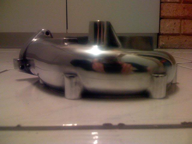

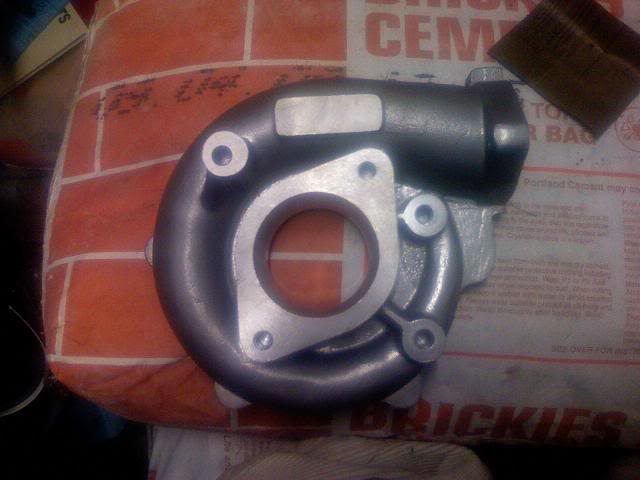

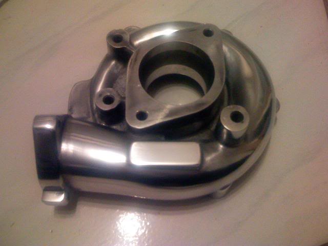

As well as the GT28 Turbo compressor housing:

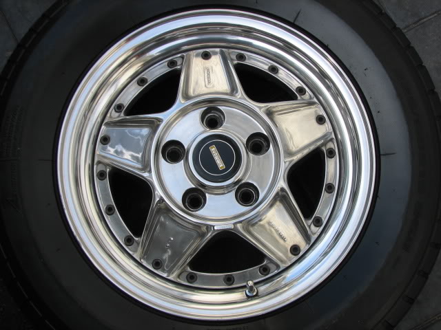

Picked up my new mags:

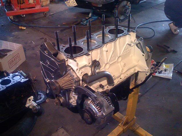

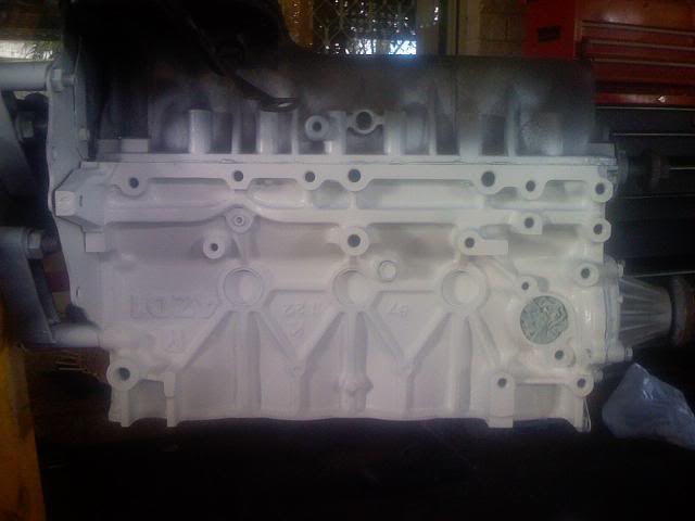

Cleaned up and detailed the block:
Head studs arrived yesterday:
And dummy fitted the intake and exhaust:

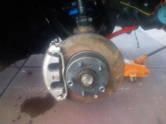

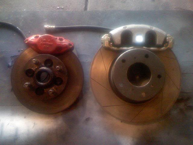

Waiting for Romac to re-open so I can order my full spool and fit the 28spline commo axels and commodore discs :)

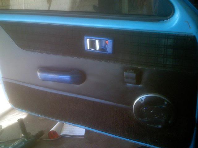

Some door trims I made up
Diff, converted to commo 5-stud, disc brakes, locked center, Lowered springs and adjustable sway bar

Looks good mate, where did you get that shifter or did you make it yourself??

And what did you do to 'detail' your engine block? Cleaned up some areas with a grinder or something i'm guessing?
#50 _Viper_
_Viper_
Posted 15 June 2009 - 11:36 AM
That shifter I originally got from a guy from the east, but can easily make one myself now ive seen it... Ive snapped this one twice now tho! it was only made from alloy and the hole through the main shaft creates a major weak point... If I was to re-make it id make it out of Stainless steel and brace that section. But Ill be fitting a larger/stronger gbox in the future which has a remote shifter built in so wont need it.
Yea heath, I actually still need to do the passenger side door trim so Ill do a writeup when I get around to it :)
And nah didnt do too much to the block, just cleaned off the old paint and gave it a respray... but have to be very careful with oil leaks on a white block haha.
