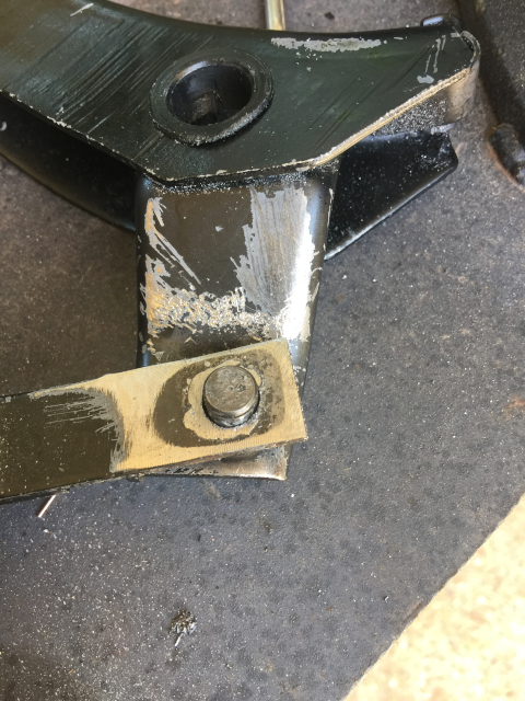

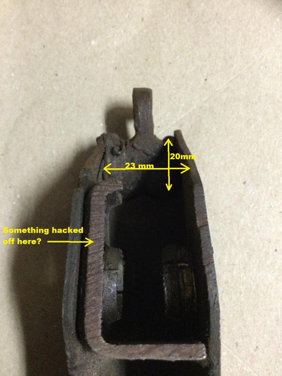

Posted 01 January 2021 - 11:32 PM
Rob, modified 6cyl LC, LJ clutch pedal.
This pic shows the part that has been hacked off the pedal in the above picture.

What’s the name of the brakes shown in the picture?
If I can find one of these to measure that will also help confirm the distance.....31mm = 1.25”.....seems believable and matches what I was I was thinking.
Would these brackets be fitted to the auto models? Would increase the chance of finding one to measure.
The difference in distance from the pivot point can be worked out from one of these:
On a HZ or WB the cable head stays in the same position, and the pedal pivot drops. On this bracket the single hole goes under the bolt head that the brake pedal pivots on. On a 6cyl the clutch pedal bolt goes through the top hole, and on a V8 the bolt goes through the bottom hole. The pedals are different - the hook remains in space, thus it is further away from the pivot point with the V8 pedal. The difference between the two is the distance between these two holes in this bracket. Here is a picture showing you the 6cyl and V8 pedals (the two on the left):
The V8 pedal is also shorter between the pad and the pivot by the same amount the hook is further away.
If you can’t find one I’ll have a look in the shed, I’m sure there should be a fair few full pedal sets floating around somewhere that I can get that measurement for you.

What brakes do you mean?
Only on manual. On the far left of the bracket where it folds there is a big hole which is what supports the clutch cable outer. Here is a better picture. The cable goes through the firewall and seals with a big rubber grommet, and the plastic head sits in the hole on the end of the bracket.

Just found a random one in the pile under my bench. 60mm from the centre of the hook to the centre of the pivot.
