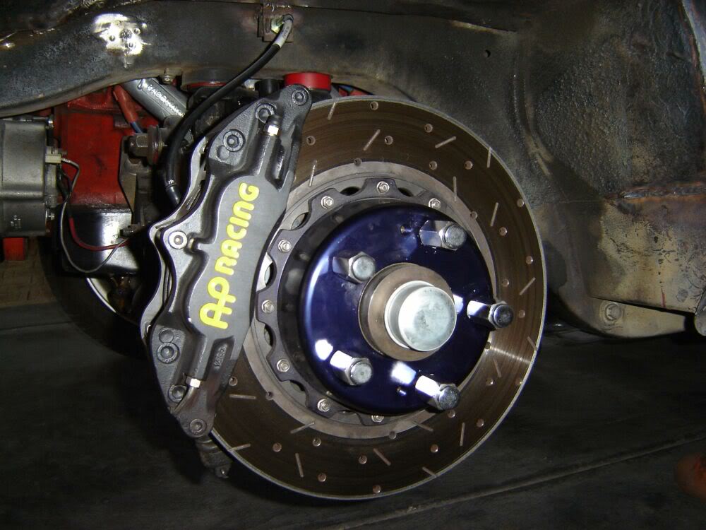

dattoman would you like a pic of the 330 rotors and AP calipers to post on here? I gotta say they do look awesome

Just FYI for those reading this "the gts" has the AP 4 pot calipers and 330mm 2 piece DBA discs on his Torana using the CRS stub axles setup for Commodore brakes
The adaptor brackets I usually would use on Commodores didn't quite fit so Phil had to make up his own brackets to move the caliper slightly to clear the tierod end
You might need to make some more brackets for the rest of us Phil........lol

#43 dattoman
Posted 18 February 2006 - 01:45 PM
And it goes alittle something like this
