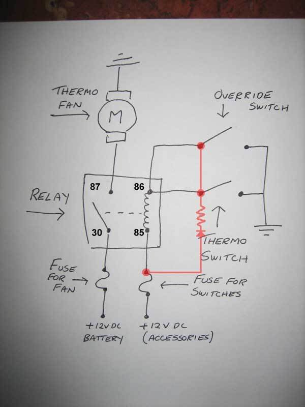

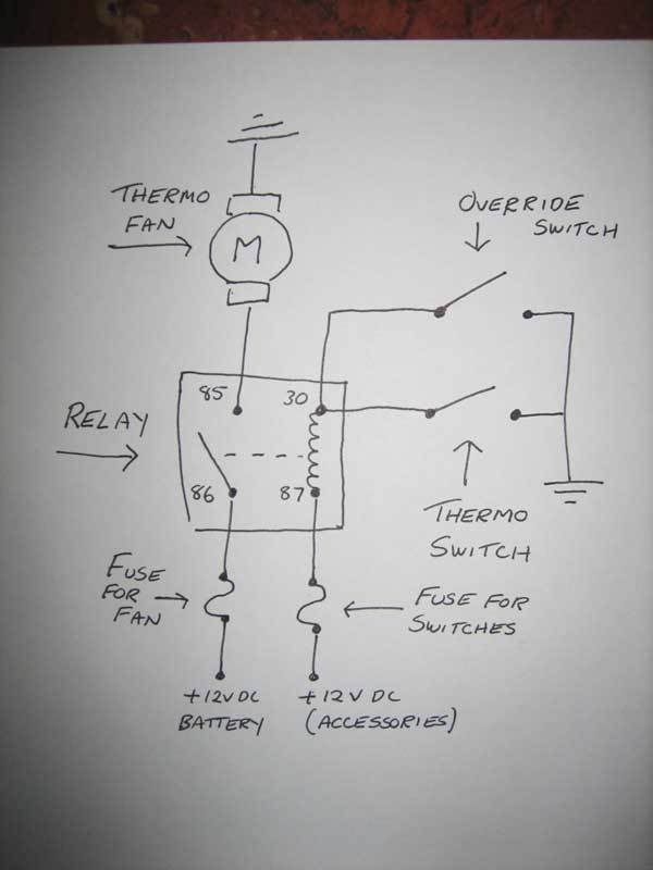

This is how I've wired my thermo fan.
#6
Posted 25 July 2008 - 07:58 PM
Number 30 should be 86 and vise versa.
Number 87 should be 85 and vise versa.
Edited by antelopeslr5000, 25 July 2008 - 08:03 PM.

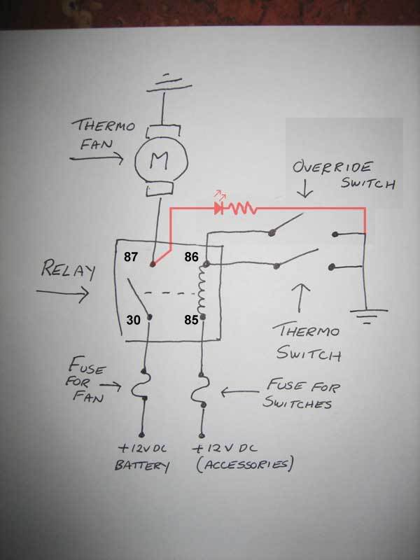

I've had a think about that layout antelope... Would you mind taking a look at my theory shown below to see if i've stuffed up?
Basically i wanted to switch the -ve side of the fans.. I'm told that this is nicer to the relay than switching the power side ( I dont see how in DC... the current still needs to be switched through the relay .. so it'll need to be a BIG relay!).
Also ive included an LED indicator to show when the fans are running (thermo switched OR overridden).
Can you guys see any mistakes in my plan?

The LED wont work like how you have drawn it as once the relay pics up you will you will have the negative or earth at both ends, so again use ants method switch the 12v. The 12v going to the fan should also run to the LED but you should run a resistor ( I think 560ohms) in series with it otherwise you will blow the LED unless its a 12v lamp that you run instead. If your running a LED let me know and ill figure out what size it is for sure but like i said i think from mem its around 560 Ohms.

The way you had the LED wired, when the relay contacts are in the open (relaxed) position, you still have an earth path from your +12VDC source (battery) through the thermo fan and LED. I'm thinking that the LED wouldn't have like that!

ant , that looks good however i think the LED should be fed from 87 the same as the fan, the way you have drawn it will let you know if the sender or the over ride switch is turned on but if the relay fails the light will be still on, if its connected to the 87 terminal then you know that power is getting to the fan, hope that makes sense
Yes, very good point!

Your right about the LED, I wanted an indicator for when the fan was running, and i realised i would need a resistor too, but i had no idea about the size resitor i'd need!

The only problem I can foresee with this schematic is if the fan does suffer a failure which doesn't blow the fuse and the relay contacts are closed, the LED will still illuminate. However, it is better than my second effort!

Thats true but there is nothing more you can do besides getting out and checking to see if fan is working, if the lights on and your car starts to run hot check your fan to see if its working if not , then your fan is knackered because its will be obvious that the relay and circuit are working. Not much more you can do .Third time's a charm!
Print that diagram out Tiny , thats the one

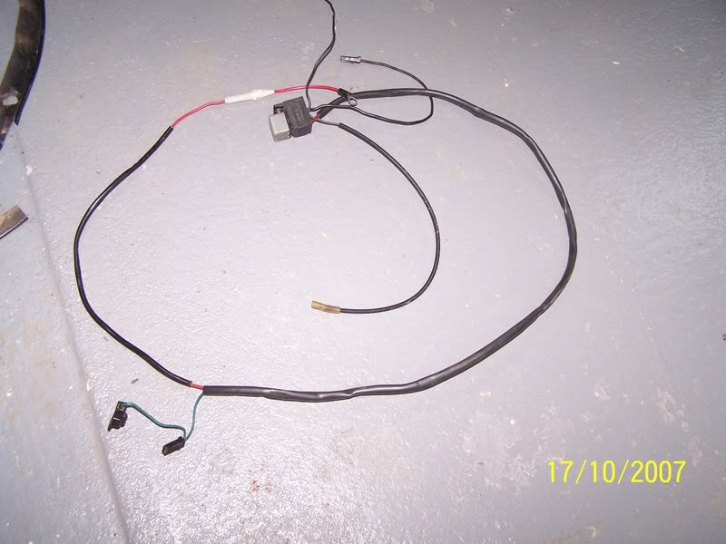

Yes, i agree there, I think I have a pic of the original harness
