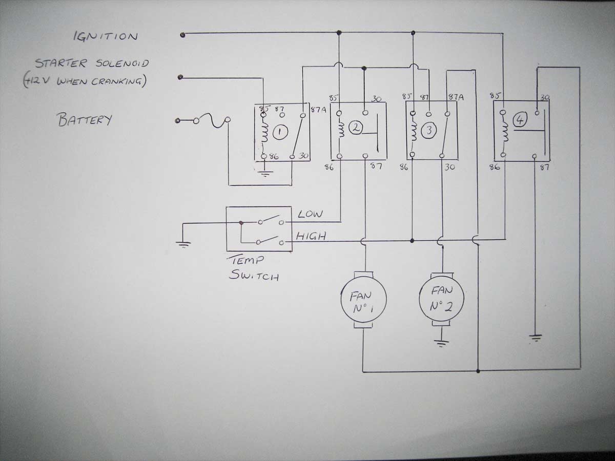

I think someone gave me a circuit diagram for that Antelope :spoton:
#62 antelopeslr5000
antelopeslr5000
  • 1,022 posts
  • Car:1977 LX SL/R 5000
  • Joined: 10-November 05
Posted 21 January 2009 - 07:09 PM
lol... Did it look something like this?
#63 Tiny
Posted 21 January 2009 - 07:18 PM
It did!
And i reckon he's a smart fella too!
:clap:
