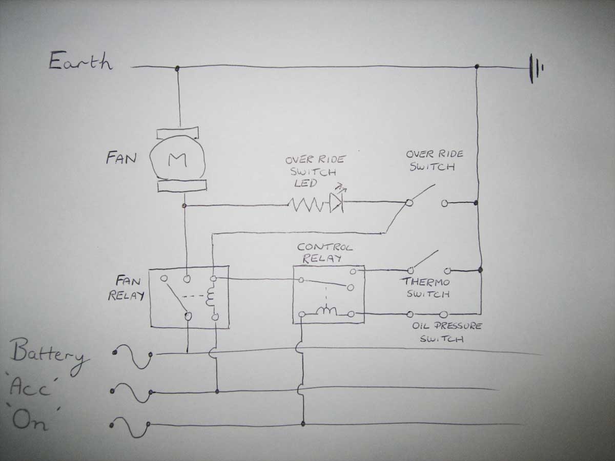

For additional safety, also consider putting in a device that will shut off power to the fans if the engine isnt running(as for electric fuel pumps or lpg solenoids), as the wiring is at present the fans will run solely if the ignition is switched on.
Not 100% correct. For the fan to run, either the over ride switch and/or the thermo switch needs to be closed. It will not run solely if the ignition is switched on. However I can see your point. If the engine is at a temperature that will close the the thermo switch then placing the ignition switch in the "ON" position (or "ACC" position) will trigger the fan. If you wanted you could power a relay solenoid from the D+ output of the alternator (the point from the alternator that also supplies voltage to the alternator warning lamp) so that the realy is only energised when the alternator is running AND servicable. If the alternator fails then you'll have the possibility of losing the thermo fan also. It would probably be a good idea to have an over ride switch in this scenario.
Another consideration with your trigger wire is to not have it activated when the starter is used, as for a hot start providing another possible 40A for the fans is an extra load that might mean the difference between with a successful start

With the ignition switch in the "START" position (i.e. engine cranking via the starter motor) power to systems connected via the "ACC" supply do not have voltage, only systems connected to the "ON" & "START" supplies do. As the relay is energised via power from the "ACC" supply, the relay contacts will be in the open position during engine starting and no power will be supplied to the fan. That's my understanding of how the "ACC" supply works. Please feel free to correct me if I'm wrong.

I am concerned about torbirdie's comment about the fans triggering on startup if the radiator is hot because that is a situation my car often finds.
I wonder whether antelope is right in that the relay would be open when cranking? I'd really like to save those 30-40A for the starter!
And correct torbirdie, i'm using the D+ terminal as a junction because my battery is boot mounted, and via the main wire of the starter being the junction for the power from the D+; the rest of the car; the main battery lead, the D+ terminal will always be 12V Live.
Thanks again guys.. It's not something i'm doing tomorrow.. i just wanted to get everything sorted so that when i do attack it i know it's going to work!
The consensus at the moment is: The last image posted by Antelope is the best version to use?

Do you have an oil pressure switch or an oil pressure sender Tiny? If you have an oil pressure switch you could use that to help control a relay for fan operation when the engine is running (providing you have correct oil pressure of course!).

Maybe a tachiometric relay might be better to read ignition pulses?

you could really make the circuit overcomplicated , the last drawing is a very good example and thanks Ant for continuously drawing it to help show what we were talking about. The acc should turn off while cranking so you will save the 30-40a for starting.

Well, this is what I had in mind with regards to the oil pressure switch control.
The schematic shows the ignition switch in the “ON” position, the engine not running, engine temperature below the threshold for activation of the Thermo Switch and the Over Ride Switch in its OFF position.
In this scenario, the Oil Pressure Switch will be closed (no oil pressure) and the Control Relay solenoid will be energised. With the Control Relay energised the Fan Relay solenoid has no earth path and the Fan Relay cannot be energised. No power will be applied to the Fan with the Fan Relay in the relaxed state.
When the ignition switch is moved to the “START” position the “ACC” supply is lost, the Fan Relay cannot be energised and no power will be applied to the Fan during the start phase (regardless of the state of the Control Relay, Thermo Switch, Oil Pressure Switch or Over Ride Switch positions).
Once the engine is running, the oil pressure switch will open (provided that there is sufficient oil pressure), the Control Relay solenoid now has no earth path and the Control Relay will return to its relaxed state. In its relaxed state, the Fan Relay solenoid now has a path (through the Control Relay) to the Thermo Switch.
Once the operating temperature of the Thermo Switch is reached, the Thermo Switch will close. Now the Fan Relay solenoid has an earth path (through the Control Relay and Thermo Switch) and the Fan Relay will energise. Power is now available to the Fan when the Fan Relay is energised.
Operation of the Over Ride Switch will effectively bypass the Control Relay and Thermo Switch and provide an earth path for the Fan Relay solenoid. If the ignition switch is either in the “ACC” or “ON” position and the Over Ride switch is in its ON position, the Fan Relay will energise and power will be applied to the Fan.
If your car doesn’t have a oil pressure switch then a Tachometric Relay, as Tiny has suggested, could be used to provide a similar function to that of the Control Relay.
It’s a little more complicated circuit than before but it provides the extra isolation feature of the fan if the engine isn’t running (except if the Over Ride Switch is in use).

Thats a big effort for a system that needs to be fail safe.

^ i was more thinking along the lines of relying on two relays etc instead of one (purpose built) switch.
but what ever makes you feel cool. (pardon the pun)

I feel any system can be made more reliable by a; Neg- ground switching and b; positive power supply fused via circuit breakers.

One question i had for the gurus, (Antelopeslr5000 or SSHatchback might be able to illuminate me on this question!) I am going to go with the fan circuit that was devised by Antelope but NOT the oil pressure sensitive one. I'd like to wire the LED trigger on the EARTH side of the fan motors, Would this be at -ve potential or when the fans run would this have power supplied to light the LED?
Basically what i'm saying is take the red line on the last drawing from the 87 point, and put it after the motor but before the earth point. The way i was thinking this would have power there (Passed through the motor) if the motor was running, but if the motor was off, damaged (open circuit) the LED would not light. If the motor short circuited then it would blow the fuse and still the LED would not light.

I see what your saying Tiny however it would basically be like having it connected straight to earth or ground making it -ive, if you disconnect the earth or ground of the motor then you would have +ive minus whatever drop of power you get throught the windings of the fan but then your fans wouldnt work :) .
Basically not a bad setup , if your light is on then you know your fan is getting power and your relay relay is working , however if your light is on and car is starting to overheat then you can basically say that the fan is stuffed or the cable going from the relay to fan is disconnected or broken .

The pain power comes from the altenator power terminal, and i use the temperature sender, override switch and LED like the schematic in AntelopeSLR's third drawing.
I found that using an automotive type 30A fuse was not sufficient... THe first time i fired up teh fans from in the cabin, they worked fine however with the engine running the fuse got cooked!
I replaced the fuse and tried again, and also tried letting the thermo switch bring it on but it all ended up with the same result - Blown fuse!
I put my Multimeter in line replacing the fuse and read 43.x Amps (Varied 0.1 amp here and there) on fan motor activation! - it was simply cooking those 30A fuses. The issue is only on start up as when the fans get up to speed they only draw 18.7A
I gave a 40A fuse a go, but unfortunately it could not cop the power either.
Luckily we had a glass fuse holder and was reccomended we give those a try. I put the glass fuse into the circuit to replace the Auto fuse style holder and used a 35A glass fuse and Viola! Problem solved!
Just a word of warning to those using these fans.. they draw a LOT of power on start up! If i had the room and the time again, i'd probably use one relay and one 30A fuse for EACH motor!
