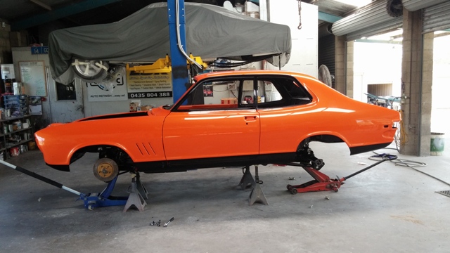

Fitted a borg warner to my LC. It has 3.5 gearing, 28 spline billet axles and a harrop/eaton trutrac.

I love that new shock mounting position 76 and Anthony,
I had mine butted up on the original mount, I will do that one now too. Dave I
nice Torana Ryan

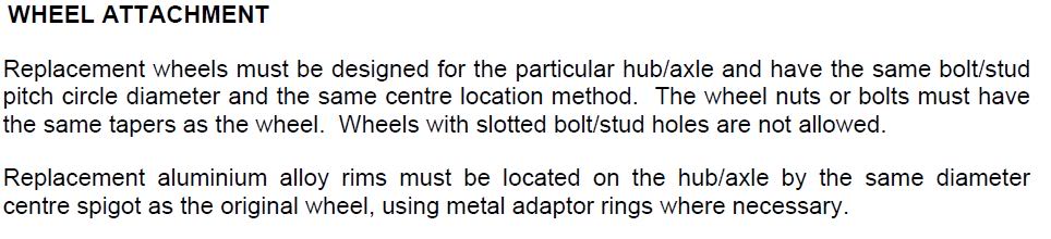

just got a r31 diff made to fit a UC torana.
 the hub on the end of the axle flanges is smaller than the hole in my wheels. isnt this what holds the load of the wheels.
should i need to get a sleeve machined up that is interference fit over skyline hub with an O.D to suit my commodore wheels.
also in Victoria you cannot have redrilled axle flanges or discs. will not pass an engineers.
vic roads has a paragraph about it in its modification guide on there web site also.
#262 dattoman
Posted 20 October 2014 - 07:41 PM
Not sure how that works when you have manufacturers like DBA who make discs with 2 different stud patterns , and wheel makers who have multi patterns
And yes get hubcentric spacers for the wheels
The hub is not load bearing. The sole purpose of the hub is to help align the wheel to the axle before the wheel nuts are tightened. Once the wheel nuts are tightened there will be a visible gap between the centre of the rim and the axle hub.
If the hub was load bearing then it would have a taper or the wheel would need to be pressed onto the axle. The majority of hub centric adaptors are made of plastic which is obviously not suitable for load bearing. It is interesting however that the NCOP specifies metal. You should be able to buy plastic adaptors to suit you rims from a tyre shop.
Extract from page 15 of the NCOP11_Section_LS_Suspension_and_steering_3Feb2006.pdf
Tyre Bible
HUB CENTRIC
Definition: A wheel that is centered or located on the hub by a machined center hole-as opposed to "lug centered" wheels that are located by the position of the lug nuts alone.
Edited by ls2lxhatch, 21 October 2014 - 01:16 AM.
ok thanks, ill stop worrying about it.
