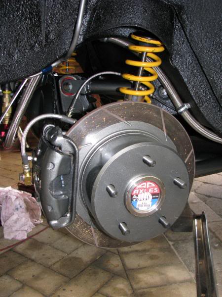

Can someone enlighten me regarding how necessary moving the shock mount is? Is it to fit big tyres or just to clear certain brake assemblies?
What brakes assemblies are a drama? I don't have any brakes, wheels or tyres so I can't see where anything belongs right now haha. I'm gonna go 1" shorter in diff length only, but with a full floater end and unknown brakes... no idea what clearance issues I'm going to find.
#282 dattoman
Posted 07 June 2016 - 01:49 AM
Shortening the diff will cause issues with the brakes
Calipers foul on the shock
You will need to locate the caliper to the front or move the shock
#283 76lxhatch
Posted 07 June 2016 - 07:17 AM
The R31 calipers don't foul on the shock (standard diff width) but you have to remove the caliper to get the shock on and off which is a pain in the neck. It also looks to me that the shock is more upright and fits the upper mount straighter after moving it in a little.
The big advantage though is that moving the lower mount up means you run HQ length shocks, more options (e.g. easy to find Bilstein etc).
#284 Heath
Posted 07 June 2016 - 08:14 AM
I consider that to be an advantage, but I consider the fact that I've gone out and bought McDonald Bros mounts that have an integral shock mount a disadvantage.

Mcdonald Bros cut my shock mount and relocated it using there bracketry.

My diff is at the shop getting the mounts changed at the moment. Are the skyine sway bar mounts of any use for mounting one in a lh?

#290 76lxhatch
Posted 08 June 2016 - 06:34 PM
You can see in the photo that ls2lxhatch posted above of mine that I used the sway bar mounts on the diff housing, and the end links go through the upper arm mounts just in front of the arm pivot
Its just a Commodore bar with the ends straightened out, can get various sizes up to 18mm from factory cars for next to nothing.
#291 ls2lxhatch
Posted 08 June 2016 - 06:51 PM
The mounts look like they might be in the right spot for the UC style swaybar available from K-MAX and Whiteline.
This is the K-MAC UC style on my hatch.

Thanks for the info. Does anybody have a pic of where the swaybar mounts to the body?

#294 76lxhatch
Posted 09 June 2016 - 07:36 AM
All I had to do was make a hole in the upper arm mount
(please ignore the mess, I've just fixed a leak through the diff pinion spline)

#296 ls2lxhatch
Posted 09 June 2016 - 12:20 PM
Whiteline BHR37 swaybar
K-MAC TRC1
More pictures here
http://ls2lxhatch.com/suspension.htm
