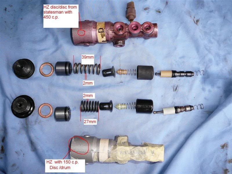

Anyone know if the O ring on the big nut in the proportioning valve is still available as a part?..Mine fell apart when I was washing it.
#52 _rorym_
Posted 27 January 2009 - 04:17 PM
Better still...Found out a Statesman disc/disc arrangement has a prop valve with a rear 450cp....Guys..Just find and fit the statesman one?...Yes??..Local wreckers has 4 of them there..
Edited by rorym, 27 January 2009 - 04:19 PM.
#53 76lxhatch
Posted 27 January 2009 - 04:45 PM
Actually I knew that but didn't offer it as a suggestion because they are bloody hard to get hold of... ha! Any HZ with rear discs will be good, didn't realise the only difference is the spring...?
Did you try it disabled to see how it went first?
#54 _rorym_
Posted 27 January 2009 - 07:20 PM
Not yet but if it has a 450cp it will have to be close.

Hey Rorym,
Did you find any of the those Statesman anodised 450cp Prop valves at the wreckers?
This is speculation but you might be able to find them on V8 wagons with 4WDisc too I suspect.
If so I would be interested to see if the spring is the same as the picture as when I dismantled it the prop valve it seemed slightly skewed,
possibly suggesting it was tampered.
BTW: That photo of the dismantled prop valves is one I took a while back when when fixing a mates Statesman SLE brakes.
Had to unseize the prop valve. :)
