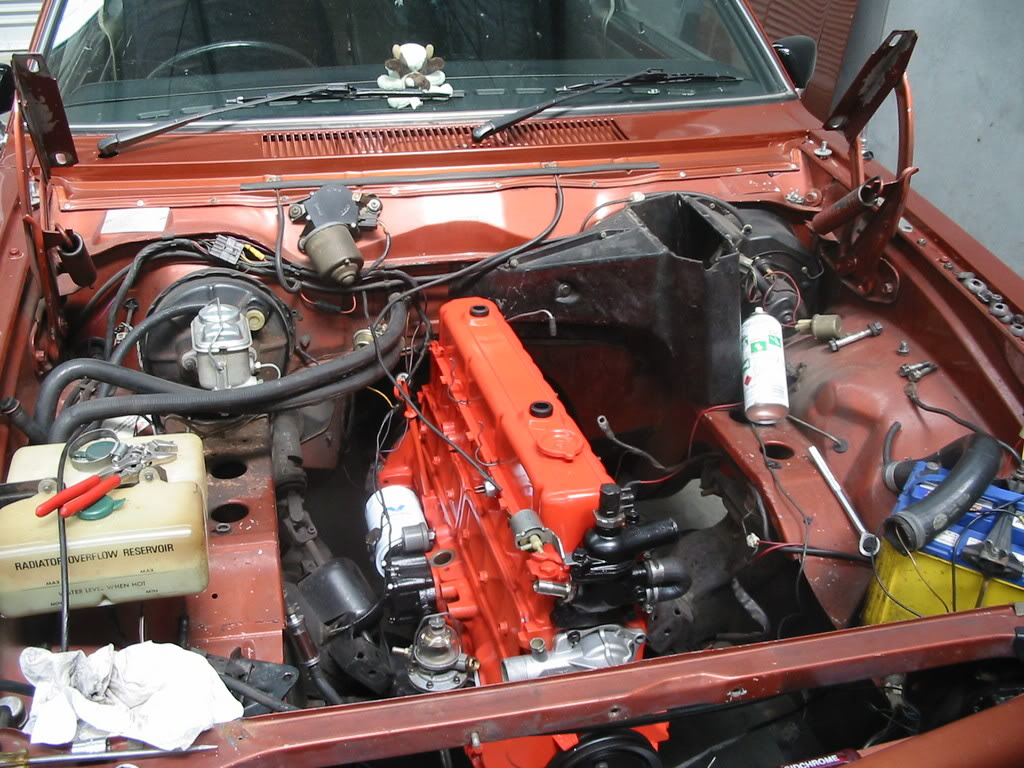

Posted 02 May 2009 - 10:30 PM
Hi Guys,
I've taken some pictures and i think I know the issue.
Looking for advice on how to proceed.

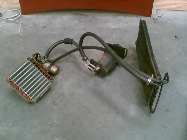

IN Yellow is what i ASSUME is the water pump out for the heater? - This has not been drilled. - I assume i drill it out and then connect it directly to the firewall?
Here is the boy so you can see how the tubes run from beneath the thermo - one goes to the mani the other goes directly to the firewall.
This is where I am concern, if I put the on from the water pump onto the firewall..where do I put the one that is currently there?
Above is a picture to what I was told is the AC unit, if you follow the tubing back it leads to some form of compressed gas canister. Is this the AC? - Is it possible to run AC and HEAT at the same time?
#33 _Courage_
_Courage_
Posted 02 May 2009 - 10:35 PM
^ Take it that this is NOT factory air?
#34 rodomo
Posted 02 May 2009 - 11:07 PM
I have added arrows to one of your pics.
These are your heater hoses and they appear to be connected correctly from what I can see.
DON'T drill your water pump.
Edited by rodomo, 02 May 2009 - 11:08 PM.
#35 _Courage_
_Courage_
Posted 02 May 2009 - 11:20 PM
Thanks Rob, I guess that's one less thing then.
I flushed the heater core today and there was no gunk, hose flushed it easily with no issue.
Soooo if my understanding is correct the heater core takes in the hot liquid that passes through the ran and manifold then onto the firewall, pass through the heat core (heating it up) and then the fan blows over this pushing the heat out with it - just like a Rad really.
BTW whats the reason for liquid being run through the manifold? - I make that presumption basned on where the tubes lead)
So with this reseach being done... the Fan does work (will investigate rust when i have time) is it looking more likely that the thermo is stuck open? Id if the water pump was dead surely the car would over heat quickly.
This throws up an interesting question, i've never seen my temp light come on ... ever. Should i come on when i turn my car on like my Oil does?
#36 rodomo
Posted 02 May 2009 - 11:30 PM
The water runs through the manifold to help vapourise the fuel.
Your temp light should come only while the engine is being cranked but not actually running. Kinda like a test to ensure the globe works in the dash.
Run the engine to operating temp. Feel the hose from the manifold where it enters the firewall.
It should be hot like the top radiator hose.
If it isn't, you have a blockage, probably the heater core.
Edited by rodomo, 02 May 2009 - 11:33 PM.

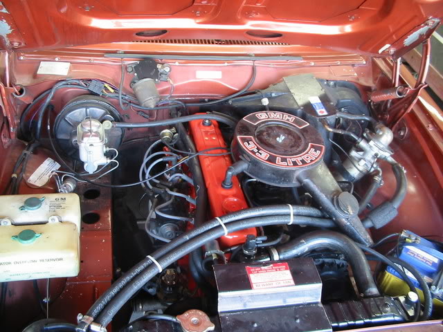

#42 LX2DR
LX2DR
  • 1,763 posts
  • Joined: 21-November 05
Posted 03 May 2009 - 12:51 AM
^^ Definately not factory AC compressor^^
This is the complete factory system out of the car with AC Delco compessor and VIR system (Valves In Reciever)
Also your engine bay should look like this when assembled.
And for clarity the heater fan duct should look like this (large black box in the back left hand corner)

#44 _Courage_
_Courage_
Posted 03 May 2009 - 01:15 AM
Rob - yeah when i crank it, it doesn't come on (thats what i meant by accessories sorry to confuse). - Maybe we are getting off the point a little though?
I have proven that water flows through all the hoses with good preasure. Its almost like its missing a heat transfer into the water thats in hoses beneath the thermo. I know I'm a newb to this but I can't figure out why the water isn't heating up when it hits the heater core. (i temp tested that water and its luke warm whilst the rad water would take your face off)
Paul thanks for the pictures mate, got a feeling yours might be an LX as i am not familuar with your set up.. both of yours have a straight run from your heater to the water pump, on of mine passes through the manifold on the other side then to the heater..
As the AC isn;t factory its probably of little value to anyone so I might tear it out now (looks shit) and see if i can identify what it came out of. ATM i only care about the heater
Edited by Courage, 03 May 2009 - 01:15 AM.
#45 LX2DR
LX2DR
  • 1,763 posts
Posted 03 May 2009 - 01:19 AM
Yes knew the difference, water heated manifold vs my exhaust heated.
But the AC should be same same if it was factory.
Edited by LX2DR, 03 May 2009 - 01:27 AM.
