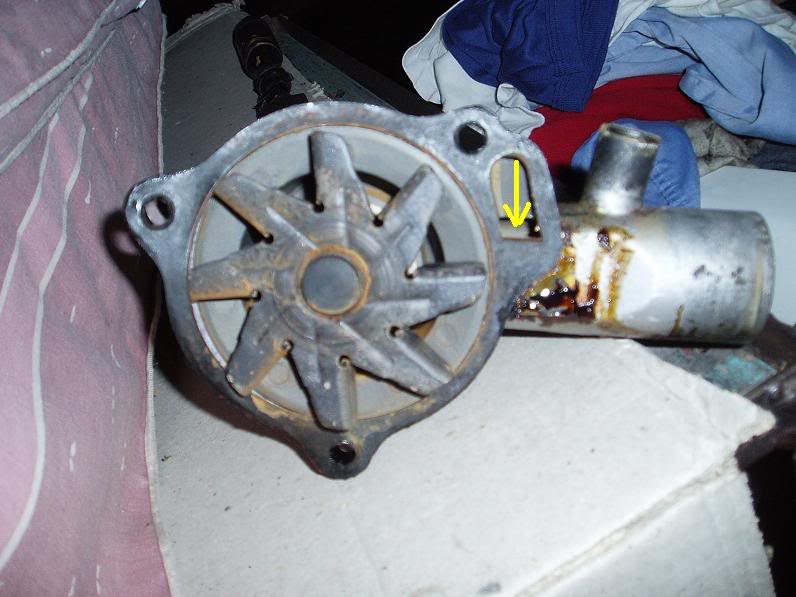

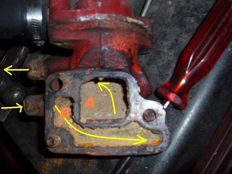

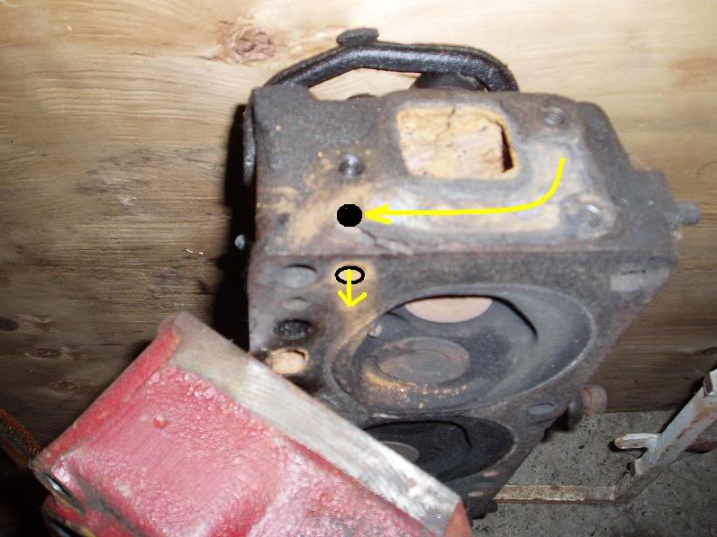

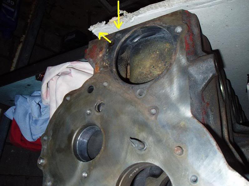

#58 rodomo
Posted 03 May 2009 - 09:00 PM
The water is drawn out of cavity "A"
Travels through the inlet manifold, then the heater core and enters cavity "B"
(A+B are not connected to each other)
Then it flows through the hole on the front of the head, through an internal elbow that is not connected to any water jacket, and into the block.
Then, through another internal elbow in the block, also not connected to any water jacket.
And ends up being drawn into your water pump via A HOLE THAT IS ALREADY THERE!!!!
Edited by rodomo, 03 May 2009 - 09:04 PM.

Posted 03 May 2009 - 09:06 PM
These holes and cavities can block up over time, as can your heater core.
