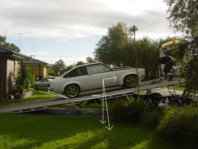

the thing that shits me most about this,is the fact it goes up on a tilt tray no problem.
im willing to bet no ones tank makes it inside that angle.

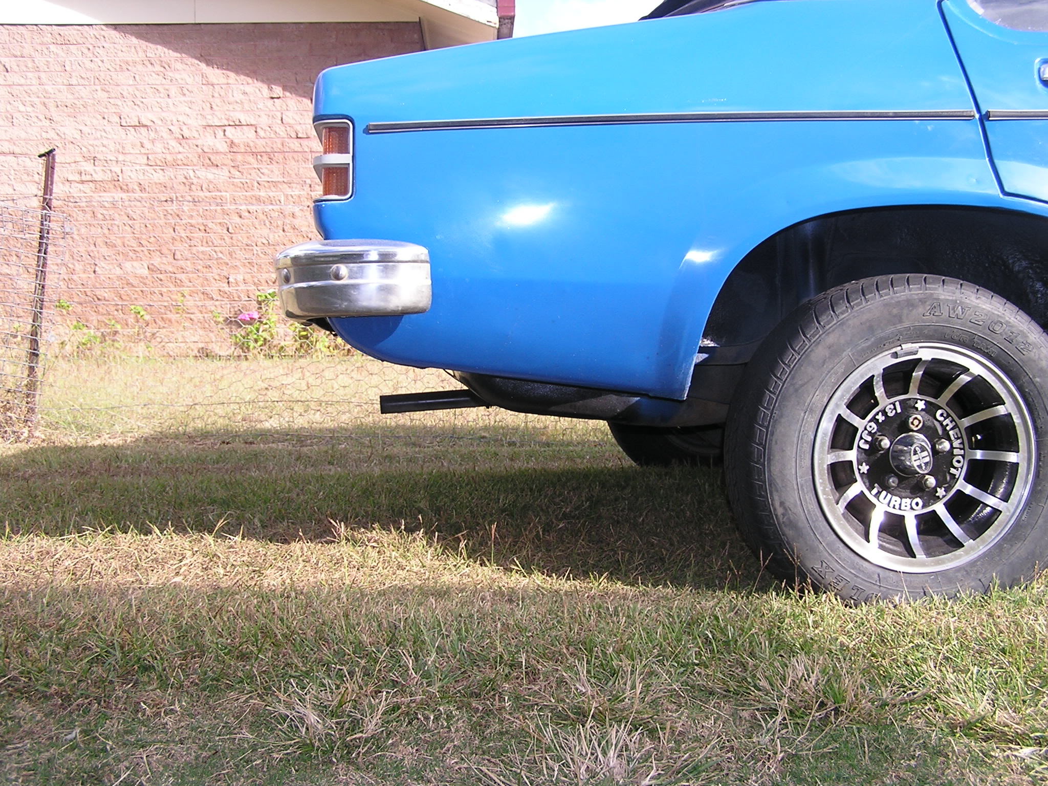

The standard tank fits easily within the departure angle, I have many old grainy photos but this one gives you some idea
Attached File  standard_tank.jpg   57K   105 downloads

Just done some simple and very rough calcs. As it is, its only about 7 degrees out but it would need to be raised by 3.4 inches. Only drama is that as the car goes higher so does the rear bodywork.
Diagram;
Tom

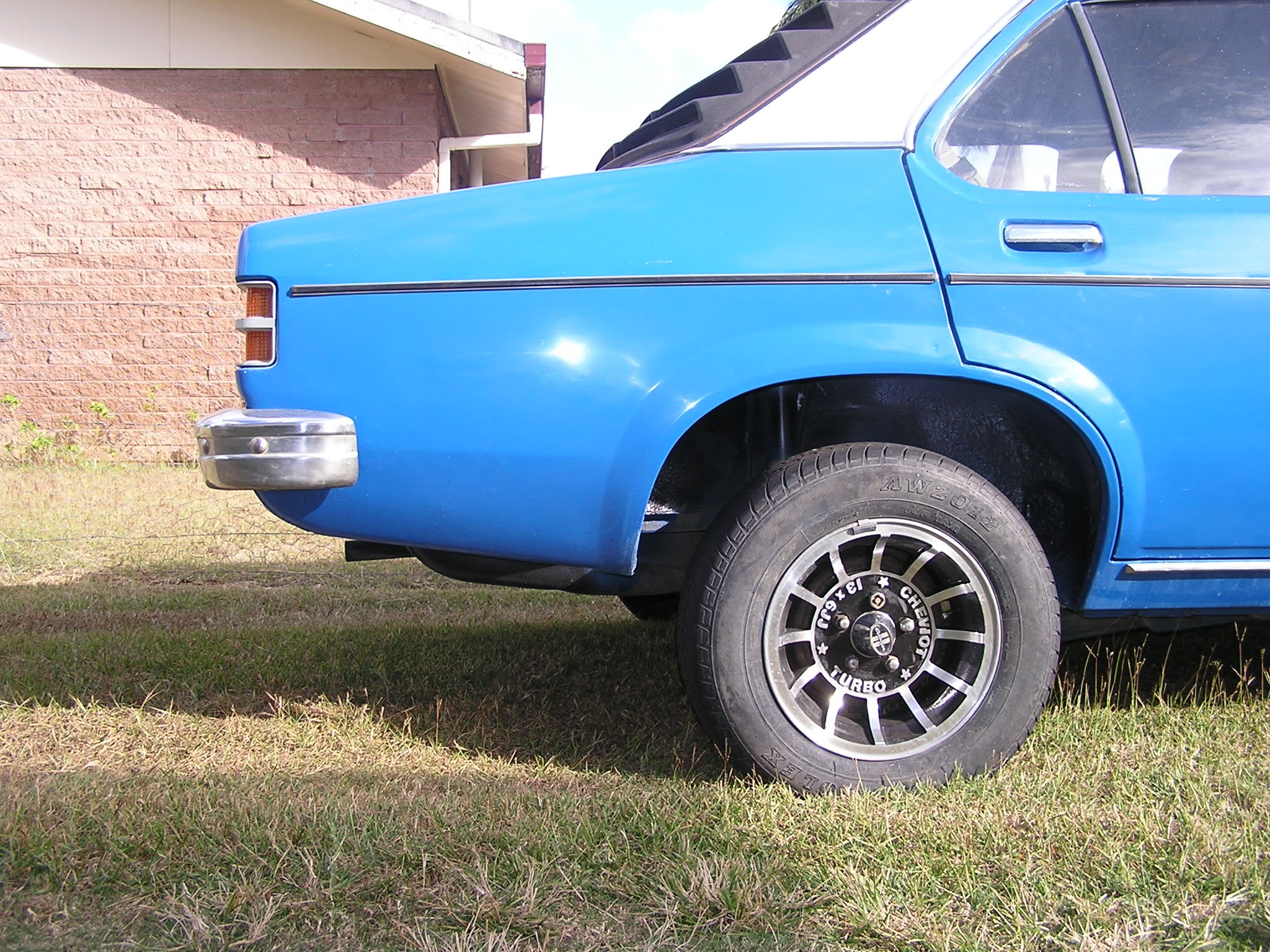

Are these picks usefull???
Standard rear springs, standard tank.

Bomber, thanks for posting the picture. Unfortunately is shows that the standard tank is within the departure angle.
I will talk to my engineer tomorrow however as far as I can see there is no wiggle room in the NCOP which is used in WA.
The engineer is required to answer each item on checklist LM1. Question 1.7 on page 10 asks if the tank is within the departure angle.
#25 _HRV74_

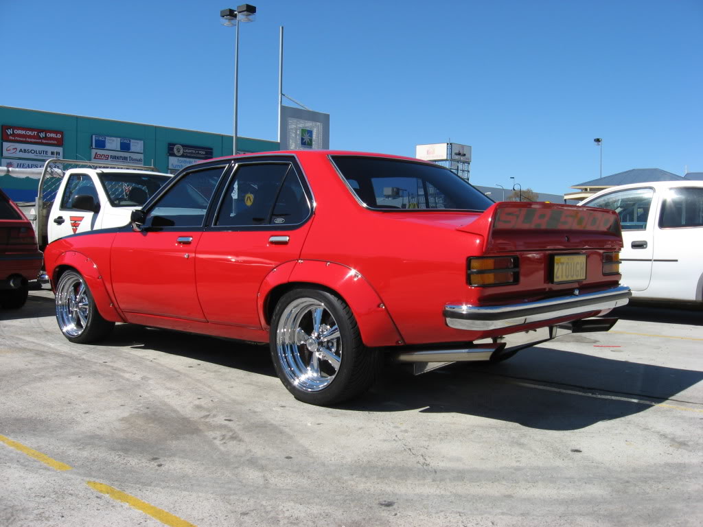

Posted 06 June 2009 - 03:57 PM
I'm not surprised at this.
A few years ago (before i owned it) my car scored a new custom made fuel tank for this very reason. It's 100 litres, custom made by Performance Metalcraft.
The engineer would not pass the old tank. The current one is said to fall within the departure angle, and is certified in NSW.
