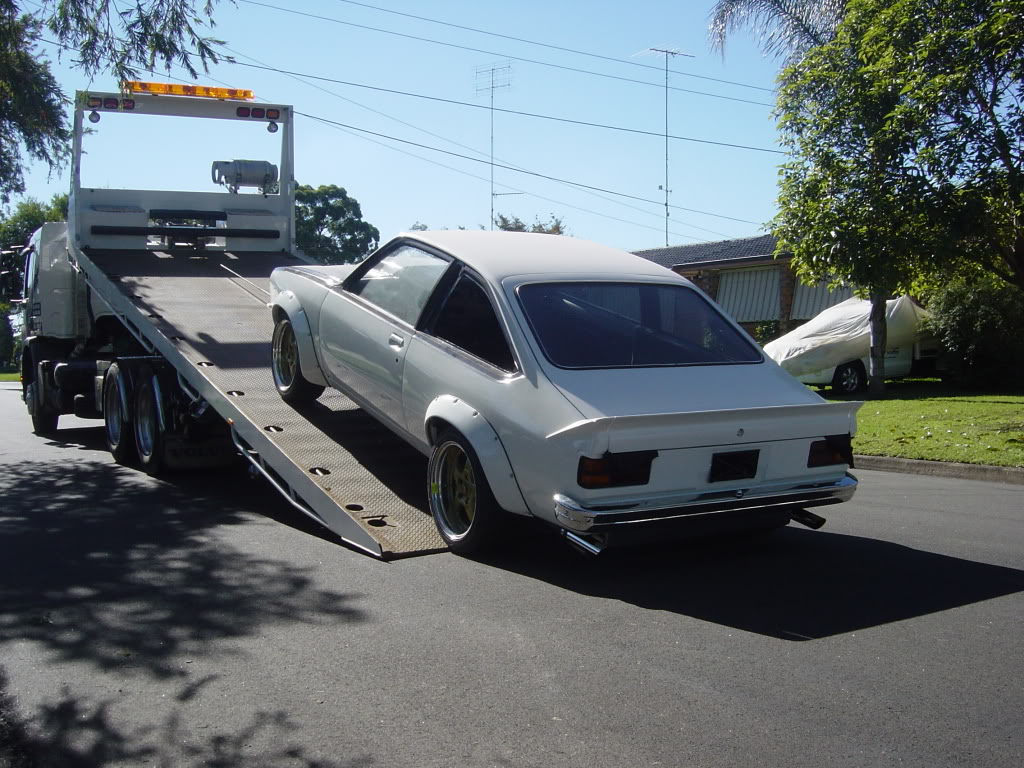

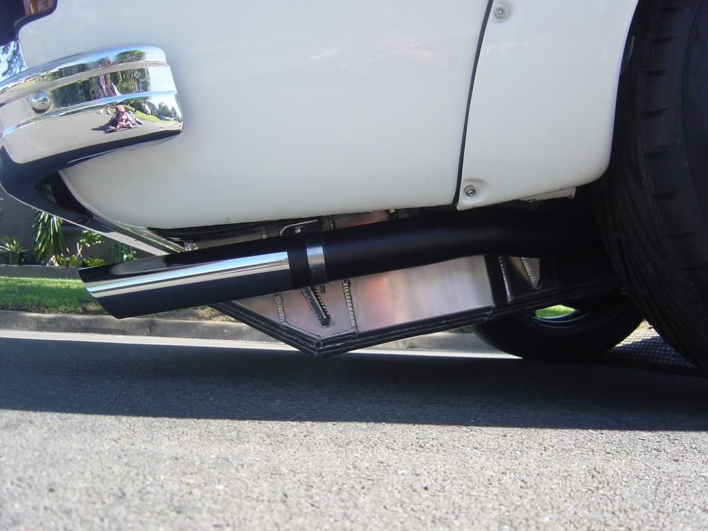

Harve, I don't think your tank would make it if measured the same way as the engineer who inspected ass308's car.
Your tank has a sharper departure angle and would be much closer to legal if not legal already (which it must be as your engineer said it is).
It gets back to engineers and their interpretation of the rules.....
Mick.

just to add fuel to the fire.i told the tilt tray driver of my woes.he cranked the tilt tray right up.this the clearence.bloody heaps of room !!!!!!!

PS. Photos like those above (showing the tilt tray, and ground clearance etc).. could come in handy if you can manage to 'negotiate' at all with the engineer. Prove to him behind doubt that the car is practical and useable, and not dangerous etc..

To be legal the tank has to fit inside the top of the tube in this photo not the bottom.
You can not get the Brown Davis tank within the departure angle by raising it as it already touches the boot floor.
I was ready for the top to be welded onto my tank which is similar to the Brown Davis design. My tank is an integral part of the LS2 EFI fuel system and therefore will be subject to engineering. I do not see any other option than to redesign the back half to fit within the departure angle.
I suspect that once the drop tank is modified to fit within the departure angle it will look odd compared to the Brown Davis design. You could make a cover in the Brown Davis shape that fits over the legal drop tank design. As the cover is not a fuel tank it would not be subject to departure angle rules.

ls2lxhatch,theres not really much to come off the tank.if u cut along the bottom of the tube,u would loose 50mm along the bottom,maybee10-15mm off the front verticle edge.to form the new angle.
do u think it would look that bad ?

he does not like the depature angle.everything below the tube shouldnt be there
He is correct in saying that, sorry.
Departure angle goes from bottom dead centre of the tyre to the bottom of the rear most part of the body.
Again....it all comes down to 'interpretation'.
If that ruling was staunch, then nobody in the country would have a droptank certified.
Think of the ramifications......BD; or every other tank manufacturer; wouldn't be able to sell their products for road use, insurance companies would be denying claims due to illegal modifications, defect notices would be handed out to existing droptank users, no torana would ever cross the nullabour under their own steam unless they had a trailer full of fuel, engineers who signed off on droptank fitment could be prosecuted.....ect ect.
My 120L droptank was built by the consulting engineer.
It doesn't look any different than any other droptank. Departure angles are the same.
So what does my engineer know that yours doesnt?

LHoon,when your tank scraped,did u have as much clearence,as i do.could your car go up a tilt tray like that ?
#42 _ass308_
_ass308_
Posted 07 June 2009 - 09:42 AM
bugger just thought of another thing.
theres no way my car could go up the tilt tray like that with front spoiler on.
because the front spolier sticks outside the front departure angle.surely i would take my front spolier out before the droptank,whilst going up inclines.
this has to limit what i can do with the car more than the tank ?
