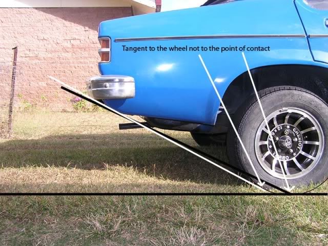

If you refer to this diagram above from yella_slur, it has tangent to wheel which is not the contact patch of the ground to the wheel. Also says that some engineers take the exhaust as permanant body.
The tangent to wheel means the bottom photo from ls2lxhatch is wrong.

The picture looks different to the diagram because the beaver panel on the Torana is significantly higher than the beaver panel in the diagram.
I expect most engineers would measure by placing a straight edge at the base of the tyre and raising it up to the body work as in ass308's photo.

I had to guess where the bottom of the wheel was in the grass, I looks pretty close to me (see black circle added).
Sorry mate but thats what i mean. its not the bottom of the wheel becase a line tangent to the bottom of the wheel is horizontal. Its not the contact patch that is the reference. ill draw a diagram

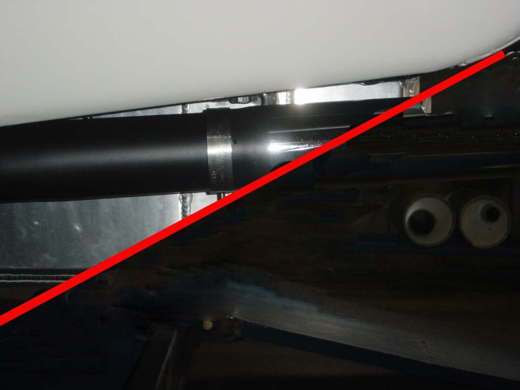

In mowie's diagram is states that the exhaust may count as body work. If this is the case then the Brown Davis tank would be legal on ass308.

Thats a diagram that is in wiki, put there by YellaSlur. That is what i am basing everything from

Even the diagram leaves it open to interpretation due to the height of the beaver panel. The line touches the tyre above the ground and also intersects the contact point. The diagram contains a vertical and horizontal lines through the tyre which would be irrelevant is the contact point is not significant.
In my opinion the tangent you mentioned makes the most sense as it represents the angle you get if you were to raise the car to the point where the beaver panel touched the ground.
I am going to check with an engineer tomorrow whether on not the exhaust can be considered body work under the NCOP. The diagram you posted mentions this may be possible.

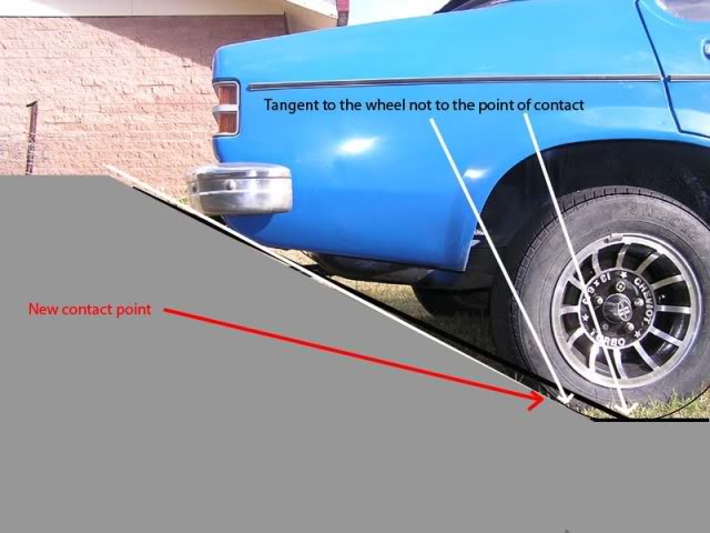

When a car is rolling down a driveway and comes into contact with the road. This is then a new contact point which the furtherest contact point you could achieve is when a tangent line is drawn between the outside of the wheel and the beaver panel. shown here;
I know it might not make much sense but imagine the grey area is your cement driveway. The car will not continue moving beckward once it touches the inclination, it makes a new contact point then starts to move the car along that plane.
We must have been typing at the same time.
This is how i would interpret it.

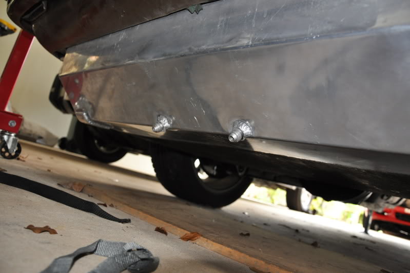

I would say you would have a very hard time, yours looks very lower indeed and whatever connects onto those two outlet s is going to be extremely vunerable to damage, sorry do be a downer on what is also otherwise a very fine build. Ignoring ramp angle argurement for a moment those to outlets realy would worry me even if they were legal I am not a fan of things hanging down in harms way, is there anyway you can move them? Again sorry for negativity

It would be incredibly easy for someone to come and steal 120 litres of fuel from you. Why were they not mounted on the forward face where the normal pickup ect is? Very dangerous
