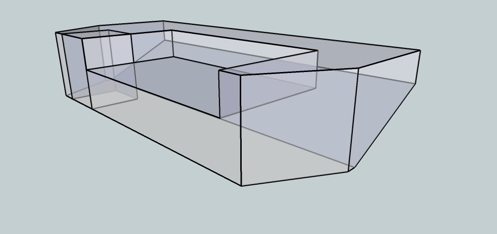

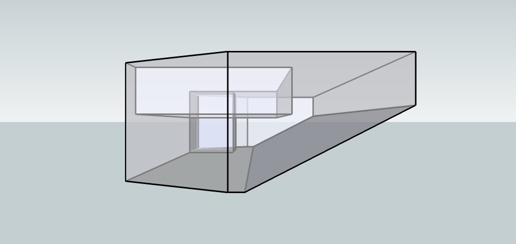

#108 ls2lxhatch
Posted 09 June 2009 - 10:08 PM
To avoid hassles in the future I will be building another tank that complies with the departure angle. The design I am working on contains a surge tank, a recess for the fuel pumps and does not extend all the way to the beaver panel. Unfortunately according to my calculations the tank will only hold around 60 litres, I would have preferred 80+.

#111 ls2lxhatch
Posted 10 June 2009 - 02:02 AM
The drawing is done in google sketchup 7 which you can download for free. Once you have sketchup you can load the drawing and check measurements. I will post up the drawing on Thursday.
I plan to make a mock up tank using 3 mm MDF. Once that is finished you can come and have a look if you are not too far from Willetton.

Ls2lxhatch
Nice drawings sketchup is the perfect tool for stuff like this, I noticed that you have a rectanglur cutout for the spare tire bulge in the boot floor I think you will find it does not have to be anywhere near that big and be angled up from front of tank toward rear of tank giving you a few more litres of capicity.
good luck with project
#115 _Squarepants_
_Squarepants_
Posted 10 June 2009 - 08:33 PM
I think he mentioned that cut out is for fuel pumps. I could be looking at the wrong cut out though.

#119 ls2lxhatch
Posted 11 June 2009 - 02:09 PM

#123 ls2lxhatch
Posted 11 June 2009 - 06:26 PM
ls2lxhatch, that tank looks dynomite mate! its really turned out nicely. im assuming that everything complies with the departure angle.
The tank in the above pictures is similar to the Brown Davis design and therefore does not fit within the departure angle. I posted the picture to show why the spare tyre cutout is flat in the new tank design.
I will send you a pm when I have finished the mockup tank.
#124 _cruiza_
_cruiza_
Posted 11 June 2009 - 07:19 PM
Ahhhhhhhh I see said the blind man, makes sense thanks for that, nice work
