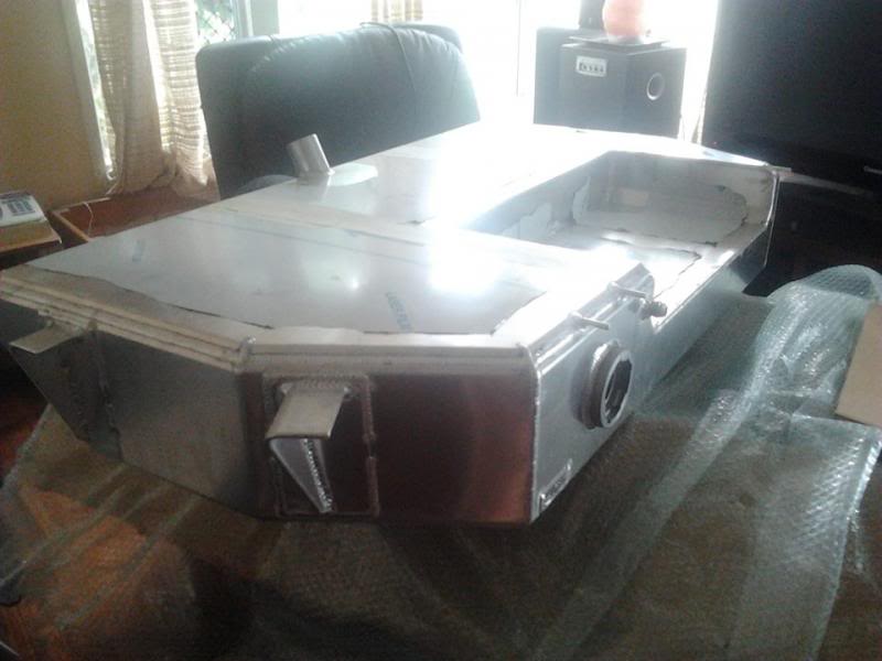

#285 ls2lxhatch
Posted 18 November 2013 - 01:30 PM

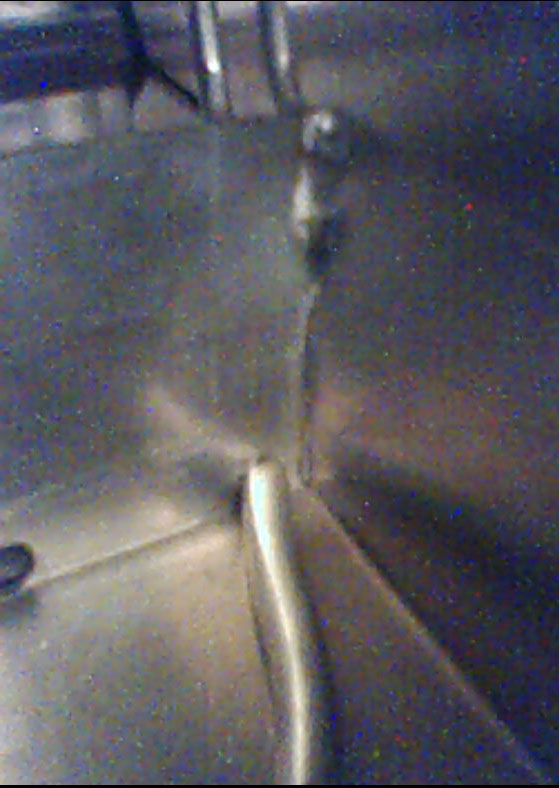

The Brown Davis swirl pot is basically a box around 200mm x 200mm x 50mm with one or two holes in it for the fuel to flow in. There is no provision for a return line back into the swirl pot. It is not suitable for EFI.
This is a photo taken from a video inside the Brown Davis tank.
The swirl pot is ok for a typical mechanical pump carby system where the pump only takes the fuel required to keep the float bowl full and the float bowl gives a little buffer if the pump runs dry.
An EFI fuel pump is always pumping flat out unless you have a pump controller. Any fuel not required by the engine is returned to the fuel tank via the regulator bypass return line. This line is usually plumbed to the surge tank so the surge tank fuel level will only drop when fuel is consumed by the engine. As the Brown Davis swirl pot does not have provision for a return line it will be emptied in seconds by the EFI pump.
If you don't want to run a surge tank and lift pump then you will need to keep the Brown Davis tank around 1/2 full. Even with the tank 1/2 full your pump will probably run dry and pump aerated fuel into the fuel rails under heavy braking.
Another option is to weld a sump with a return line into the Brown Davis tank. The sump will trap enough fuel to handle the fuel requirements during surge. The sump is basically a gravity fed surge tank.
Something like this.
Edited by ls2lxhatch, 18 November 2013 - 01:33 PM.
#286 Statler
Posted 18 November 2013 - 02:11 PM
From BD,
Our standard tank for the Torana is 120lt (smaller tanks can be made as required) and is designed to take the standard pickup/gauge sender assembly, it fills through the standard filler spot & connects to the original venting system to keep it roadworthy. The tanks have no ugly straps under them and bracket into the chassis rails as did all the original race car tanks.
1/2" pick ups & swirl pots can be fitted into the tanks for EFI or big engined cars as we make them using the original pickup as the return if needed.
So if the return is going back into the swirl pot, fuel would have to feed to a hi-flow pump because the lift pump wouldn't be required?
The VN pump has a regulator fitted inline.
#287 ls2lxhatch
Posted 18 November 2013 - 03:30 PM
I fell for the Brown Davis claims that their tank is suitable for EFI and bought a tank.  When it arrived I had a look inside at the "swirl pot" and realised I had wasted my money.
Brown Davis use the factory fuel sender pickup as the return line. The factory fuel sender pickup is nowhere near the swirl pot. If fuel is not returned to the swirl pot it will empty as fast as your EFI pump can pump. Even if the return line was plumbed to the Brown Davis "swirl pot" it is still only marginally suitable for EFI.
The only way a swirl pot will work for EFI is if you keep the fuel level high enough in the tank so the swirl pot is always submerged during acceleration, cornering and braking.

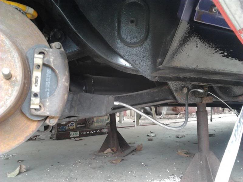

3rd pair of handbrake cables. I can't win!

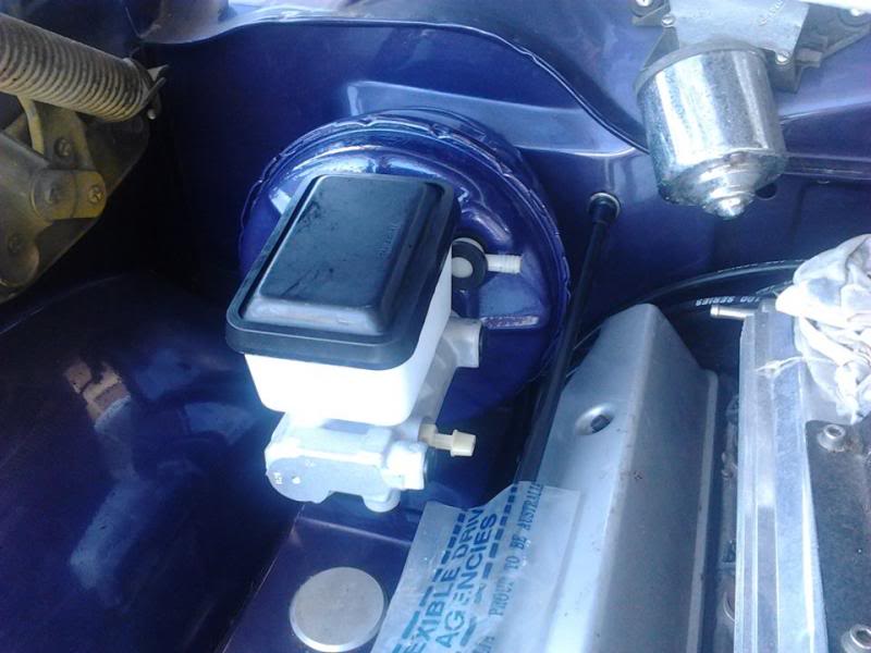

Posted 10 December 2013 - 02:00 PM
After a long search i finally found a Ford XD brake booster. The front cover plate & actuating rod was removed & fitted to the stock Torana booster. The booster also required a full reco.
This allowed me to bolt on the XD master cylinder which has an internal proportioning valve. It also has metric threads so it ISN'T a straight bolt in if anyone is planning to replicate this mod.
I also drilled the hole for the clutch cable before the booster was bolted in for the last time.
Thanks to Datto for his advise (as usual). :)

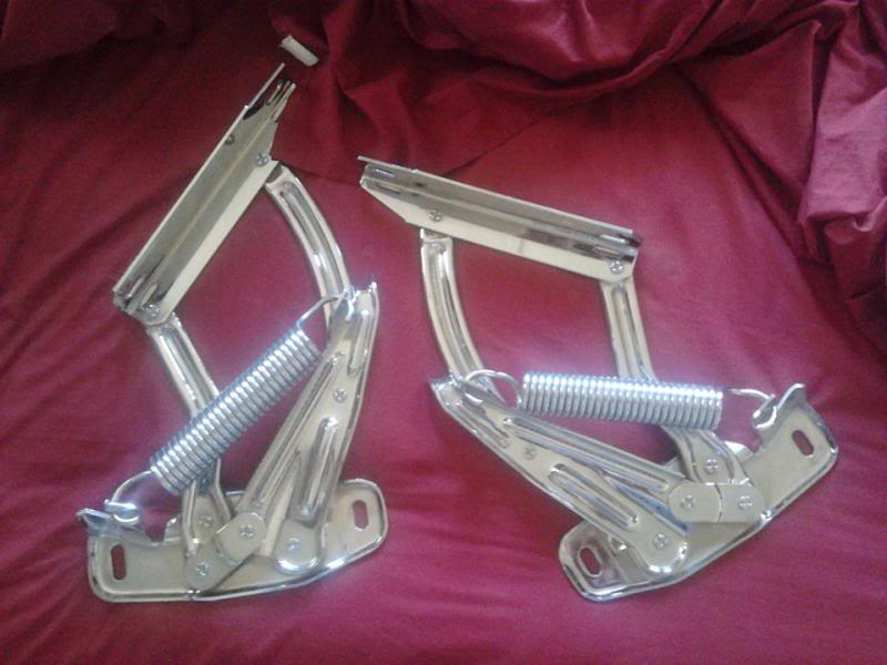

#293 Statler
Posted 25 January 2014 - 07:02 PM
Picked these up today.
I had been avoiding chrome anything.

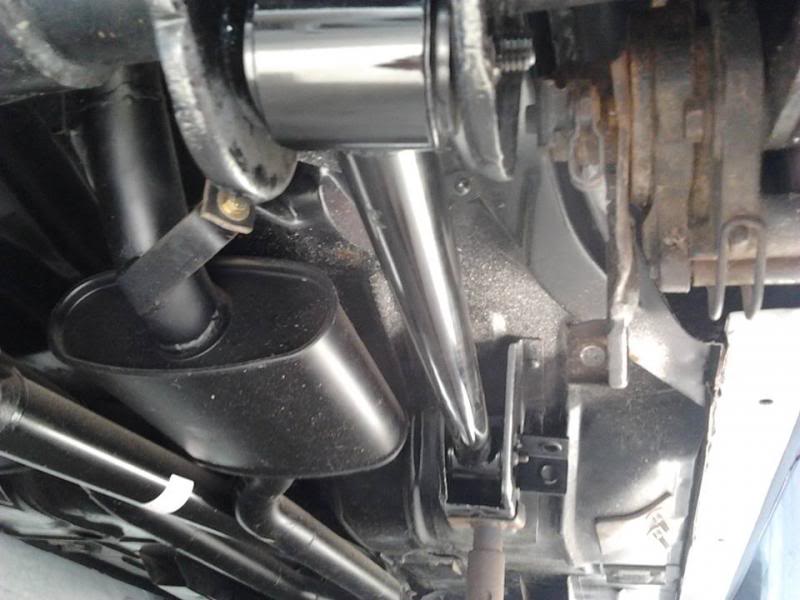

#298 Statler
Posted 06 March 2014 - 01:58 PM
And its in.
Pump arrived Mort. Now waiting on the rest of the fuel system to arrive.
Exhaust tail pipes are going to need modifying.
Looks a little better than the strapped tank. :)
