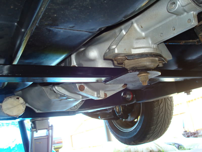

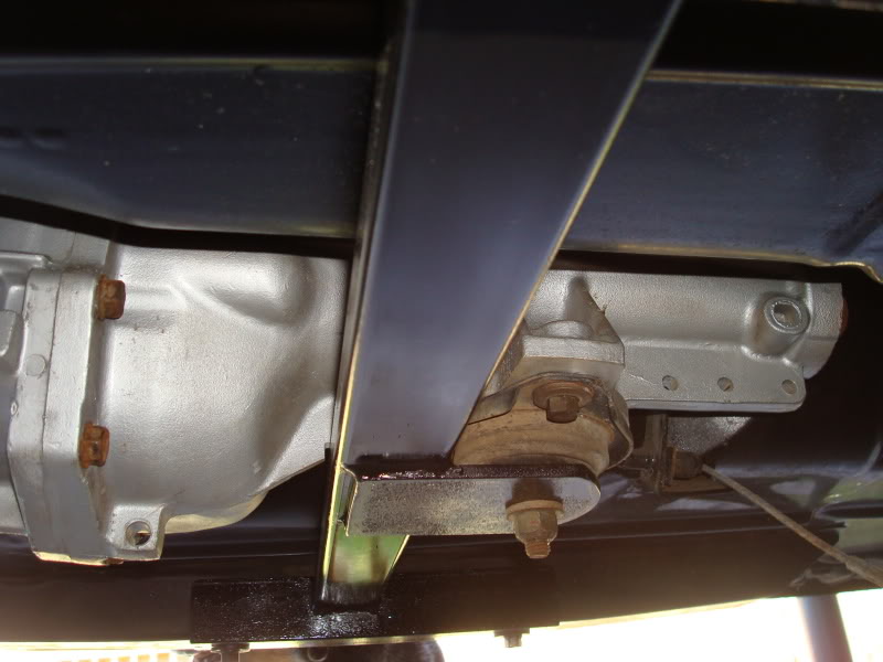

A couple of pics of the x-member.
About 1/2hr work & $25 in steel. If you are doing this, slide the angle sections 'outwards' & tighten the bolts before tacking. That way, when the metal shrinks in the welding process, the bolt holes align again. :)
A small amount needed removed from the cast brace on the box. Simply a small notch with the grinder.
Up & fitted.

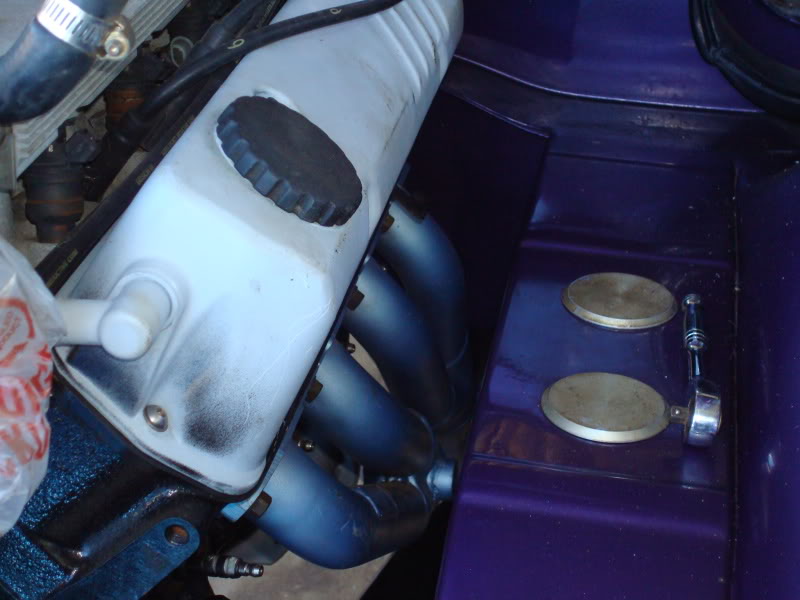

Next on the adjenda....... pipes.

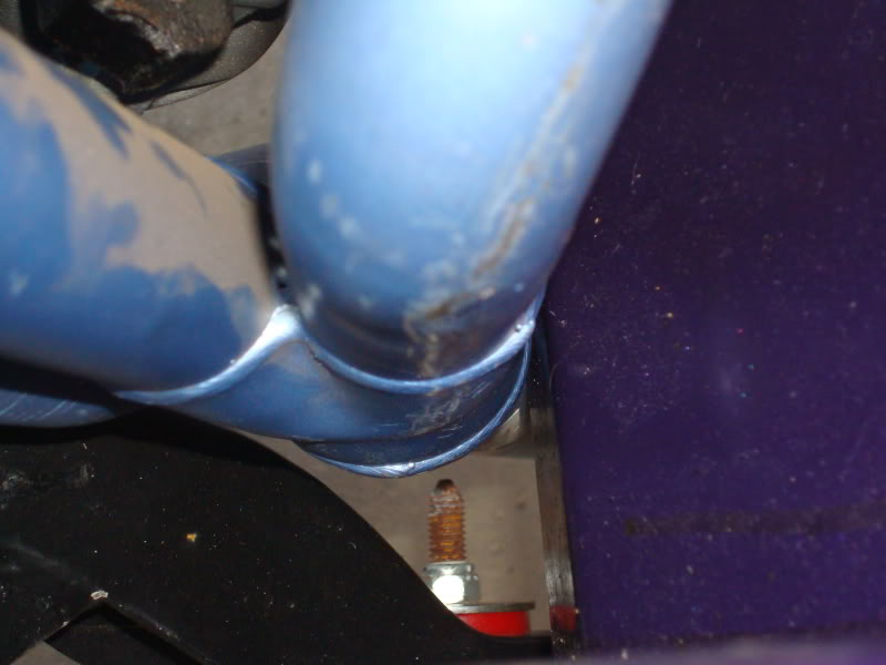

Take 1 fresh set of Pacemakers, a high lift jack, a smashed finger & a whole bunch of swear words..... & end up with this...
Spot the problem?

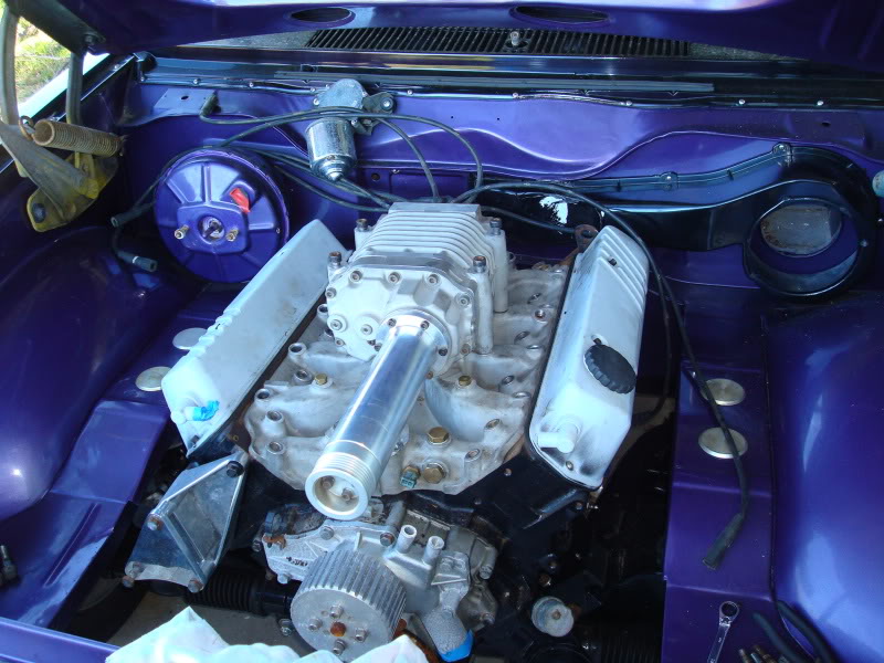

Prepping the new bar for install.
Proof the engine is in.

The pipes are going to need some manual bending to make them right. I figure if the finish is going to be marked, i may as well make them fit right, then get them HPC coated.

The Gilmer has to come off Dj. I can't use it now.
I just sat the airpump on there to check for clearance. More modification required! :banghead:

I'm a big fan of Pacemakers. This is the only set i have ever had that didn't fit out of the box. They aren't that far out, & i can use an oxy. lol

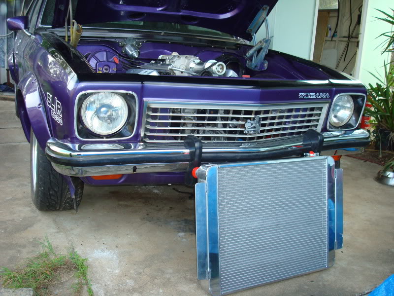

New PWR radiator.
Kinda wishing they had drilled the mounting holes though.
I was just checking for clearance around the crank pulley.

Rad looks nice n spicey!
What fan setup are you gonna run?

I bought the fan set up from PWR as well. It's mounted on the inside.

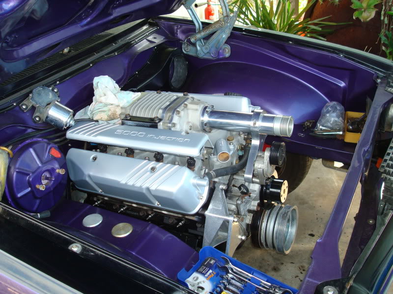

You have to modify the heater box to get clearance on the 304 tappet covers.

Posted 20 November 2012 - 02:11 PM
Remodified, modified heater box.
I finally have enough clearance for the blow off valve. :)
