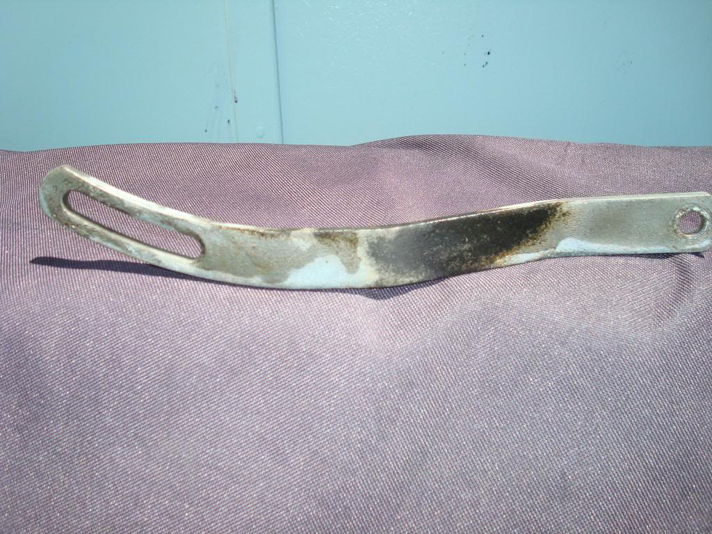

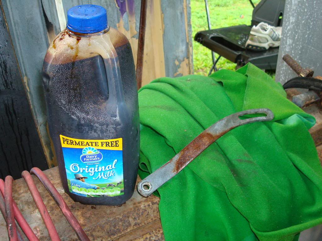

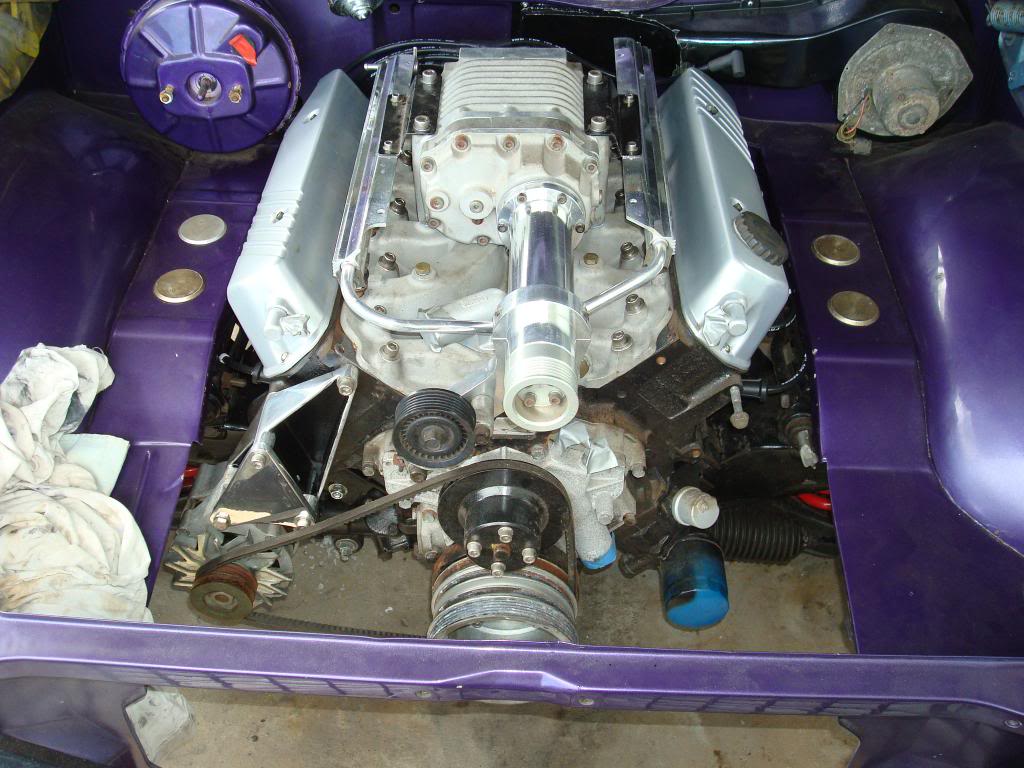

Looks like a custom water pump pulley is on the cards. I have a hot tip on a retired machinist (spin doctor).
I had the long nosed pump on it originally but changed it to the short pump to suit the Gilmer. Do you think i can find the long nosed pump & pulley now? :banghead:
In the meantime, i thought i might investigate the 'healing powers' of molassis.
Take 1 rusty alternator adjusting bracket, drop it in the gunk, & let's see what happens!
How long should i leave it in for? lol

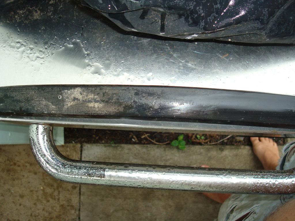

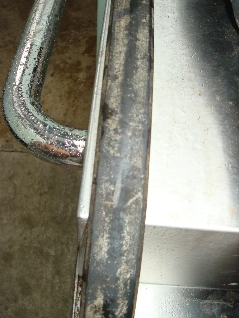

I've had a N.O.S bumper rubber strip forever. The bag had split & somehow it ended up covered in goop! Not normal goop, the kind that really takes a LOT of removing! Dammit!
2hrs of scrubbing with soap & water fixed about 12" of it. Almost a retirement project!
Didn't want to budge! I scored some truckwash from a m8. problem solvered!
Old & new. :)

Hope there is lots of progress now that the damn exhaust caper is sorted. :)
I left my brake, clutch, accelerator pedals in for about 2 weeks and they turned out ok, probably a bit long but i went on holidays so just left them.
What ever you do, don't put springs ( don't mean suspension ones) in the stuff, i put the glovebox hinges and clutch pedal with the springs on them in and the molasses ate them and made them brittle. :angry: :banghead:

AFIK the only difference in early & late water pumps is the bearing size, there is no long/short pump like SBC have. Later Holden V8s had the larger bearing pump because the smaller ones failed from the extra load of PWR steer & A/C. A factory single groove pulley from a HQ-HZ or V8 Torana will ensure your belt tracks properly. The one fitted to your engine in the pic is a VN-VS Commodore one I believe.
#219 _LH SLR 3300_
_LH SLR 3300_
Posted 15 February 2013 - 09:50 PM
I forgot to add that I run a large bearing pump on both my LHs but with HQ-LH V8 pulleys & I've never had issues with belts not tracking correctly. I can post a pic of the correct pulley if it helps.

thanks for the info there Matt, im after a short nose pump so i can run the Gilmer set up one the 304 like they do on the 308's
#221 _LH SLR 3300_
_LH SLR 3300_
Posted 16 February 2013 - 10:51 AM
The main visual difference I've noticed between the small/large bearing pumps is the extra rib that runs down the top of the pump housing to the hub. You can still run a Gilmer on the large bearing pump by grinding this rib down enough for the Gilmer pulley to clear. Personally I don't like Gilmer drives, they put extra load on the water pump & alternator bearings especialy if the belt is excessively tight, causing them to fail. A friend of mine was hospitalised & nearly killed by a Gilmer pulley hitting him in the face when a water pump bearing let go on a 308 Torana he was tuning. He still bears the scars from this. If I were to run a Gilmer on a 308, i'd use the large bearing pump with the clearence modification.
#222 Statler
Posted 16 February 2013 - 11:20 AM
The 308s run a 'short' pump. The 304 pump is indeed longer. I'm not certain without having the 2 infront of me, but i think there is about 30mm difference. The 'long' pump spaced the gilmer pulley too far forward. I think if i can find the 304 w/p pulley i may be alright. Failing that...... i will have a new one made from billet alloy.

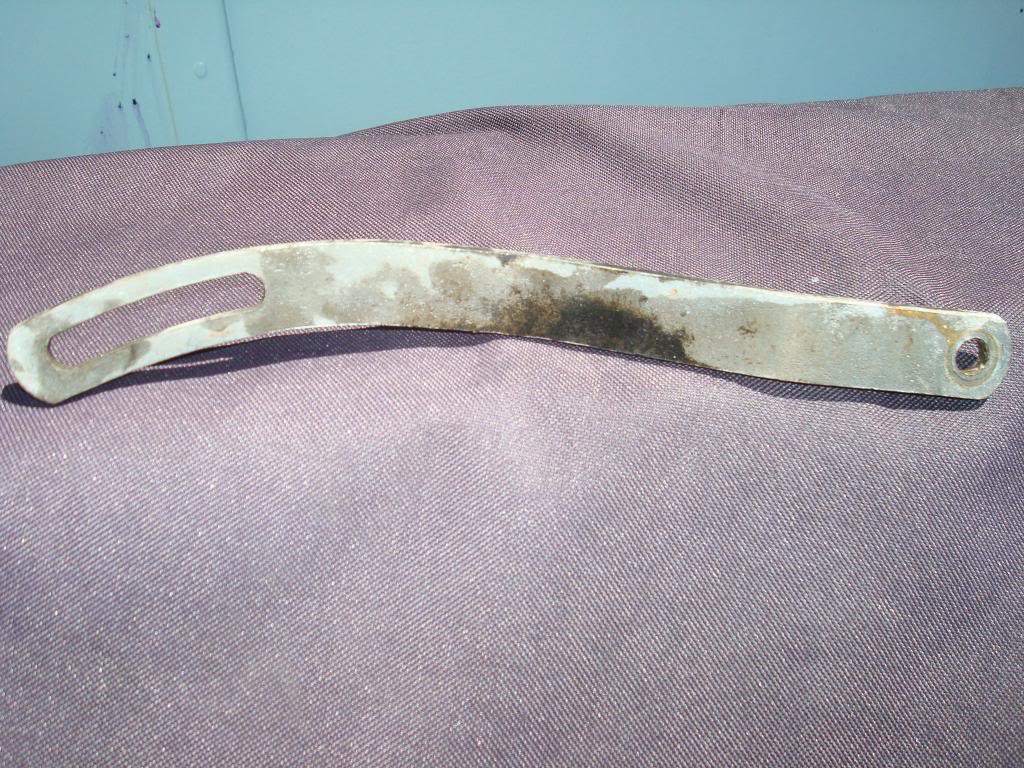

After 1 week in the molassis .
Back in for another week.

Are you supposed to dilute it Col?  Some report it to be 50/50 with water.
#225 Statler
Posted 26 February 2013 - 07:35 AM
Am i? lol.
