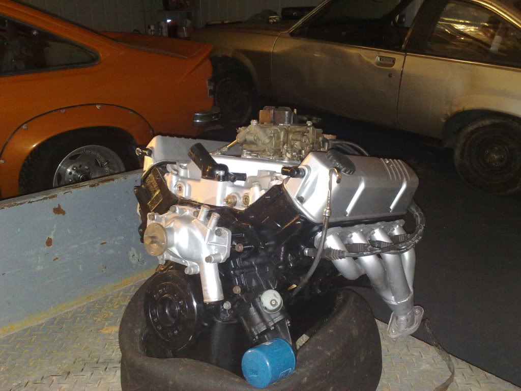

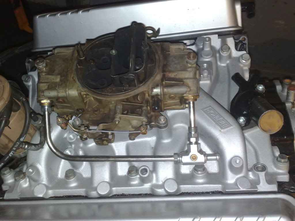

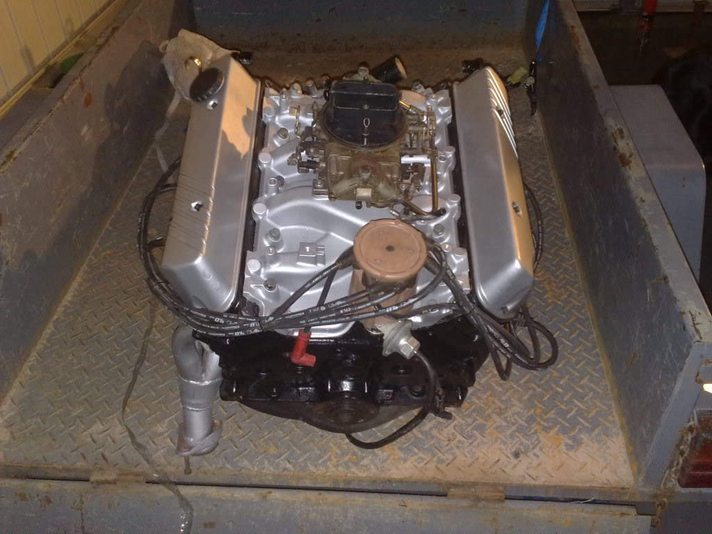

Alright, as promised...
Some Pics

Posted 13 July 2010 - 09:15 AM
Alrighty, so the ones currently on the motor (pictured above) they are 4-into-1's yeah?
I'm thinking Tri-Y's look to be the way to go for me... And if thats what Mumbo is running, it sounds good to me! I aim to eventually get down to his type of times with this motor (Probably not 11.1's though... I'll be stoked with high 11's)
