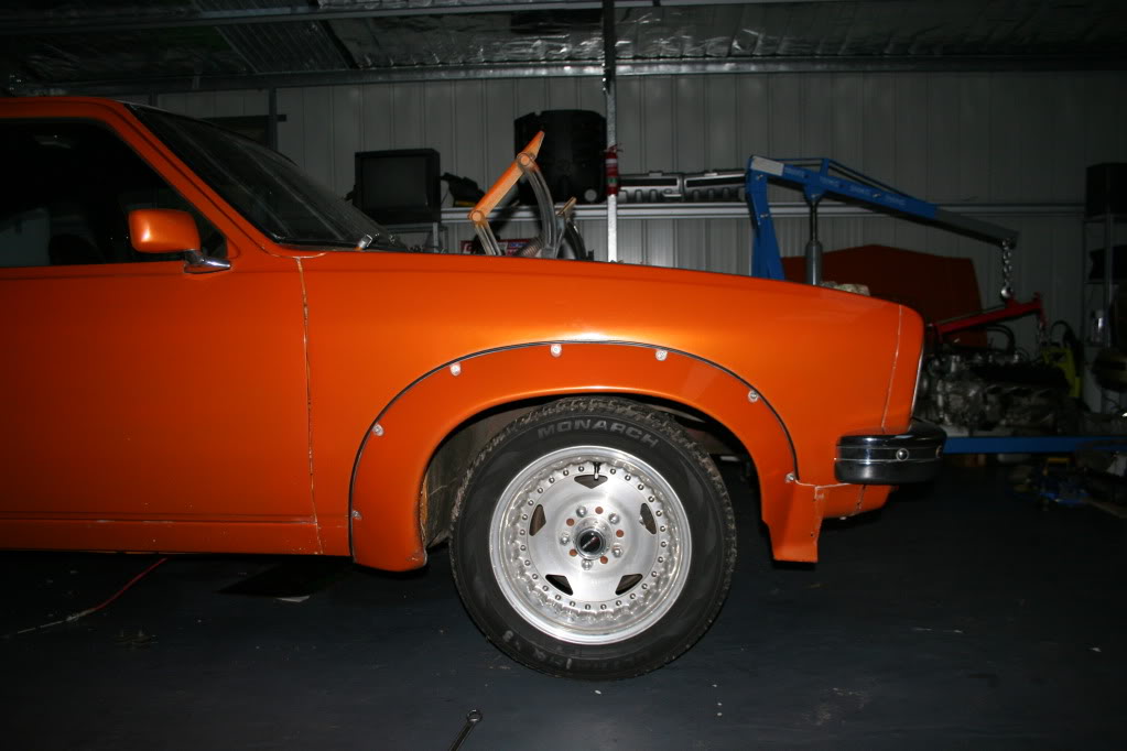

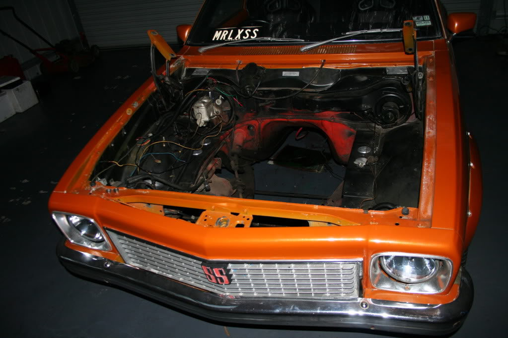

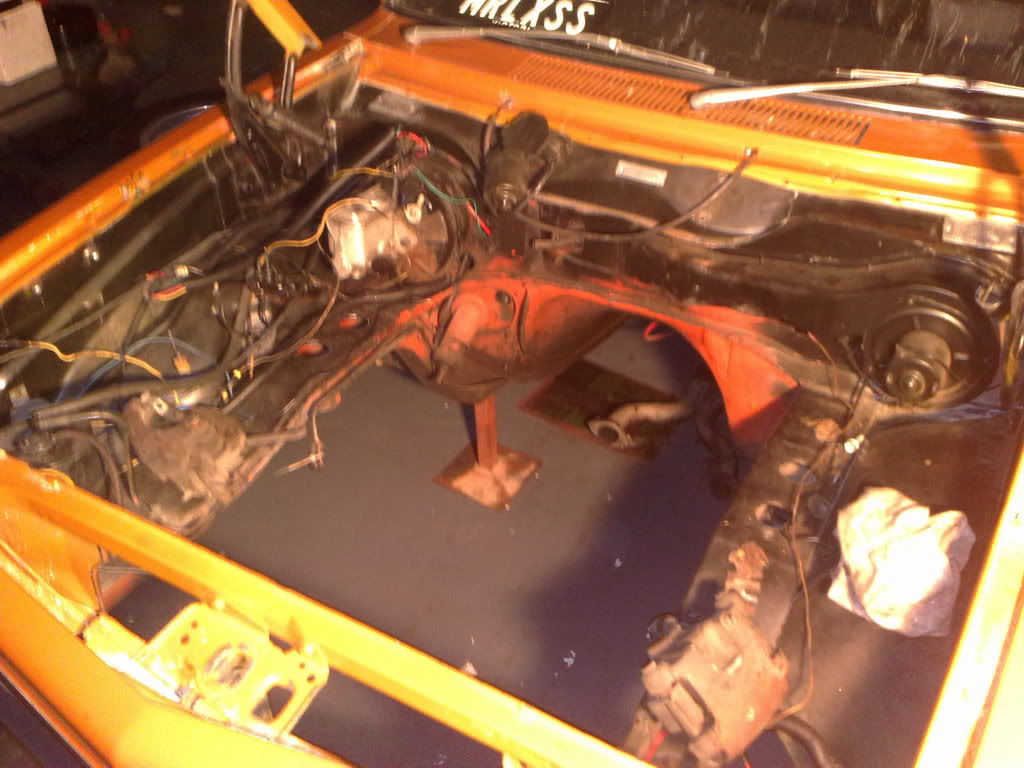

Here are a few pics of the progress!
Excuse the eyesore of an engine bay... That is getting fixed now! No more mismatched colours and messy wiring!
Still lower than a few torrys i see getting around and its got no motor in it!!!

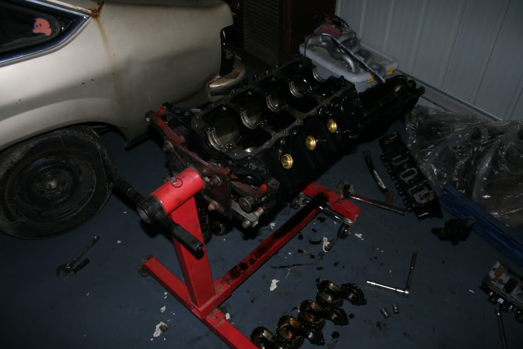

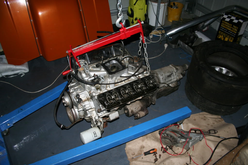

Update with the motor... Just had a Stage 1 Crow cam, standard pistons and rods (But they are A9L rods). Still not sure what the crank is, but is in good nick and is definetely aftermarket of some form....
It's pulled right down now as you can see in the pics, It's going to get a new cam (Still have to suss out what one) Then we tidied up and put back together... I really really want to put in a 355 crank etc in it now, but the funds don't agree. So it'll be a hot 308 for the moment that will have parts that will be interchangable when i go the next step on the 355.
Huge thanks to Ryan for coming over on Sunday and giving me a hand....
