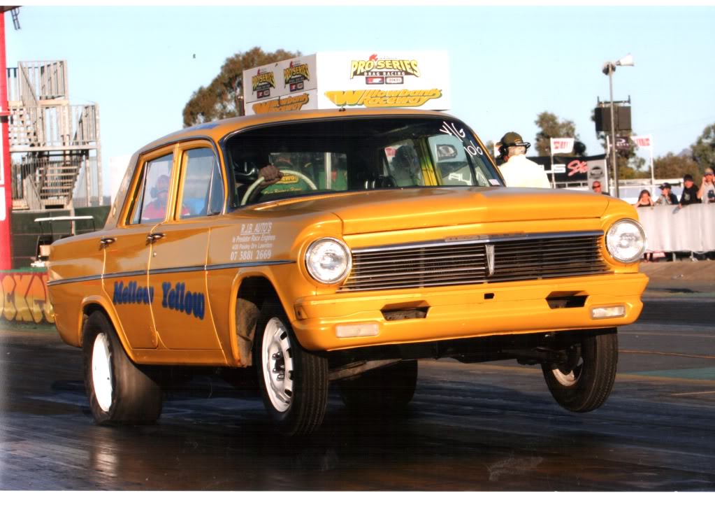

Posted 31 October 2010 - 08:46 PM
http://www.badgerpho...241010-0337.htm
pic of me driving the old mans FJ at warwick.
he asked me not to flog but i couldnt help myself Posted Image

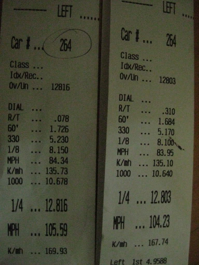

okay, went to a test and tune last night with the new head and cam in and got a pb of 12.80 @ 105.5 mph :buttrock:.
it was launching like a dog, had to much separation in the rear and the shocks were bottoming out and unloading it and it would crash back down. so i put heavier shocks in the back and clamped the rear of the spring and it goes 1.68 to the 60 instead of 1.78.
i did 10 runs in total trying to do a 12.79 but after running 3 12.80's i guess its not in it at this point :dontknow:
not sure how the weight compares to everyone else, but the car with a full tank and me in it weighs 2700 pounds.

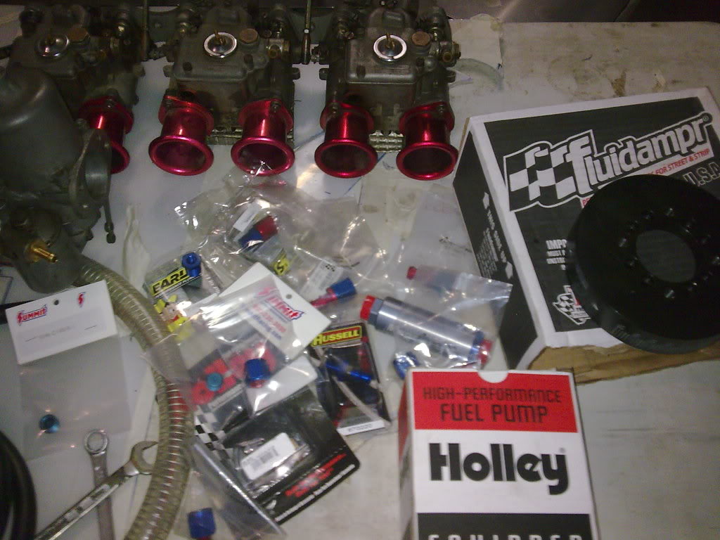

anyways because of an extended period of no racing for reason's im not going to talk about, ive been lightening it up, plastic windows and rear screen, fuel cell etc. car is also going on alcohol with the 2 in SU's.

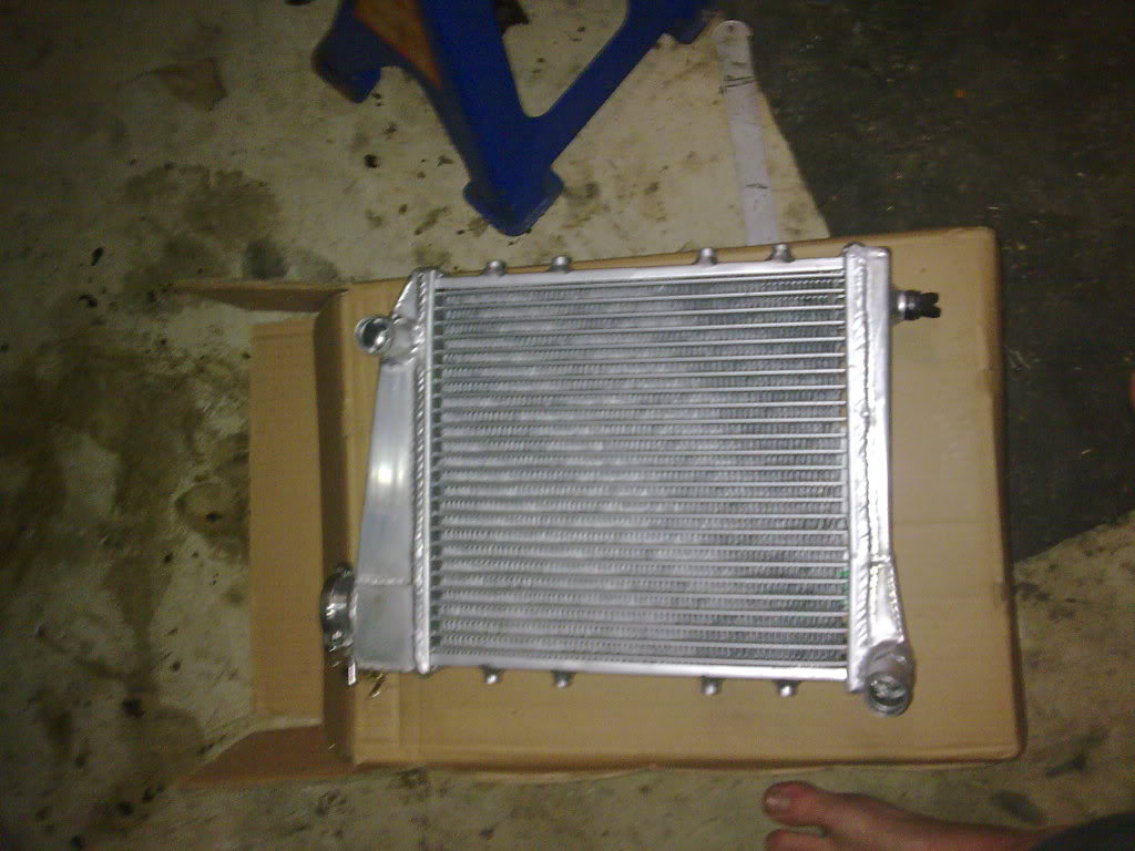

anyways got a china radiator for a leyland mini, its only 270 x 250 core size so hopefully should be able to get it to operating temp easier than i see most people. the Radiator only weighs around 1.5kg's.
Also have a Davies craig pump to go with it.

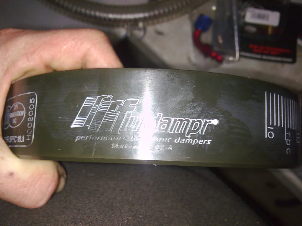

Santa came late today, got all my fittings, fuel pump etc and fluid dampr Balancer, they're a very nice looking piece of fruit!
Balancer is a 6 5/8" diametre compared to the nearly 6 inch romac, i didnt want to go to big as im not too keen on snapping the snout of the crank off.
Had a bit of troubles finding somebody that stocked methanol needles but finally found some, they have to come from england.
with the plastic windows, cell and new cooling system i might lose just a tad over 100 pounds.

What does the damper weigh?
What are the alky needles?
#48 greens nice
greens nice
  • 1,011 posts
  • Name:Kevin
  • Location:QLD
  • Car:EH Holden
  • Joined: 01-November 08
Posted 29 March 2011 - 05:17 PM
thanks warren,
damper weighs 9 pounds so yes quite a bit heavier than a romac, my romac is 18 yrs old so yes it needs replacing.
