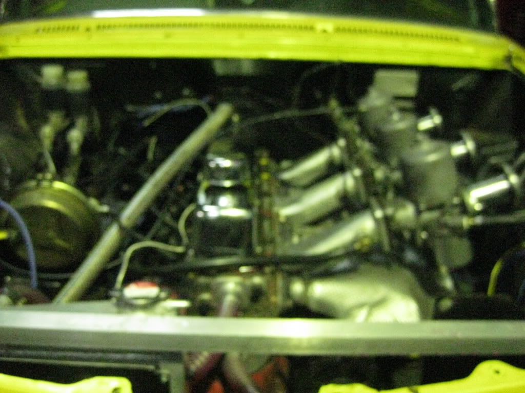

started her up this arvo on meth and it sounds mint!
all i did to the carbs was change the needles, nothing else was touched. hit the key and she fired up straight away and mixtures were spot on.
sounds alot angrier and throttle response is heaps better with the ram tubes i got made.

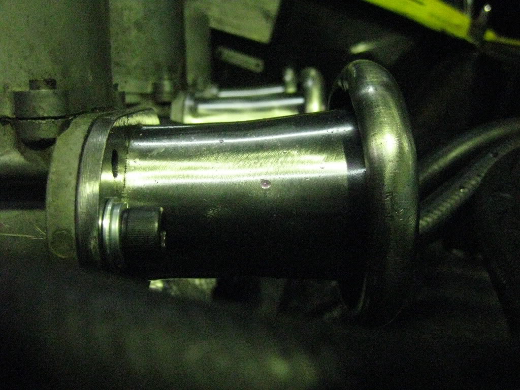

okay as promised here they are
it sounds like a girls car in the video, camera isnt that good.
im gonna bang it on the dyno soon, it fills the sump with meth pretty quickly if you let it idle but it burns off pretty quickly. i also cant get it to idle below 1100 whereas before it would sit on 700 happily?
needles are UVN warrenm i posted where to get at the end of last page.
did a pretty good 3rd gear skid out the back of work but on petrol it wouldnt do it

If it's filling the sump at idle, it's probably a bit rich. The idle part of my needles are almost the same as my petrol needles. I'm using some .090" needles AAA that i built up with solder in the idle area, then turned them down in the lathe.The idle is higher when on alcy & your right, petrol just doesn't seem to have the poke.:3gears:

Just a quick question about the fabrication of your ram tubes.
Any idea how they swaged the end section over like that????
I have been thinking of making a set of tubes for SU,s also but was going to machine them out of alloy.
Dont know if it effects the air flow much when it comes into the carb or not but there seems to be a fair bit of variation in style of the ones that i have looked at.
From a rolled lip like yours to a injection style trumpet to a straight out tube guess the dyno would tell the story??
#72 _Bomber Watson_
Posted 03 July 2011 - 11:45 AM
Perfect bell mouth has a radius of 1/3rd the diameter of the pipe from what i have been told.
Those new ones of Kevs look like a bit of alloy rod bent and then welded around the pipe with the inside then cleaned up??

nope the tubes are just seamed exhaust pipe, my exhaust bloke put them in the press, use a holden/chev v8 harmonic balancer (they have a radius on the backside) and pumped them until they turned out that shape, i just polished the seam out on the inside with a sandpaper burr.
yes fenz i would say so i made these because something would be better than nothing, wanted to give it some sort of radius instead of having a 90 degree turn at the end, but i have a feeling they may be too long so ill pull them off on the dyno and have a looksy.
