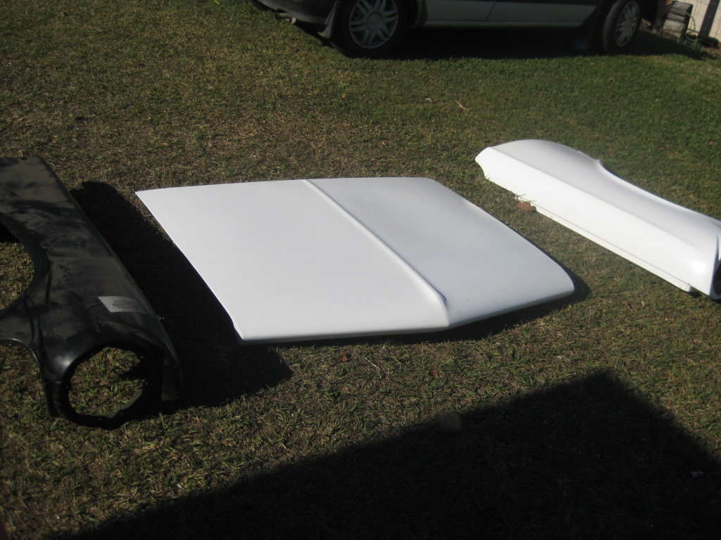

i have found a bloke who makes Fibreglass panels for EH's so the plan is to get another mudguard (i already have one) and a bonnet, still deciding on the boot lid. Fibreglass bonnet should lose a tonne of weight.

glass bonnet and two mudguards weigh just 15kg, theres a glass bootlid on its way as well

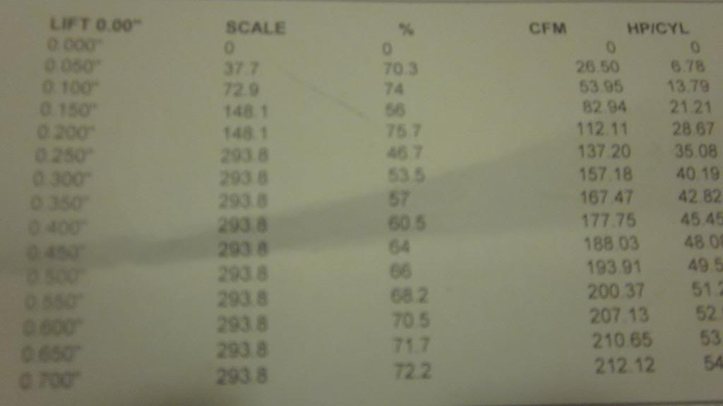

got my 9 port flowed @ 28", not bad.

this is with EVL Black 1.68 & 1.44 valves.
