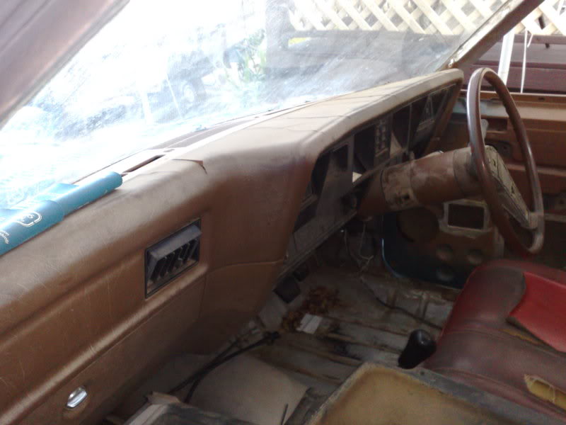

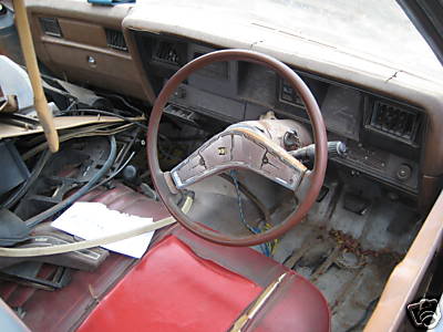

Only thing Im looking at and thinking will need updating is the dash.
But seeing as its reasonably flat and I have a few spare gauges, it shouldnt be too hard to knock one up, or look out for a GTS dash for it eventually.

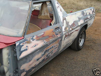

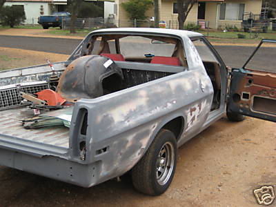

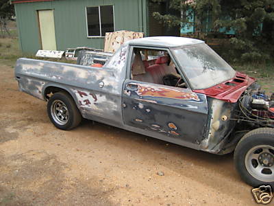

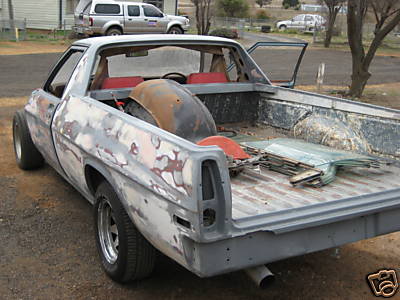

The ute is in very good condition, will only need a bit of a patch on a sill, bit of a repair on a rear 1/4 bit of bog around a flute in the front gaurd (has HT flutes)

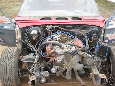

Starts, runs and drives, has lowered king springs with monroe gt gas shocks in the front, same shocks in the rear, look reasonably new.
Has extractors and a 2.5" exhaust fitted, supra 5 speed with a nice bitey clutch.
twin headlight front end, all the chrome bits etc.
Should end up costing us about $1000 all up (accomodation, fuel etc) and we got a play in some snow out of it (something I have only seen twice, karlie once 10 years ago, mum when she was about 18 and my old man about 15 years, so we were all excited)

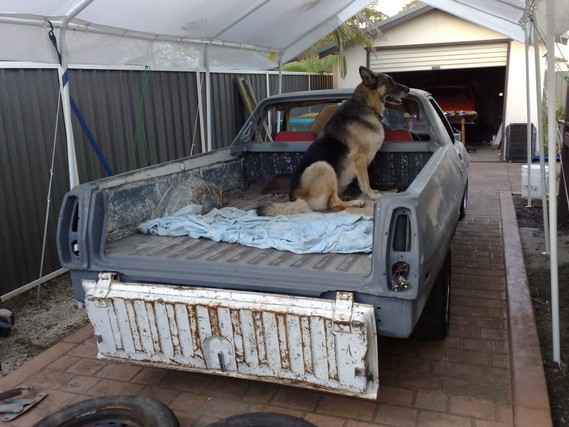

first thing the dog did was try to get in the back of the ute, when we finally unpacked it, she got in and wouldnt get out!
more photos after lunch

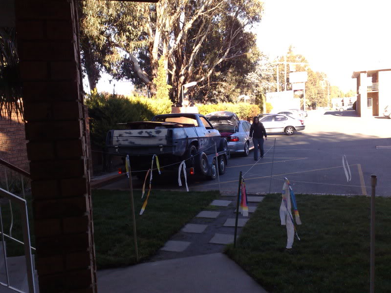

#17 orangeLJ

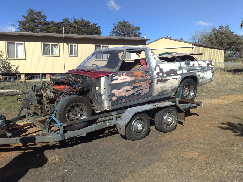

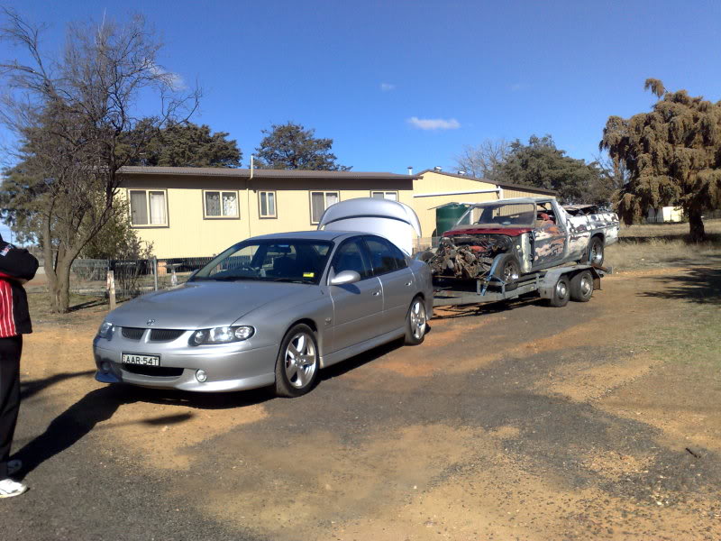

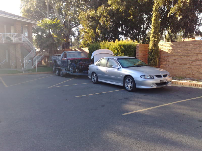

Posted 21 July 2009 - 01:19 PM

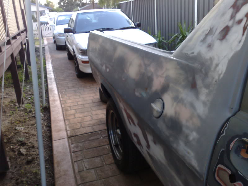

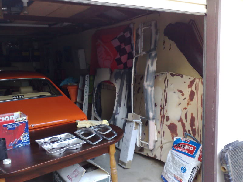

on the trailer at the blokes house-
and its rest stop for the night-
I thought I had a whole lot more on the camera and my phone, but they have gone walk about at the moment.

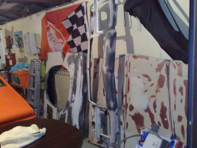

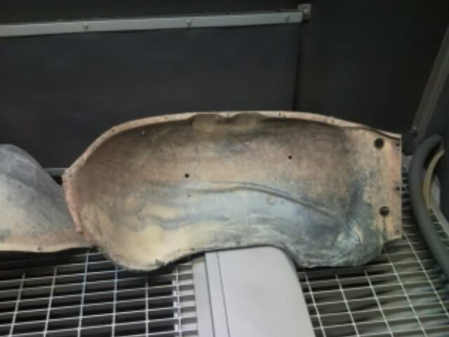

inner gaurds, radiator support, bonnet hinges and some other bits are going to a mates tonight for him to sandblast and whack some primer over at his work tomorrow night, inners will be GMH black, same with radiator support. hinges and bonnet catch will be silver.
going to de-oxidine (rust converter acid stuff) the bare metal on the weekend and slap a coat of primer over it all.

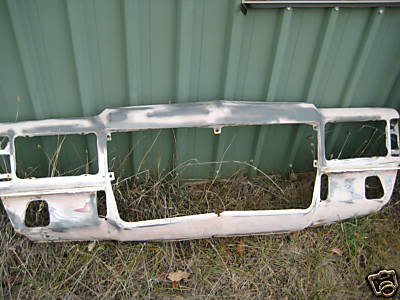

Then a little bit of bog work and a coat of hi-fill rub rub rub and some nice white 2 pack over the top (using a friends booth)
Just need to sort out the front panels (apron, bonnet and gaurds)

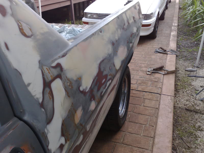

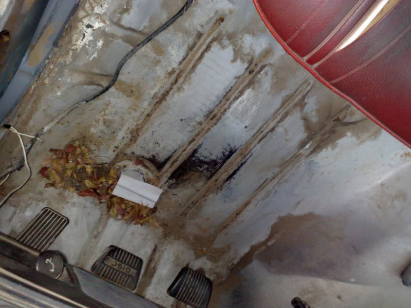

Floor pans are pretty much perfect
Im just going to stick the hoodlinging back in and tidy it up a bit for now, no use replacing it when its in an ok condition.
and yes, the dog has taken up sleeping in the back of the ute, I think she approves.

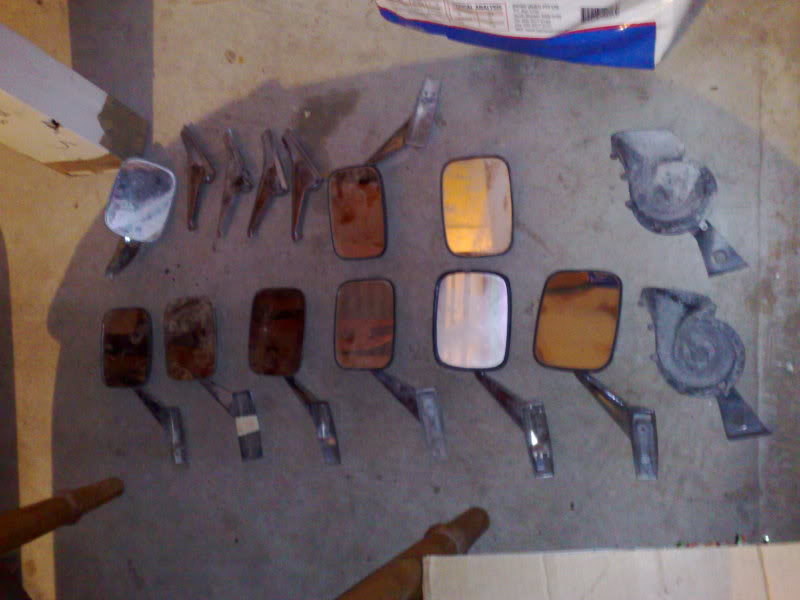

just a few mirrors came iwth it.....

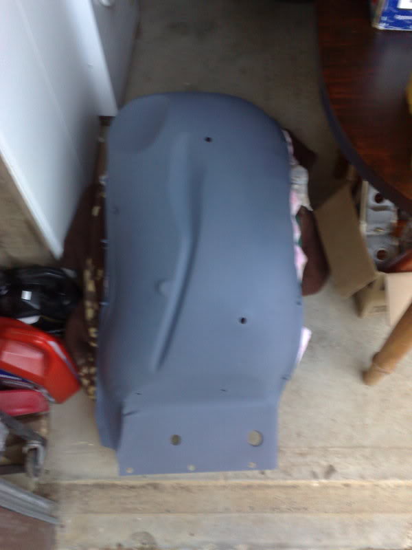

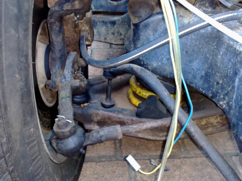

its going to need new tie rod ends, new balljoints, and some new bushes in some places

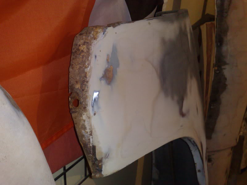

the nosecone has ALOT of bog in it-
Gaurds arent horrible, but arent the best-

the actual car (doors and 1/4s) have bugger all bog.
The gaurds and nose cone are full of it, hence why im looking for some replacements.

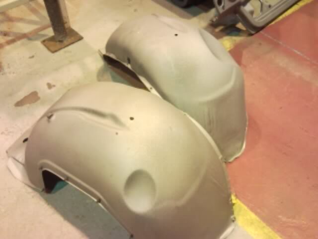

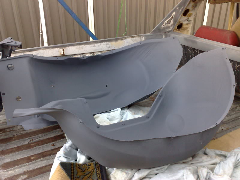

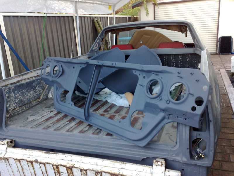

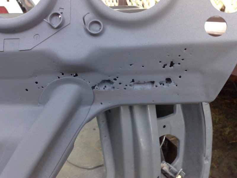

This is the progress from last night-

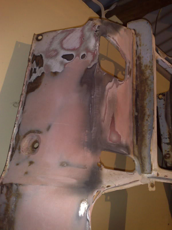

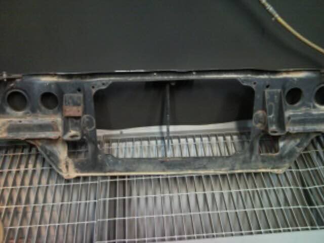

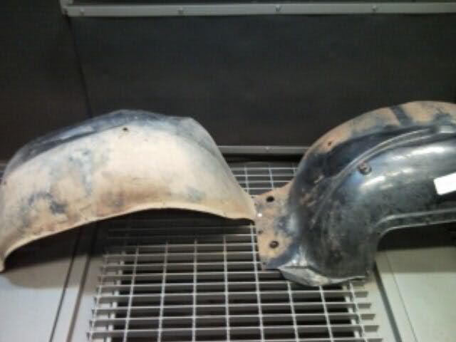

Radiatior support has a little bit of rust, Going to cut it out and plate it over, about an hour long job really, so not too much drama.
inners come up good though!
Ive got some pictures of what they came out of the blasting booth looking like, Ill throw them up in a minute.

Before and afters that my mate sent me last night-
Im pretty happy with that for midweek progress, Im going to plate up and GMH black those bits first thing saturday morning.

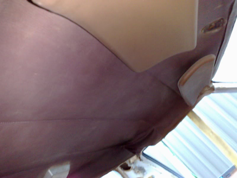

Do yourself a favour and pull the rooflining out and have a good look at the condition of the roof down to the gutter.
Its a really bad spot for rust in there.
Just did a repair on mine on drivers side, passenger side to still do.
