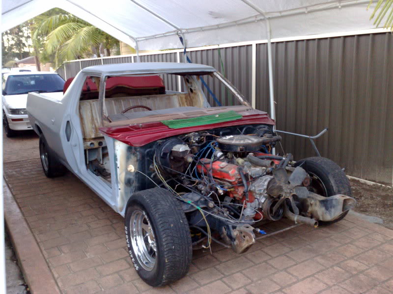

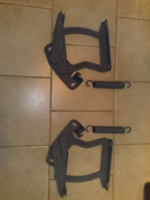

Bonnet hinges are blasted and primered
Ive got a nice little stack of paint cans at home now too.
Bought 4 litres of hi-fill, hardener, deoxidine, rust preventative paint (for the floor), GMH black etc.
I'll buy the white paint once the car has been hi-filled and Im ready to use it.

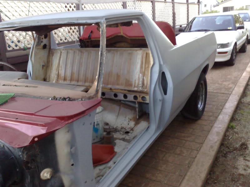

Posted 25 July 2009 - 07:11 PM

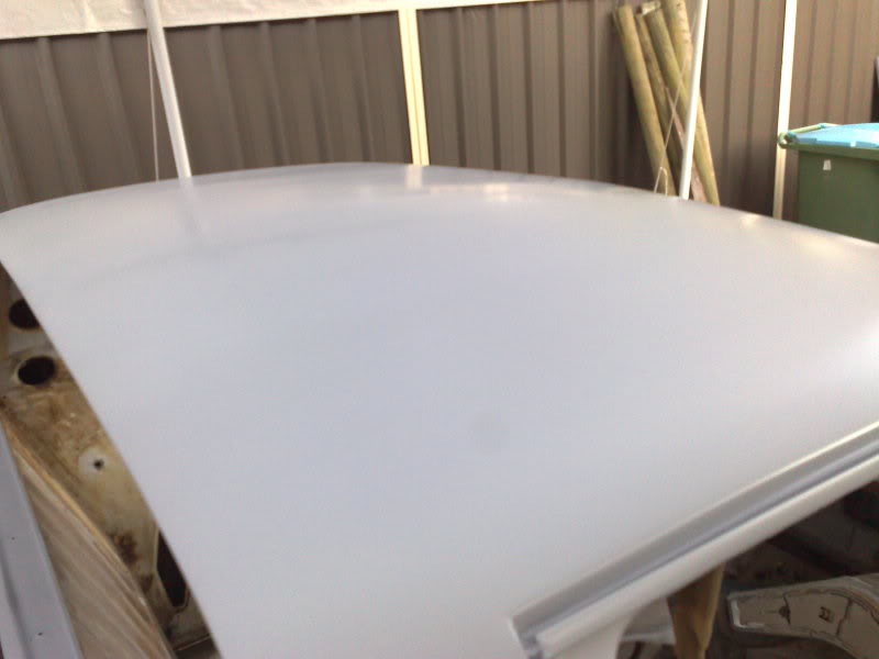

Body is all in primer.
Pictures on monday if I dont get around to it tomorrow.
Doors have some small bumps and some scratches from where someone has 80 gritted them off, so a wipe of fine bog will fix that for now.
Other then that, its looking good!!

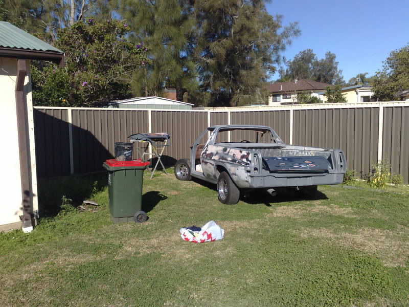

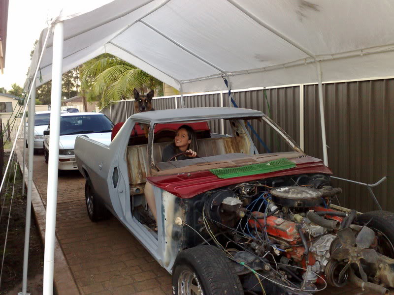

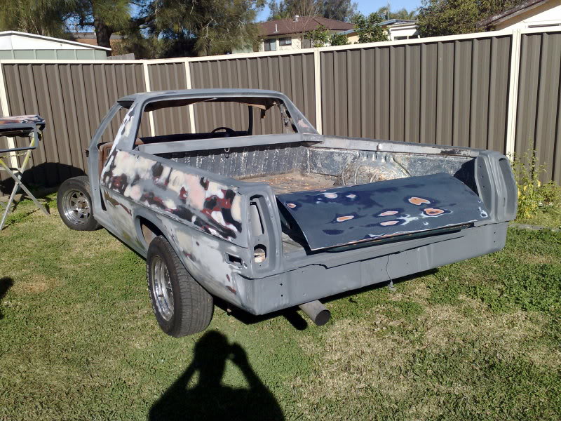

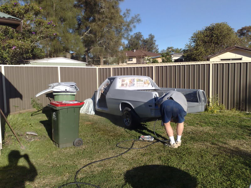

#31 orangeLJ
Posted 27 July 2009 - 10:51 AM
"De-ox-it" ed,
The dog wasnt happy-
primer-
done!
and my two girls who keep from going insane :)

#33 orangeLJ
Posted 27 July 2009 - 12:08 PM

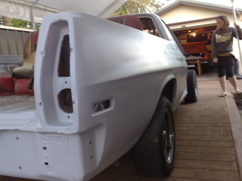

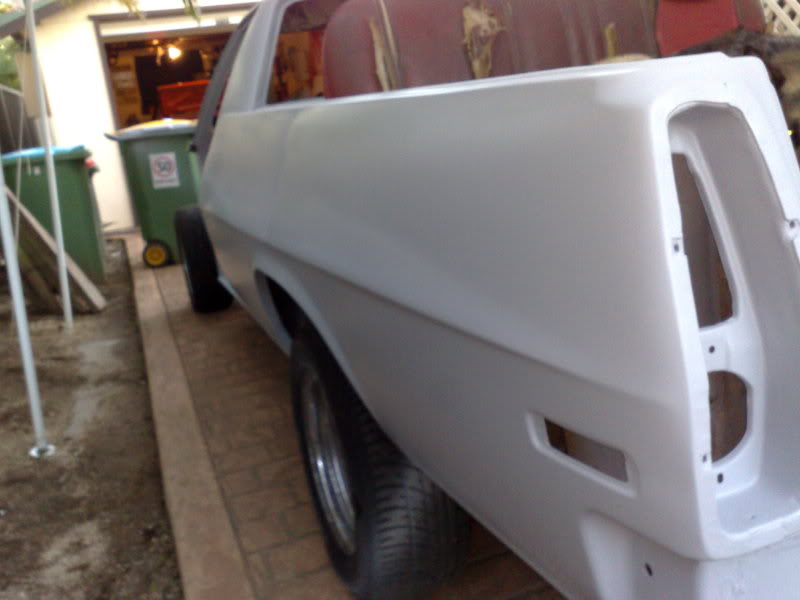

planning on a 3" lowering of the bum, will definitely make the dogs jump easier!
front is already pretty low, I threw the radiator support on and hung a gaurd (roughly)
should look pretty good (fingers crossed) when its done

#35 orangeLJ
Posted 27 July 2009 - 01:01 PM
I hope your talking about guide coating it!
I wouldnt paint it matt black in a million years!
Ive got some areas to attend to, then a light rub, few more coats of primer (only 2 on there ATM) and then I'll give it a guide coat, final rub down and paint.

#38 Heath
Posted 27 July 2009 - 05:20 PM
hahaha yeah it looks great. Why else would my car be like that? :tease:
How straight is it Chris? It looks quite good in the photos, but cameras & primer can both be deceiving :P
I hope it hadn't been in the state it was in for very long.
#39 orangeLJ
Posted 28 July 2009 - 08:51 AM
Had only been stripped for a month and a half from what I was told.
The guy who we bought it off, bought it off (so 2 owners before us) Stripped it down and started fixing things ready for his daughters boyfriend to paint it.
Usual story, couple broke up, ute became a "space filler" in the blokes shed, so he sold it to Mick, who had it under a tarp/leanto thing and a car cover in the backyard at his joint, he owned it for about a month and decided he had enough projects around (I counted 5 others from prems to a stepside converted 1 tonner ute)
But there was bugger all in the way of surface rust, which said to me that it hadnt been sitting in weather or anything.
The sides are actually pretty straight, as is the roof.
One rear 1/4 has a bit of a "flop" above the wheel arch, But its not all that noticeable. Im thinking of just getting my mate to poly fill it and be done with it.
