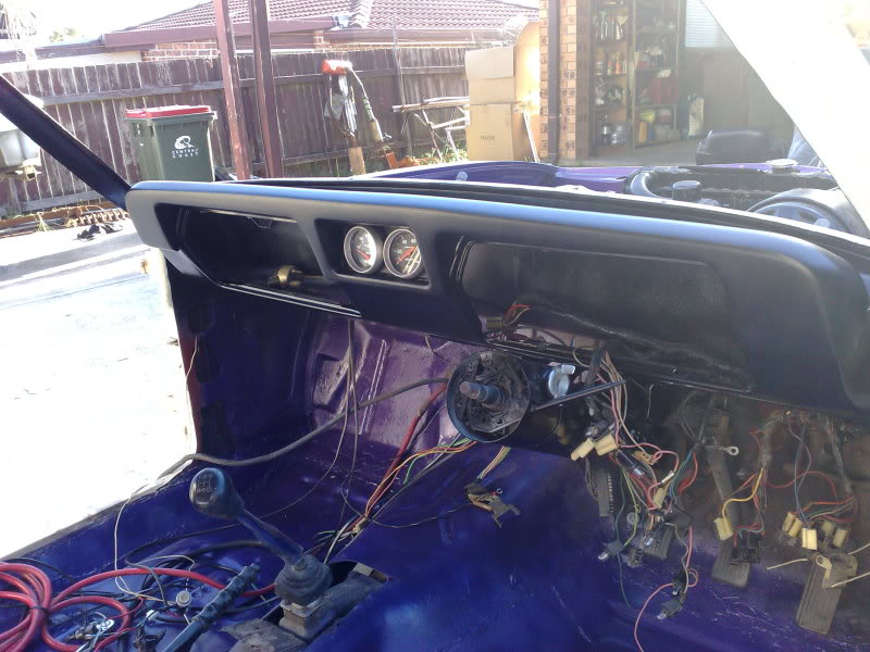

Well Ive got everything I need to build the ute now, all but some bumperettes for the rear.
Got a decent set of gaurds, decent nose cone, GTS dash and pefect nick facia (and clean, scratchless gauge faces), perfect dash pad (black) good underdash in black and some other bits, mate was having a shed cleanup and wanted it to go to a good home!
Ive got 2 or 3 passengers side mirrors, they all look to be genuine too, and majority of them have decent crhome on the stalks and ver good condition heads.
If anyone is after some mirrors give me a yell.
Should have the whole car in primer, plus all my spare panels by sunday arvo (depending on the weather)

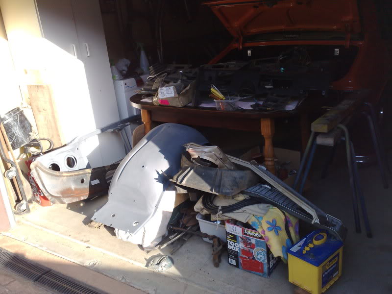

#60 orangeLJ
Posted 10 August 2009 - 10:23 AM

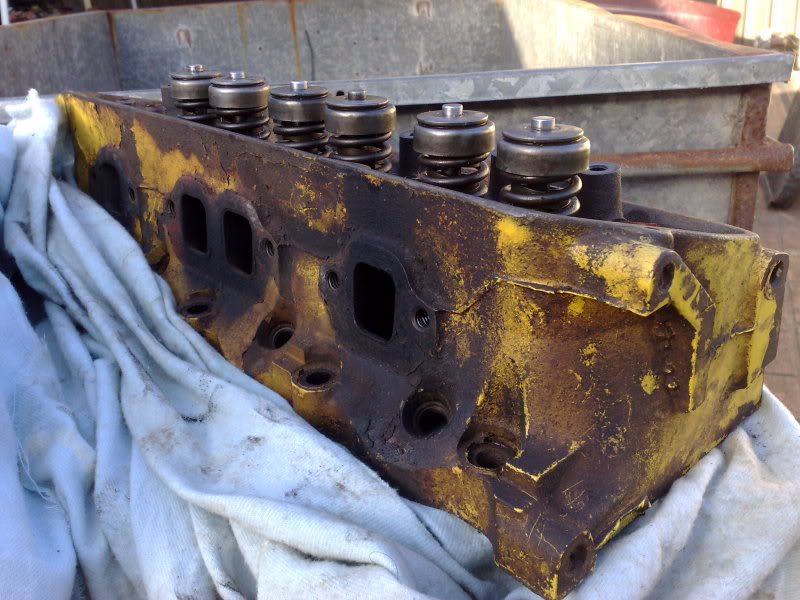

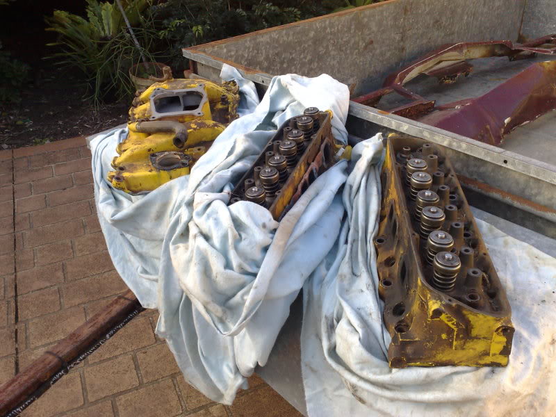

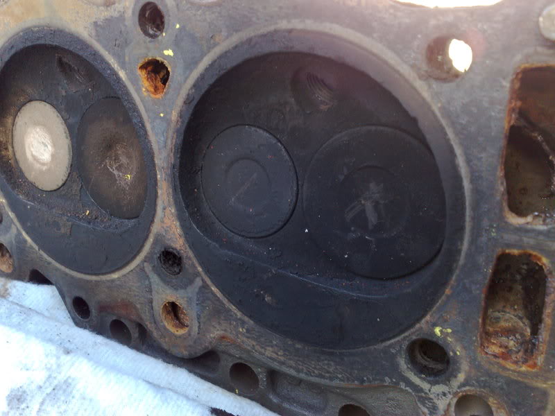

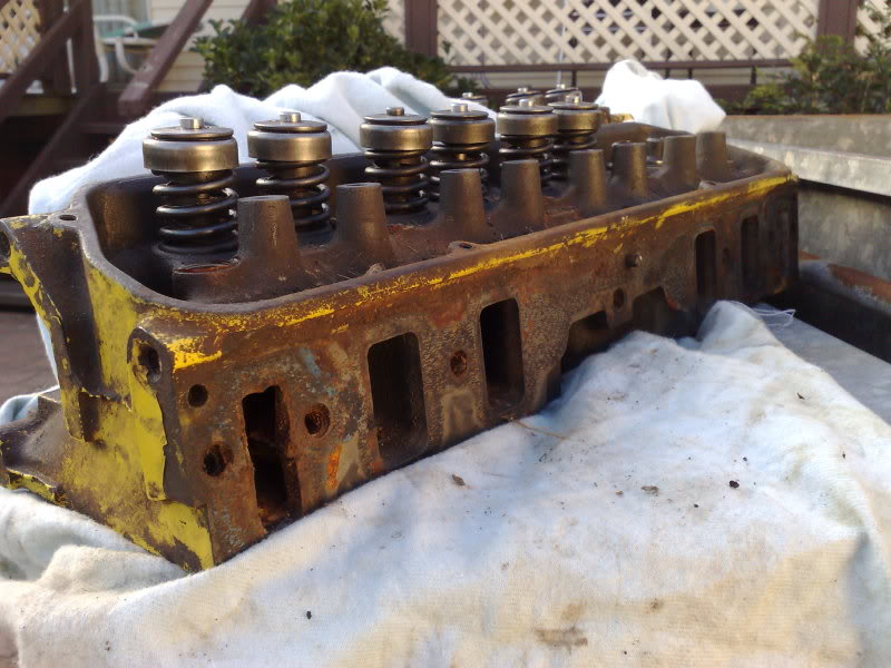

picked these up cheap at a swap meet on the weekend-
will need a reco job (will get it through a mate) and 2 new valves + rocker gear, but other then that they will go in the shed for a little while, unitl I decide to throw a 308 together in 6 months or so.
I also bought a kingswood grilled (chrome strip around the outside, silver in colour, square grille slots) for $40 in good condition, I need to decide whether im going to paint it black or silver, wont be wearing the kingswood badge though (already removed and on the fishtank top with my 6 or 7 GTR badges)
the parts pile in the back of the shed is growing alot lately-

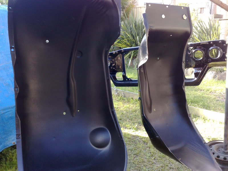

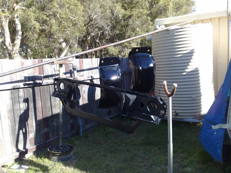

#61 orangeLJ
Posted 17 August 2009 - 04:26 PM
Radiator support and inner gaurds are now painted!
Underside of gaurds are GMH black, tops gloss black, back side of radiator support is GMH front is gloss.
Came up REALLY good.

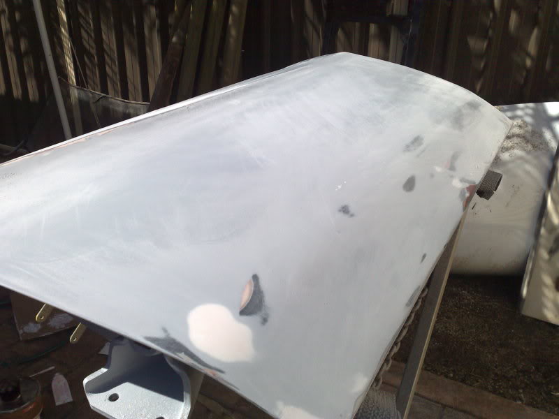

Did some minor bog work (fine over primer bog is awesome stuff!)
filled some pin holes and some small low spots. VERY happy with how it came out.
Also started to strip my front nosecone/apron, should come up alright, but some dodgy bastard has done the following-
stripped it to bare metal, left it in that state to get surface rust, primered (few coats) then guide coated, obviously left it, rust came through primer, lets blow some more primer over the top, few more coats of primer, more guide coat, and left.
So some small rust spots, stripped back to bare metal in tonnes of places (just whizzing it back) prick of a job though! going to DEOXIT it and prime it.
Ive got a bunch of photos to throw up once I get out of this lecture.

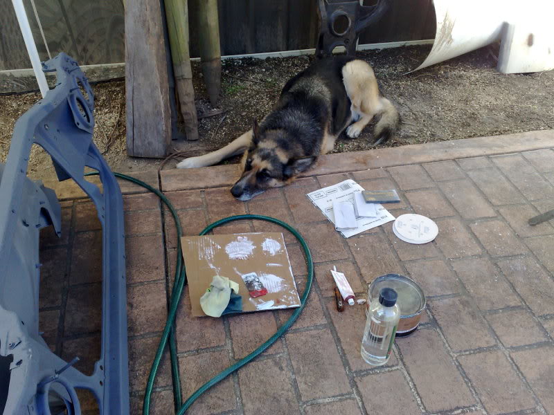

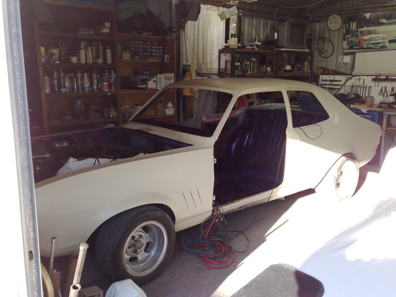

#65 orangeLJ
Posted 19 August 2009 - 11:20 AM

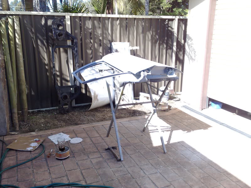

alright, pictures (finally) off work with a crook back/neck today, so snuck over to the parents house and bludging their internet.

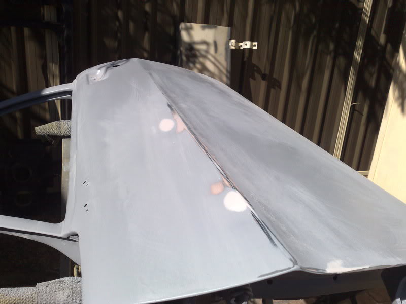

did some rubbing and some light bogging on the doors, now ready for a couple more coats of hifill
the dog helped.....
They arent perfect, but Im only expecting it to be a 10 footer, (look good from a distance!)

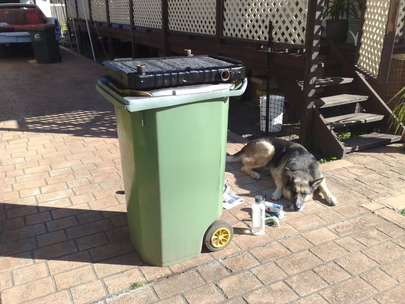

flushed the radiator, cleaned it up and gave it a paint, as you can see the dog helped with this too......
So that was all done over the friday/saturday (had friday off because Karlie was heading up to see her mum in Port.... good reason for me to have a day off too!)
on the sunday I painted the inner gaurds and radiator support-
matt black on the under side, gloss on top.

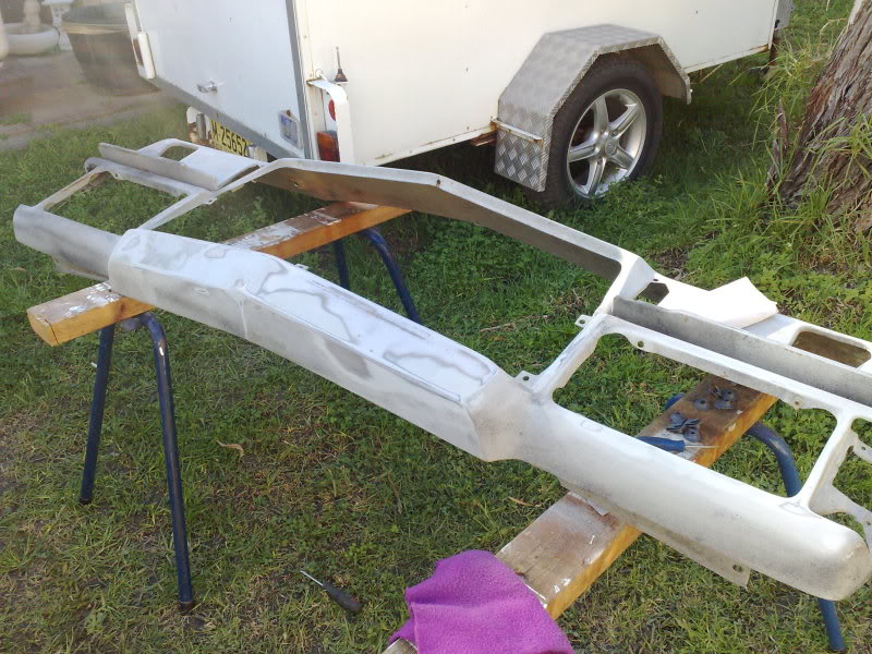

Then I got stuck into the nosecone/apron
dog came for a visit to mum and Rays, so she helped out some there too....

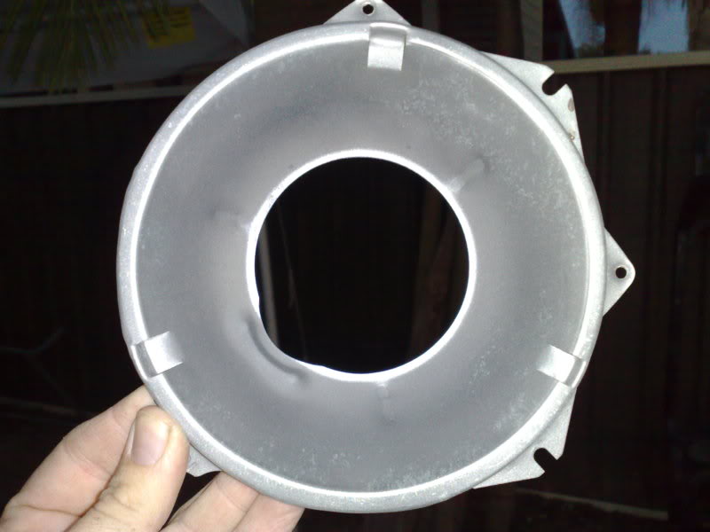

#66 orangeLJ
Posted 19 August 2009 - 11:22 AM

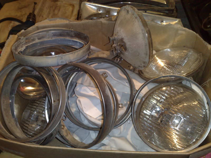

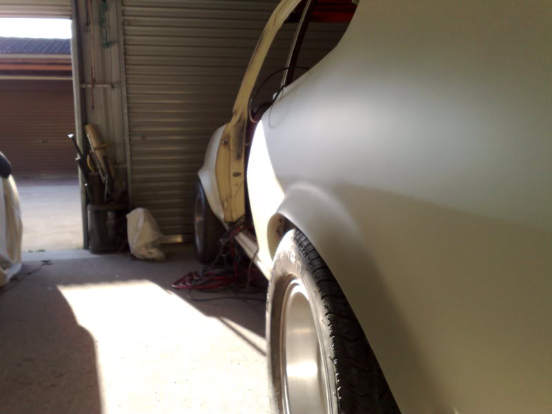

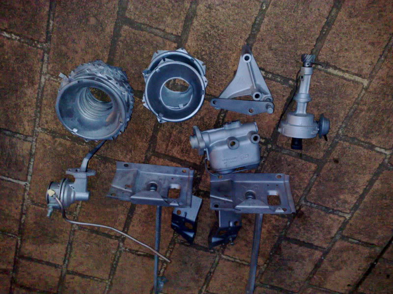

and just a few things I got blasted by my mate Gary-
Ive got 20 odd of these things with the chrome trims for the headlights too-
The other project on the go at the moment is this one-
it will be at toranafest, finished. so very busy at the moment!

First time you've actually posted any progress on the flared LJ. And people say pumped guards look shit; that is HOT
Will it be registered?
Yeah, I havent posted a whole lot on it since we first bought the car.
Plans have changed a little bit with it over the last year or so, but its running a very healthy 202, triple 40mm webers (the ones that are due to get cleaned up and thrown on my car) just standard XU-1 style headers and a sidepiped exhaust (so pretty mild for the moment) with just a steel case celica 4 speed, hydro clutch, welded 3.08 diff (might have been a different ratio, we threw it in ages ago!)
Ray is currently sorting out fitting the Autotechnica seats we bought a while back (they were cheap, we are on a budget) They sit a bit high, but will give a decent seating position.
Suspension is lovells springs, koni shocks, nolathane bushes for the most part
But there is a stack of parts in the shed that will go to the next engine, roller cammed, JZED headed triple 48mm webers etc etc.
It will hopefully end up on club rego, but for toranafest Im just trailering it up. (it hasnt had any testing engine wise, would need a different exhaust, still havent got wheels+tyres sorted etc) Im thinking of throwing my 16" ROH wheels on it for the show.
