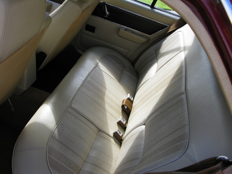

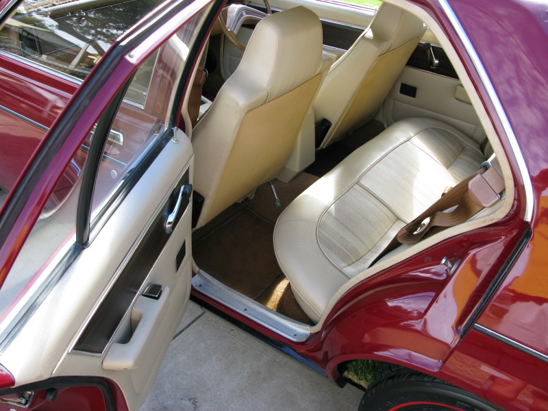

Another 18V from the LX range.:

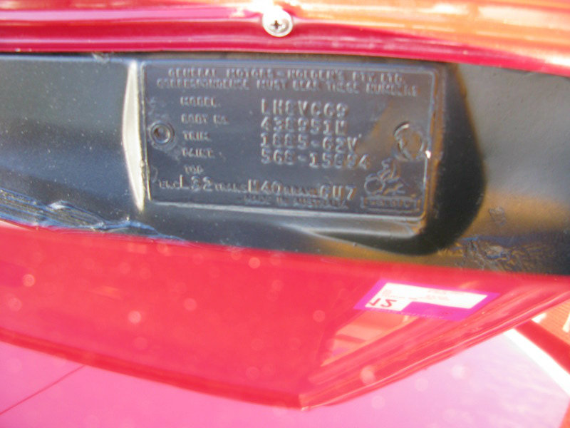

1885-62V, a mixture of Chestnut and Doeskin in my old LH SL 4.2 auto.

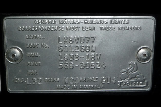

col if you don't mind me asking?
where did you find these photo;s
of the trim and tag 1933-18V 568-30524
being valencia orange and slate trim with golfball
happens to be the same as my A9X hatch
davemcPosted Image
#82 Statler
Posted 12 July 2012 - 11:40 AM
I stole it from an add on Shannons i think.
Someone posted a link up. I try & save any trim pics i can find for the database.
