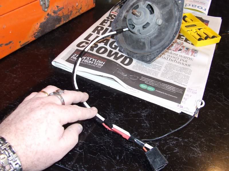

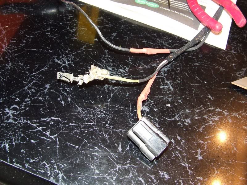

Well the last couple of days I've been a bit under the weather, so haven't done a lot.
Today I redid the wiring on the heater motor, to replace the heatshrink with a piece of heatproof fibreglass sleeve.
I had to pull the old plug apart to be able to slide the new sleeve on.
I had to unpick the terminal off the wire so the new sleeve would fit over.
Here it is now all done. I haven't coiled the wire around like it was before, as the only time it will have power to it, there will be a big barrel fan blowing air right onto it.

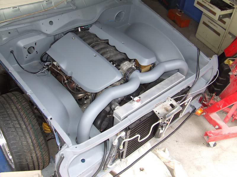

I also refitted the intake pipe now it's a matching shade of grey. It looks good in my opinion, but maybe I'm just a bit biased?

How much heat will the intake pipes hold?
#693 ls2lxhatch
Posted 22 April 2010 - 11:14 PM
I doubt heat will be a significant factor with the current design. You could ceramic coat the outside of the pipes in silver or black.

i dont think the air intake's will hold much heat, but will be interesting to see.... its come up a treat thats for sure Posted Image
