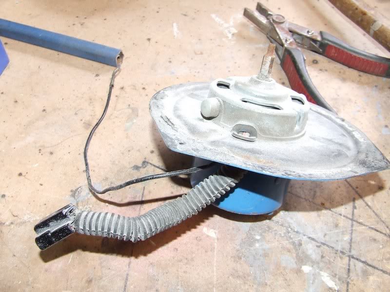

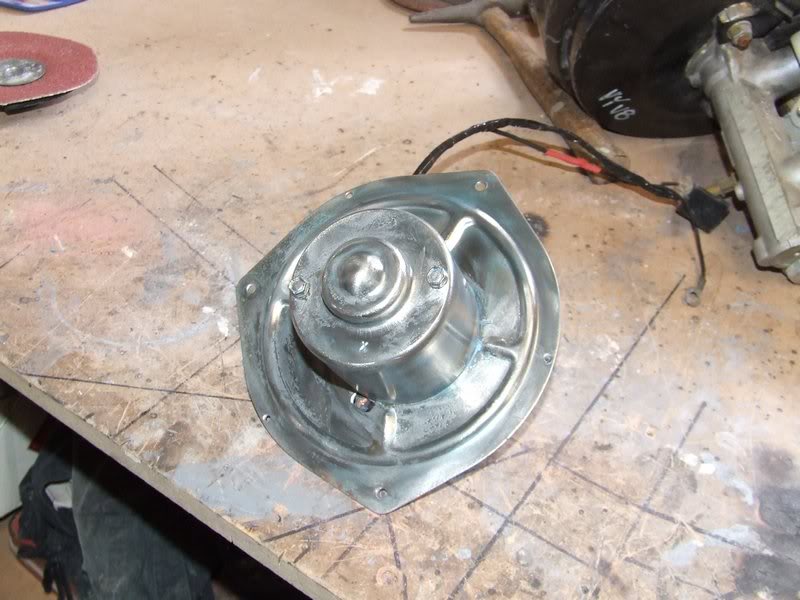

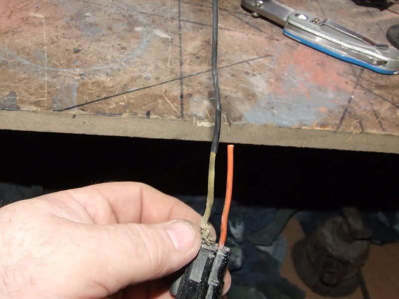

One of you clever lads mentioned earlier in this thread something about hiding the heater motor wires inside the heater box. That seemed like a very good idea so I had a look at how to do that.
Luckily, the little hole where the wire comes out is located in a way that will allow the wiring to be pulled back inside. I removed the fan wheel to do this, is it's only 1 nut to remove.
The pull the wires through the hole I just cut the plug off and resoldered the wires back together, rather than trying to dismantle the plug. One of the wires had a cloth sheath, instead of the usual plastic insulation. This wire was a solid wire, very weird. Anyway, the cloth was a bit old a buggered so I just covered the whole thing in heat shrink. The solid wire was a lot longer than the other wires, so the other 2 wires were extended.
Here's the wiring finished, and coming out the inner side of the motor surround.

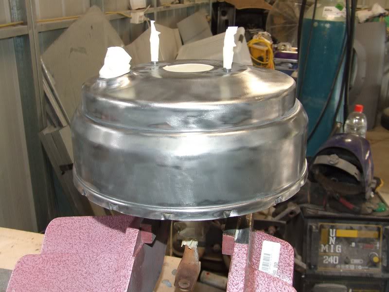

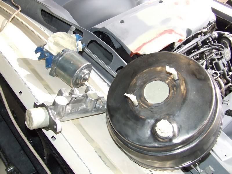

The brake booster was next. I was hoping to just rub it down and paint it, being the lazy bugger I am, but there were a few scratches in it that were quite deep so I figured I'd bare metal it too. What a pain that was!! I don't know what they use on these things, but it's very tough. All done now though, thank god.

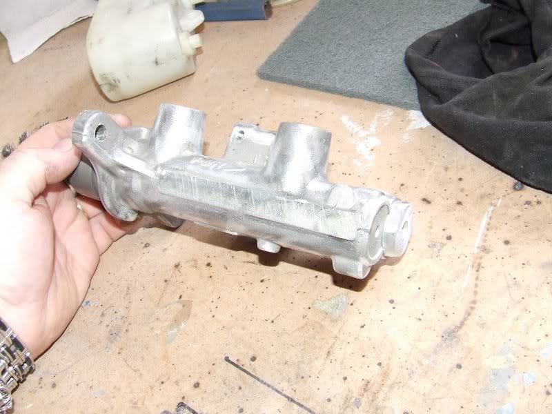

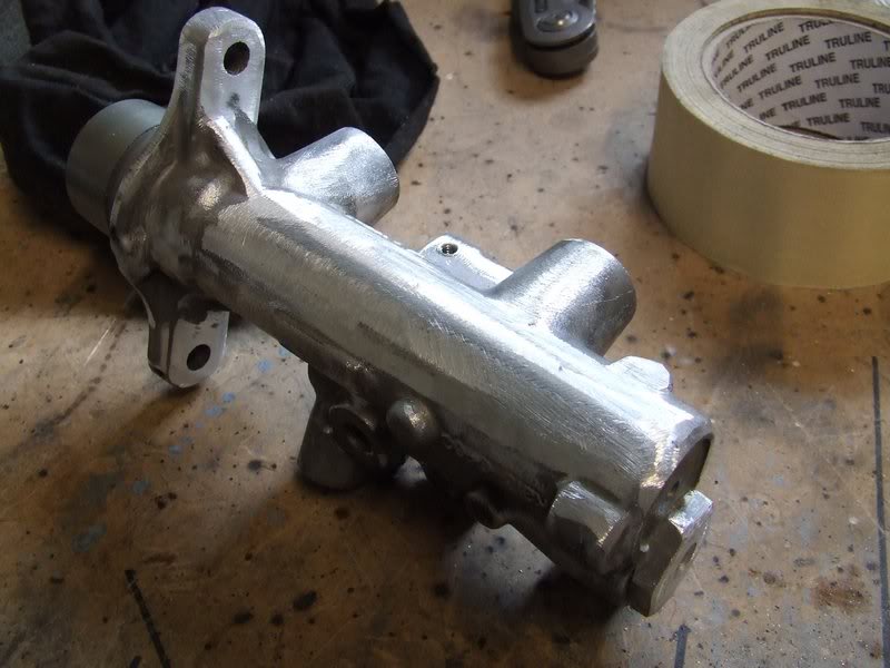

Next up was the master cylinder. I gave it a clean but decided I didn't like the big flat area on the side of it.
So I sanded it smooth, leaving as much of the metal here as I could, as I assume it needs some strength in it.

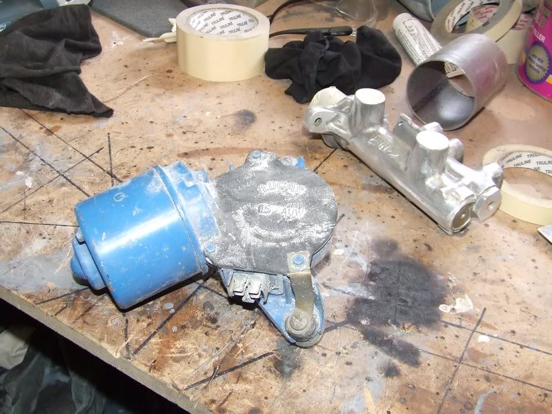

Next bit of awesome fun-ness was the wiper motor.
Most of the paint was fairly easy to get at but some of it was hard due to the confined space. The paint left on was rubbed back with scotchbrite so the primer will still stick.
I removed the cover plate for the drive wheel on the wiper motor to paint separately, and am wondering whether to make an alloy one or not. I don't know if I want to make a feature out of something like a wiper motor?

You didn't have to chop the blower plug, the motor unbolts off the mounting plate easy enough, doesn't matter now though.
Its going to be quite cumulative effect paying attention to all the small bits and pieces once you get everything back together, should look good!

when you did the heater fan you mentioned a funny wire that was cloth covered and solid.
that is a resistor wire kinda of like a ballest resistor wire. when the fan is powered by 12 v it is fast when power is though resistor wire there is voltage drop across resistor wire and fan is slow. this wire gets hot so is cloth covered as plastic would melt. covering it in heatshrink is not a god idea as it will not be able to radite heat and over heat ... small fire... larger fire... no more car... suggest you take heat shrink off!
this is why it is normally wound in a loose coil in engine bay to give it air to breath and keep it cool

that is a resistor wire kinda of like a ballest resistor wire... ... small fire... larger fire... no more car... suggest you take heat shrink off!
Excellent info cruiza, I never knew that. thanx for the heads up.

its coming along nice your doing a really great job and thx to cruiza about the ballest resistor wire as mentioned above by TerrA LX keep up the good work Posted Image

Interesting about the motor wire, early Commodores used the same basic resistor pack setup but just had normal wiring albeit a lot chunkier - if its stuffed maybe just replace the wire with much heavier gauge?

cruiza, thanks for the info. This is why I love this forum. The knowledge here is priceless.
I'll redo that wire, as a fire is not on the list of things to do. Thanks again.
