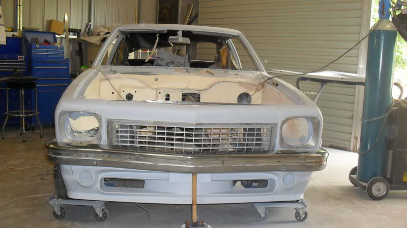

Well the last couple of days have been fine tuning the front end/spoiler so everything lines up as it should. After getting it bolted together the best I could, I knew I'd still need to add a little bit of filler to get the gaps spot on. It's a necessary evil : )
At least it's not a lot of filler. Just enough to know how much I hate sanding it : )
This shows that the front spoiler is about level if not a little lower than the sills, which is pretty good I think. You can also just see here that the spoiler comes to a peak, but in line with the UC stone tray, not the LX nose cone. I don't think the difference is too obvious. Not enough for me to worry about anyway.
Once I was happy enough with the finish I smothered the lot in 2k primer filler.
Now I have to wait until tomorrow to be able to bolt it all back together again and see it all in one colour for a change.

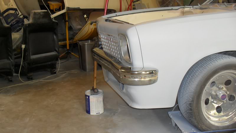

Well after priming the front panels again yesterday I had to go out first thing today and bolt it back together, as it's been a long time since I'd seen the front end all the same colour.
I'm not sure yet whether I'll keep the high tech bumper mount I've got going on here though. : )
I like the look of it. Most people wont even know it's different, and I like the subtle idea. Pity it was so much bloody work!!!! : )
I'm really happy now with how the panels have lined up. Now I can get stuck into the engine bay smoothing and driveline swap. Yay!

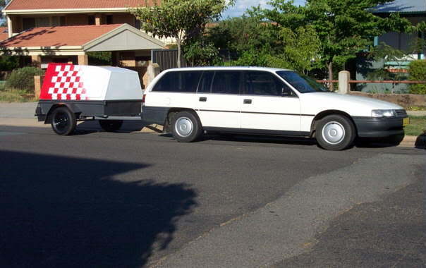

Oh, there is this as well. My first sheet metal exercise.
Tows well behind a Torana.

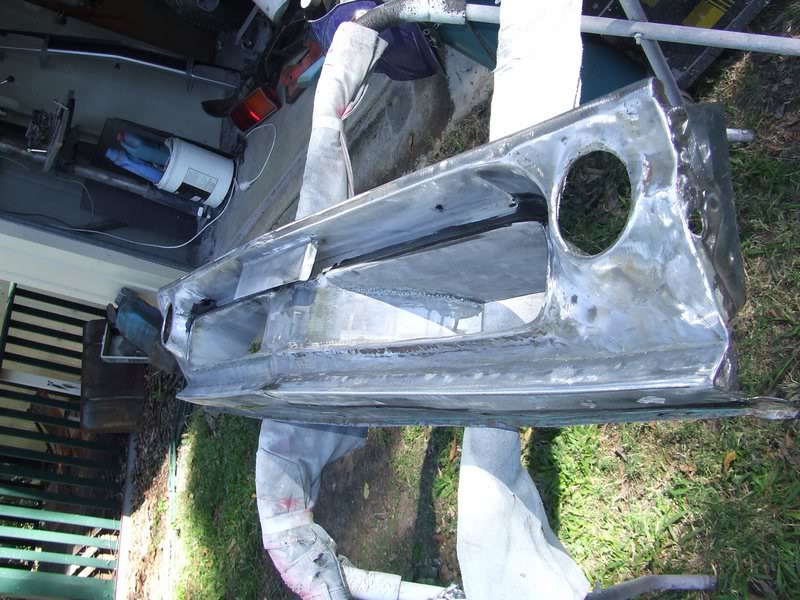

As for the indicators, I made the shape of the opening - rings - from the same 6mm steel rod as I used to form the brake ducts. I tacked the rings I made from the 6mm rod into place, as they touched the original UC stone tray in one spot. I then just used the old dolly in a vice trick and a hammer to shape the new sheetmetal to fit around it. I'll dig up some pics as I was making it, as I took crap loads of photos while doing this car as it's the only way my brother gets to see it : )
Edited by dirtbag, 03 January 2010 - 12:12 AM.
#73
_dirtbag_
Posted 03 January 2010 - 12:09 AM
You can see here the ring I made to form the opening. At this stage I've already made the lower section, but the top is still yet to be done.
This pic of the inside of the spoiler shows the ring and the bits of shaped metal around it. It's not too pretty in there, but it does the job : )
To finish the top of the spoiler and give it some support, I welded a length of 13mm RHS along the top. This also filled the gap left under the bumper. I made the top section of the indicator surround mould into this part just to give the area a bit more shape.
I hope that's kind of what you were after.
