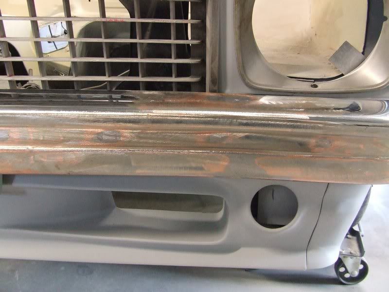

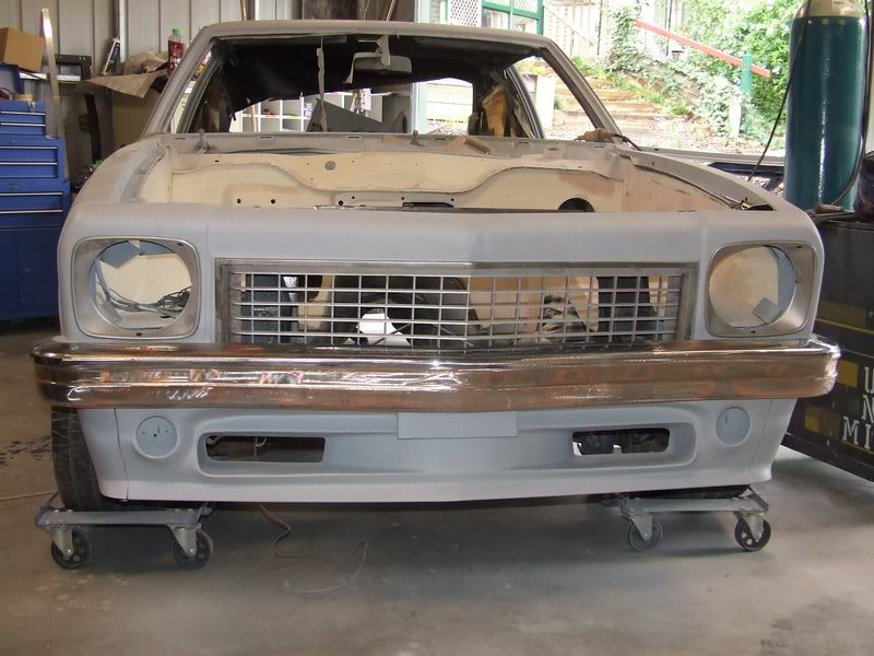

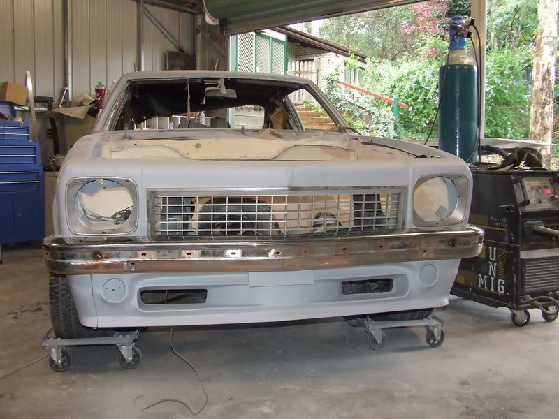

Well after spending all morning doing a weird combo of UC and LX front bumper mounts, there is a front bumper mounted. I don't have that extra bit the LX bumpers mount to, so I used some of the UC mounts and joined it into the LX bumper.
I don't want any bolts or holes showing either so I'm welding the mounts to the bumper for a smoother look.

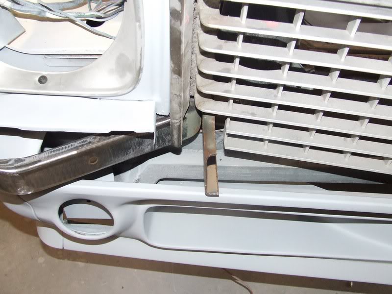

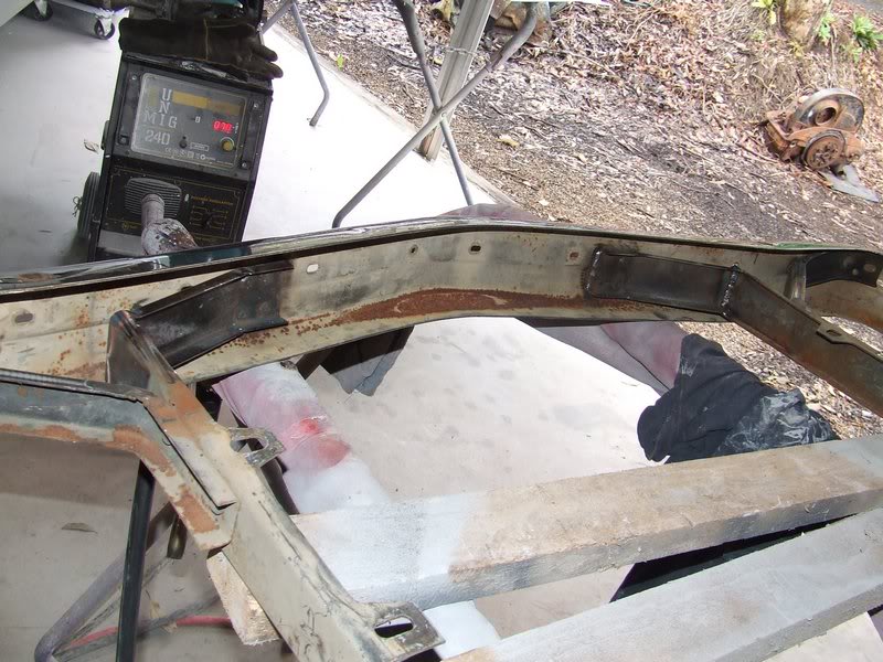

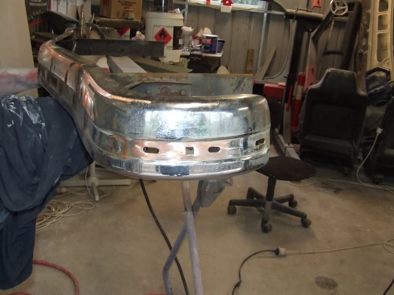

OK, I started making my mounts with a combination of UC and LX mounts, but the LX mounts didn't really help, so I cut the LX bit off and just made a couple of pieces to get it good and strong, as the UC mounts are fairly flimsy.
To fit the UC monts I had to cut a little bit out of the LX grill. The piece of bumper mount that sticks straight out used to have a mount on it for the UC bumper but it stuck out too far and wouldn't let the LX bumper sit right. That's where I "did" have the piece of LX bumper mount. Not any more.

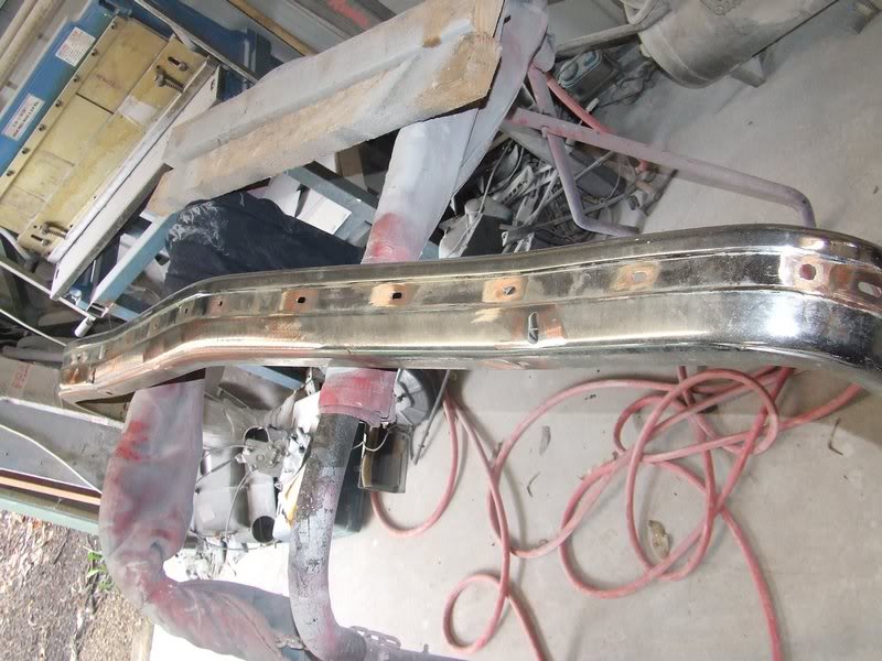

My brother decided he didn't want the rubber strips on the bumpers. Luckily for me he gave me a bumper that had the rubber strip, so now I have to weld up all the holes : ) That's OK though because I'm also getting rid of the mounting bolts and factory jacking points too.
The first step was to knock the dings out of the bar and give it a good clean up around where I need to weld.
After a lot of mucking around and measuring I tacked welded the bumper to the UC mounts. It's nice to have it sitting there all by itself for a change.
I'm pretty happy now with where it's sitting.
With the bumper tacked to the mounts I was able to unbolt it from the car and start making it stronger. To add some more support to the monts I added some pieces I folded into U channels and welded them in so they spread out away from the original mount. It's super solid now.
I didn't count how many holes were in this bumper, but there was enough : )

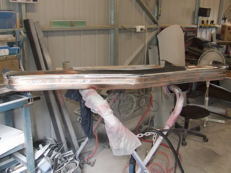

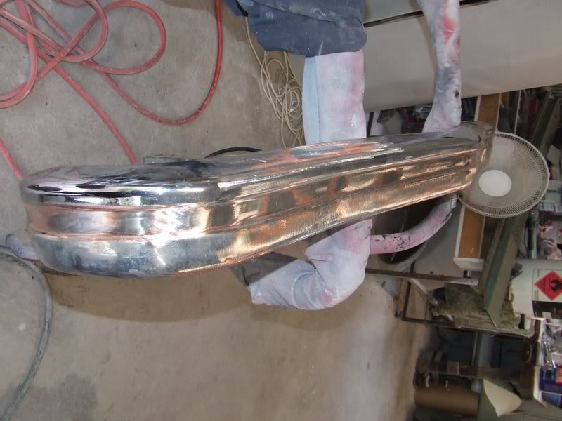

Here's one side done. You just have to take your time when it comes to smoothing out the welds. Especially since this is going to get chromed again.

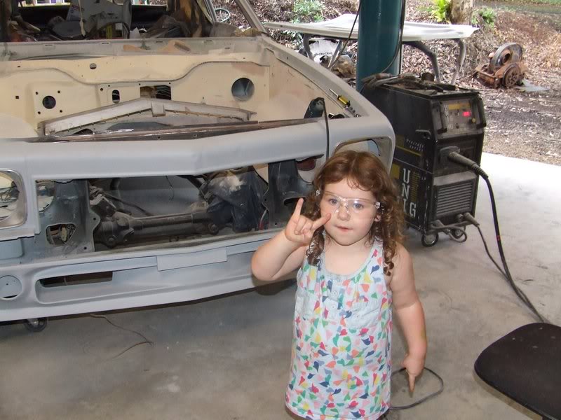

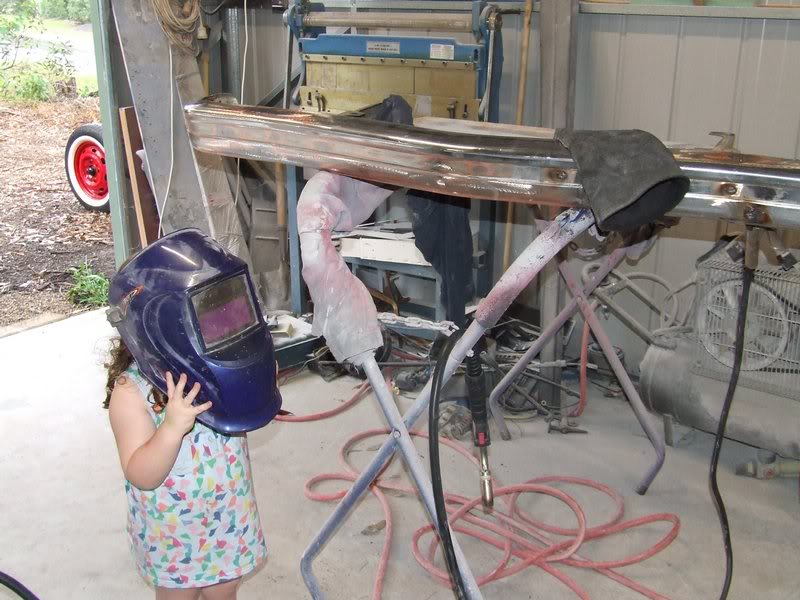

Here's my lovely daughter giving me a hand today. She's awesome. Love the safety specs and heavy metal hand : ) Yes, I taught her that.
Then she did some welding on the bumper for me.....
Finally all the welding and sanding is finished.

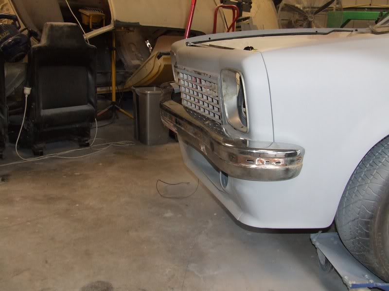

It was good to see it on the car. I like the subtle smoothness it adds to the front of the car.
In this small area, there used to be top and bottom mounting holes, rubber strip mounting holes and the big factory jacking point slot. Not any more : )

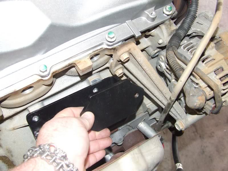

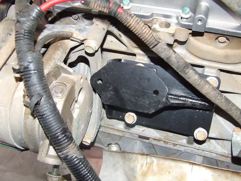

I also had a bit of a squizz at the engine mount adaptors for the LS1. The drivers side just clears the A/C compressor, but the passengers side hits the alternator support. No big deal though. I have a grinder : )
