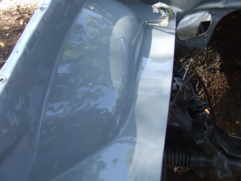

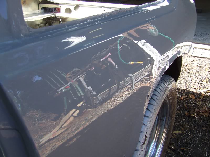

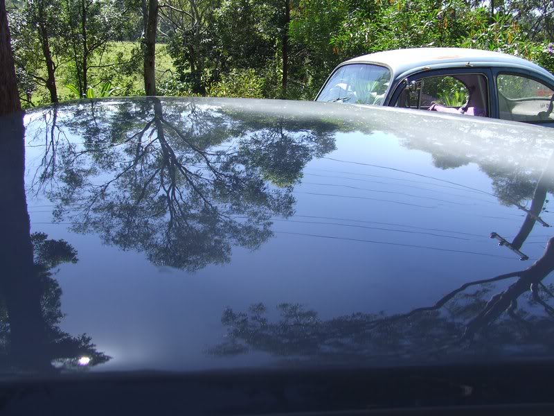

The good thing about having all the surfaces sanded smooth is I can put a thin coat of water on it and see how straight it is or isn't. Luckily in this case it looks pretty good to me : )
Make sure there's as little amount of water on there, as it will fill small imperfections.

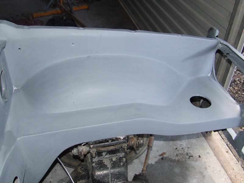

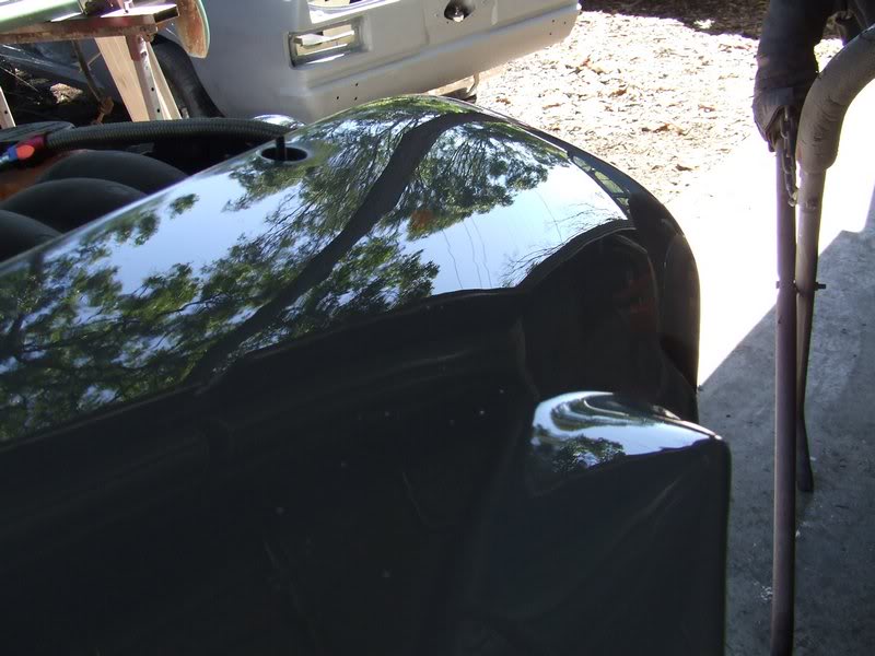

I even used the same trick on the engine covers to see that the area where the oil filler hole used to be was dead flat.

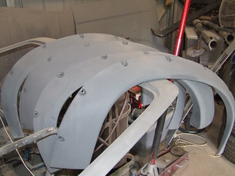

All the flares are now sanded and ready for paint.

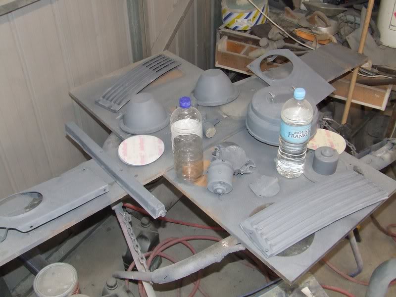

I also sanded the headlight buckets, headlight mounts, wiper motor and cover, brake booster, removable radiator support bar, heater box (not in photo) and B pillar vents. These are now all ready for top coat.

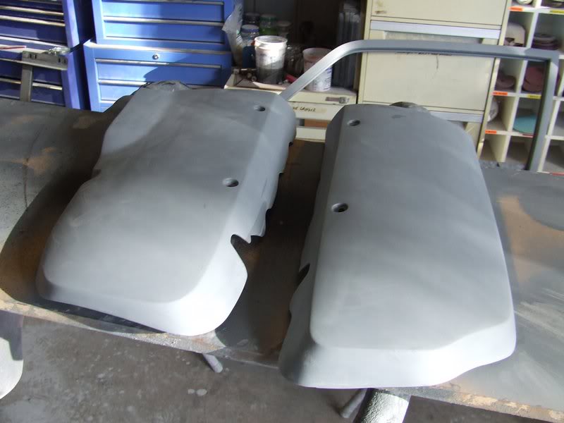

Here's the engine covers after a wash from sanding.

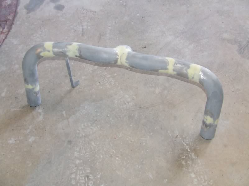

The intake pipe had a bit of filler work done to smooth it out.
It's now ready for it's final coats of primer.

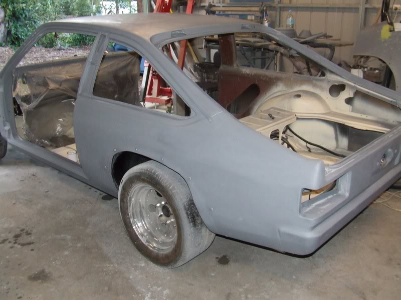

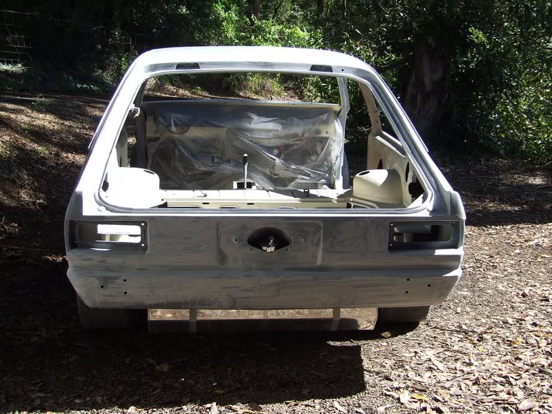

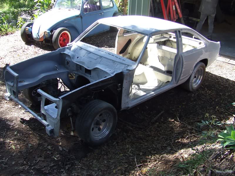

Here's the shell after having a wash. I'm very happy with how it's come up.
I can't wait to see this with shiny colour on it. Not long now!!!
