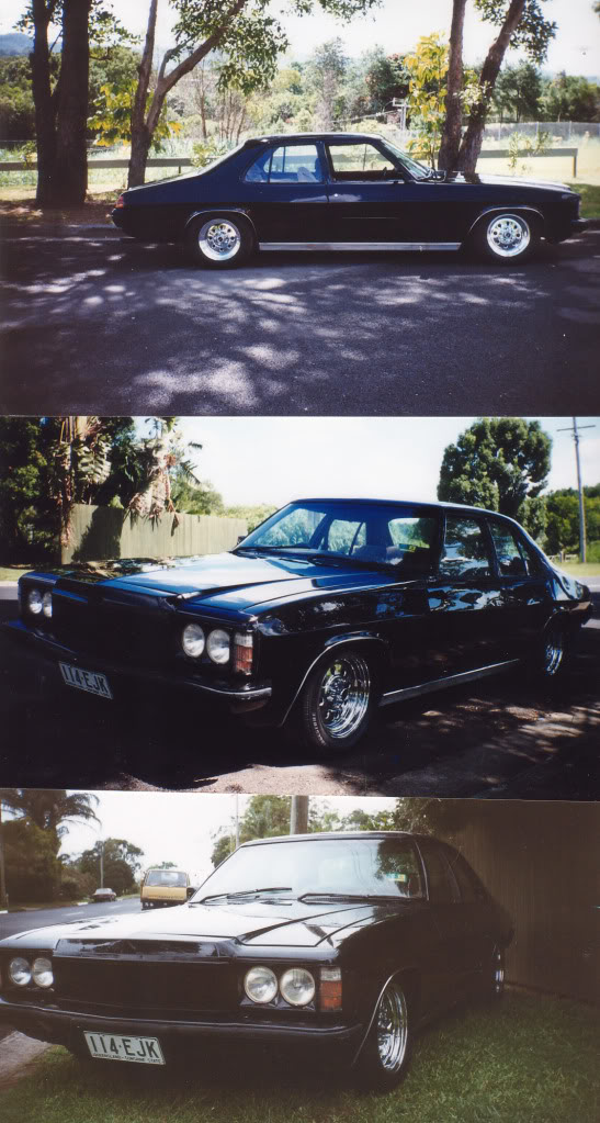

OK, I see where this is going. All this talk of painted bumpers and moulded in flares. I'm going to mould the bumpers into the body : ) hehehe
OK cruiza, I dug out a couple of pics of my old HZ prem that I painted the bumpers for. Mainly because the chrome was knackered, so I painted all the chrome except for the sill trim and wheel arch trims. I took every piece and sanded, primed and top coated. I even took the indicators and tail lights apart to paint. That's why I'll never do it again!!!!! : )
Of course being one of my old cars, I shaved all the badges and door handles too : )
This is another of my "less than $400" paint jobs in acrylic straight black with crap loads of clear over the top. I'll never clear a solid colour again either.
That was going to be my next suggestion!
Now I really like this, see you do have good taste after all hehehehe
Why's that?
#800 _dirtbag_
_dirtbag_
Posted 09 May 2010 - 10:40 AM
Apart from there being no real visible benefit when using acrylic, with the black car getting all the tiny marks out of the paint was a nightmare. If it had dust on it and someone brushed past it, there'd be visible scratches in the paint. I'm talking microns here though. The reason it was visible is scratches in clear are white. Picture that against a black background.
I'm not against clear over base in 2k if there's going to be multiple colours and you want a smooth coat over the top so there's no edges to feel, but I would not suggest it with acrylic. Leave clear for the pearl and metallic colours.
