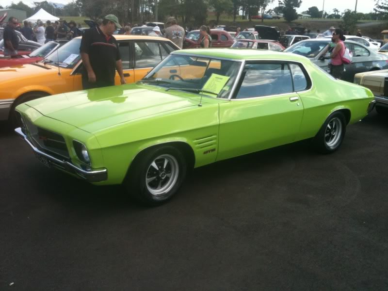

#439 hanra
Posted 02 September 2011 - 12:46 PM

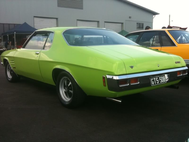

Ive come in a bit late here, but this a Lina Mint car. Personally I would have left it that colour.
This is my good mates 71 GTS.
Edited by hanra, 02 September 2011 - 12:49 PM.
