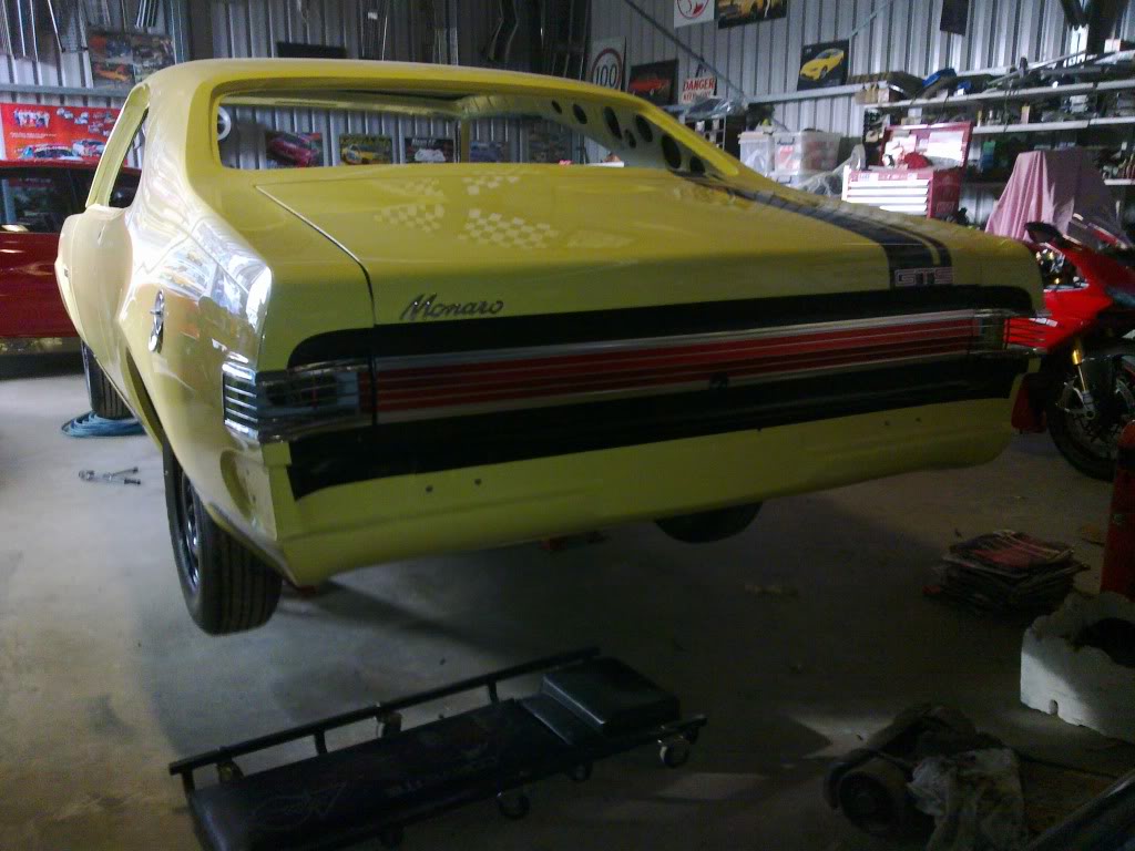

the yellow car is fairly standard,and the blue one modified.
i,m near tamworth.

Wow, there beautiful. A mate of mine has a yellow monaro, looks identical to yours. How tough does the blue one look!

Posted 02 September 2011 - 08:12 PM
thanks,
the poor blue fella has been sleeping for some years,kids have changed things and i havn,t been able to play with it,i use to drag down your way,bodangra airport,think thats sort of close to you.

ran some methonal through it on the june long weekend,got them out for the day.
does your friend with the yellow car have a blown fj ute
