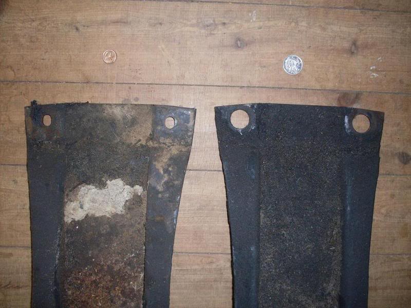

A couple of years ago i wrecked 2 1973 LJ 4 doors, one was a traumatic auto and the other was a 3 speed manual. The auto had the rubber while the manual never. Also i noted the holes in the auto crossmember were larger (Around the size of a 10 cent piece) while the manual hole sizes was around the size of a 1 cent piece...........

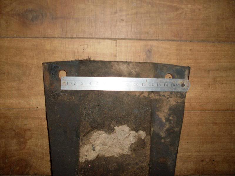

^^^^^^^ The manual is on the left, the auto on the right. The 1973 cars used a much stronger gearbox crossmember compared to its 69, 70, 71 and 72 brothers. I feel alot of these extra strenghening bits on the 73 cars was learn,t while developing the V8 LJ in 1972..................

Im presumming because the 73 crossmembers were wider the 2 holes either end would be wider also. I have,nt got a LC or 72 LJ crossmember hear to compare. Can someone measure a 73 one to a LC or 72 LJ one please ???? It would appear they all ran these metal spacers though the 73,s may of had to be made longer to accomodate the wider crossmember........

^^^^^^^ The 1973,s are roughly 14.5cms or 145mm from centre to centre.

I certainly did Craig and when i was a youngen i could buy 4 cobbers for a cent, then they went up to 2 for a cent, then a cent each, then 2 cents each. I stopped buying them at 2 cents each. I cant recall learning inches though, only centimetres and millimetres etc...........
It appears the LC and 1972 LJ had a 2 1/2 inch gap centre to centre, while the 1973,s had a 5 3/4 inch gap centre to centre requiring the 1973 cars to have a different sized spacer to its earlier brothers..............
