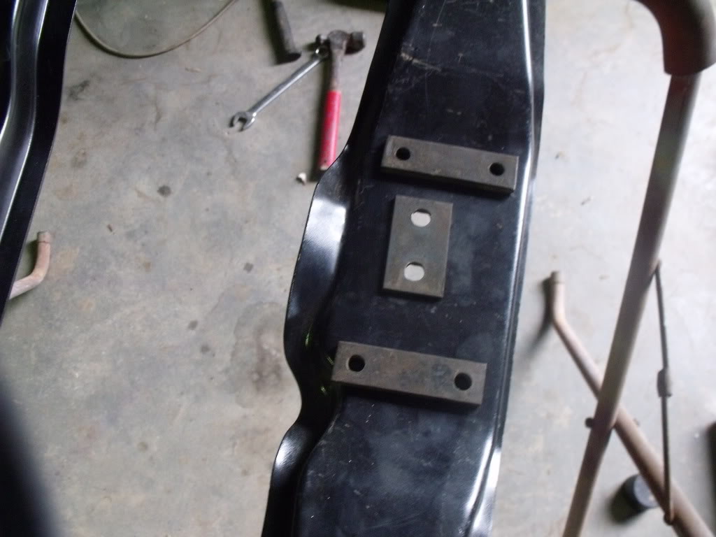

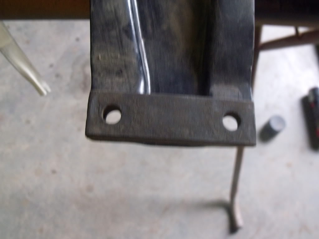

a 73 cross member where the bolts are have the ends lowered simmilar to a step on a stair case
hope this helps u
regards aldo

dane hi im happy to help you, fly has put a picture up of a 73 x member. its the one you need

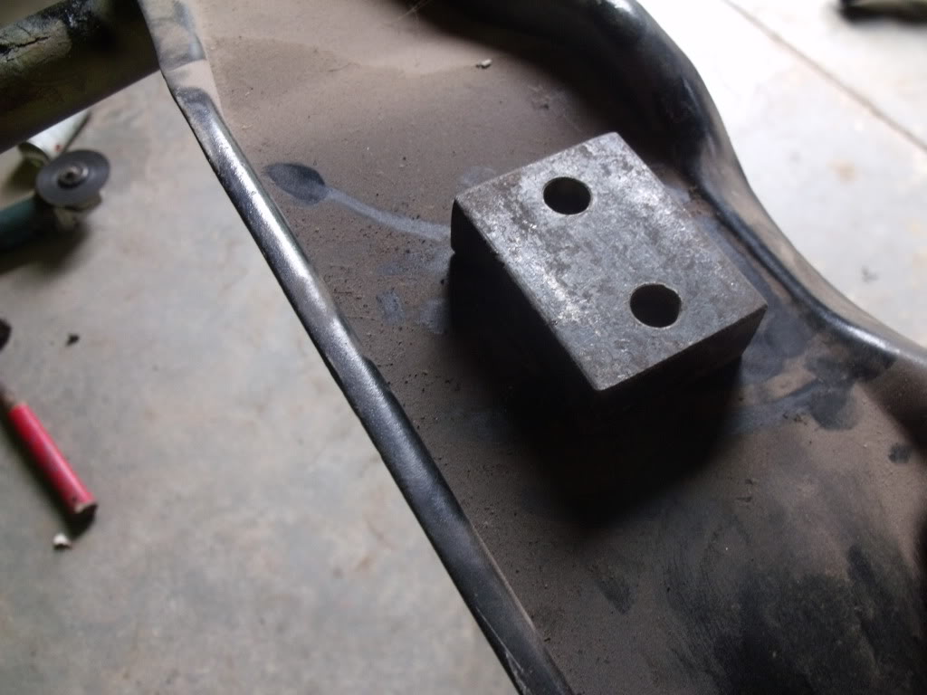

this spacer looks home made on my car ,
so does the large washer go on chassis rail for the step in cross member?you can see the marks on fly,s picture.
the way this one is,chassis rail,spacer block ,large washer for step cross member,washer ,spring washer, bolt.
just know this is wrong holden wouldn,t have put a washer then spacer, 2 peices for 1 job,not.

craig hi x member to body then bolts and large washer /spring washer just bolt up

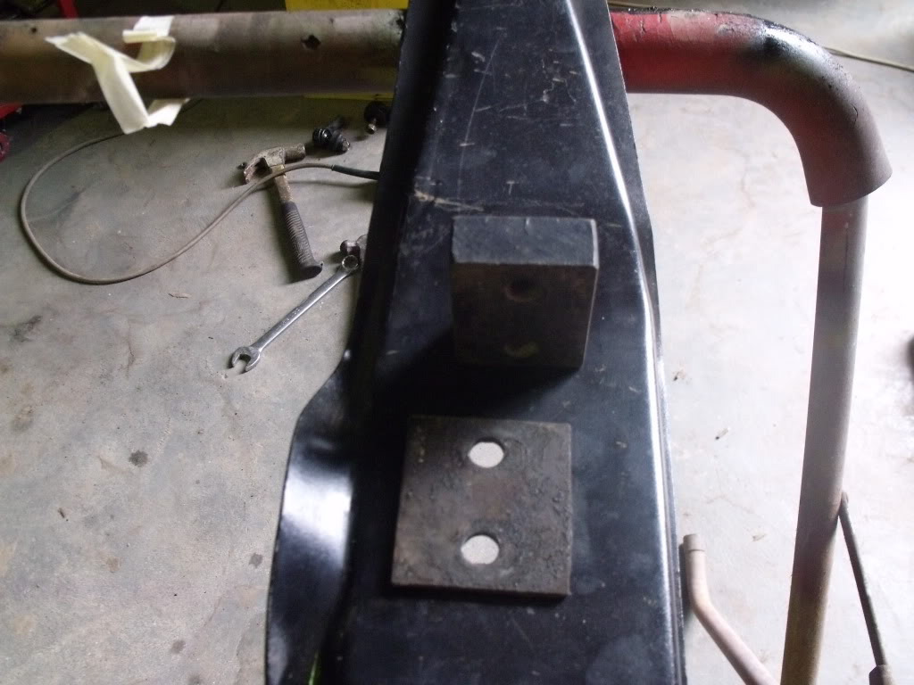

here are pics of a complete 73 set up
from the start of the aussie 4 speed in the lc gtr cf prefix right untill thay started the 73 cars you should have these but just change the middle bottem thin plate to the wider one, like in bazzas pic
these are for the lc xu1 of 1970 up til the change was made to the aussie 4 speed
i hope this as sorted it all for you fellars.
cheers gong

thanks for your help aldo and john,my bolts are correct just need to ditch the spacer,i may have made it many years back,as i copied of my 8th72 car back then,didn,t know anyone with a 73 car.
