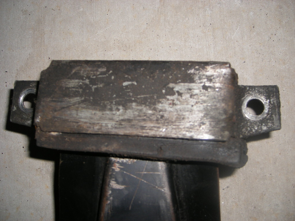

Hi NYC 71,
I have 71 LC was originally auto, the cross member ends were "wrapped" in a rubber block insulator when I purchased the car. I believe they were factory fitment.
May still have them in the shed if you are chasing pictures, I didn't use them when I fitted the 4 speed,
Regards Simon
hHi Simon
yeah mate that would be great if you could get a picture, can't seem to find much about them or if anyone makes an aftermarket version

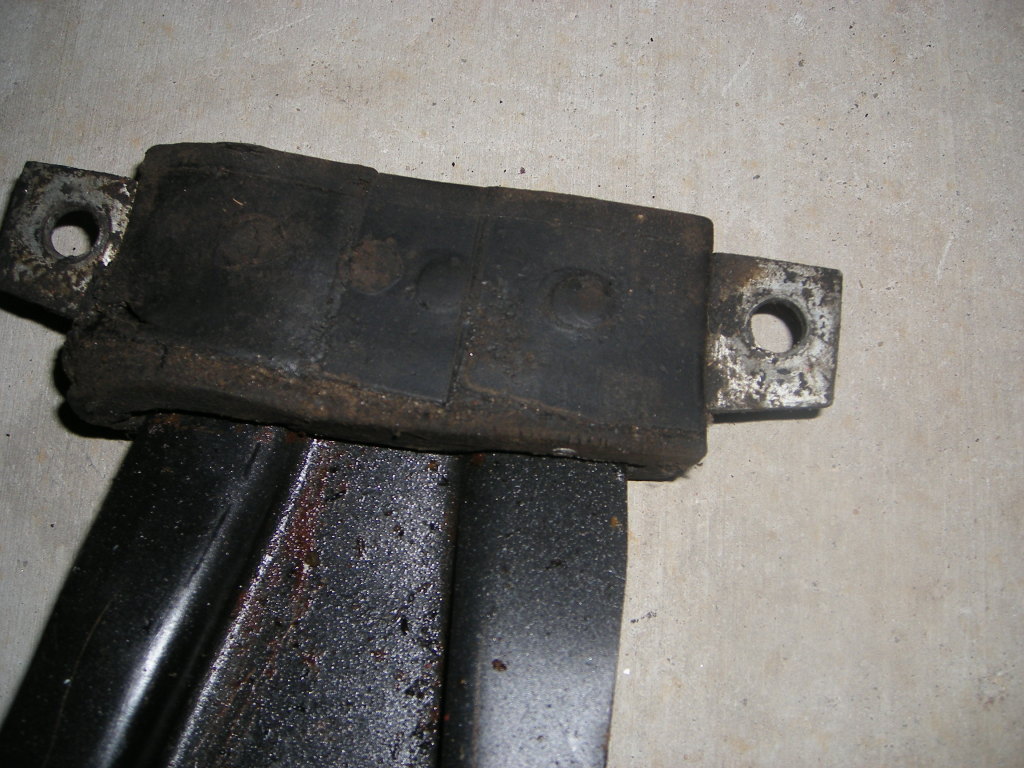

Will do, I'll dig through the shed tomorrow, I think I still have the rubbers there

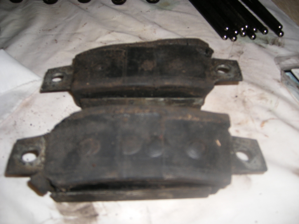

Here are the auto insulators , hope this is a help,

thanks mate thats a big help, now i know roughly what i'm looking for. ive never seen any like that on a torana that ive worked on, so does anyone know if anyone makes a aftermarket version or similar. i couldn't find much out about it on the internet.

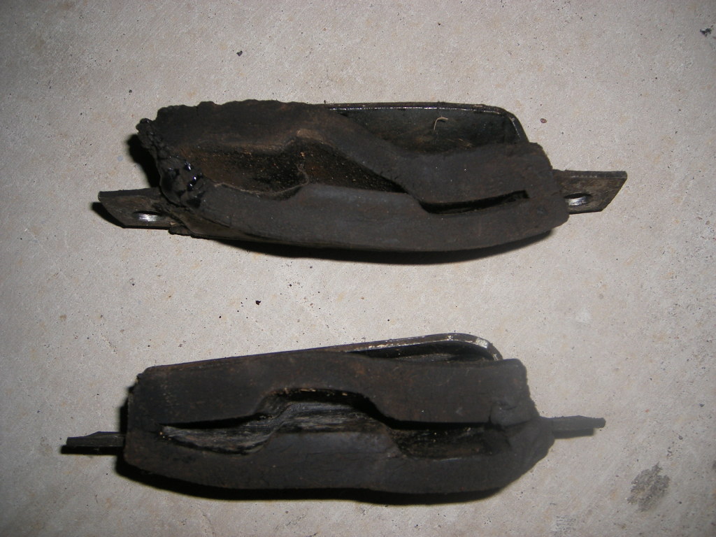

This might help...
I had to take them off when I did a manual coversion on mine...

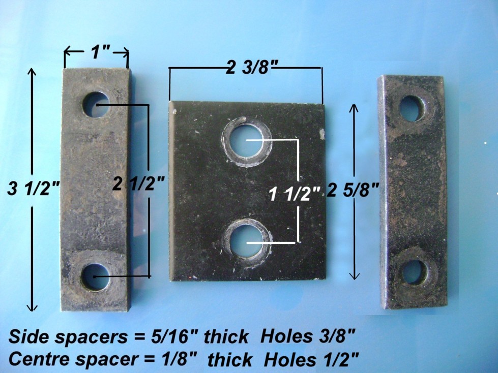

This is a spacer kit for an Opel gearbox. As far as I know, the Aussie used the two rectangular spacers on the crossmember as well (but not the big ones in the centre).attachicon.gif2976_1.jpg
Found this old thread
Anyone know the measurements of the big spacer ?
