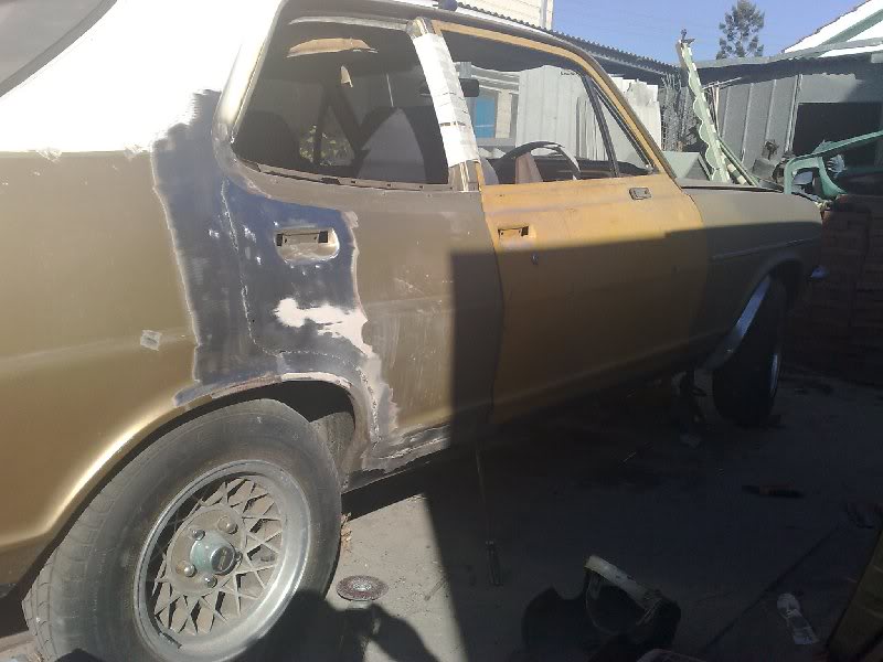

got the rear door cut down and part welded
#53 blown308
blown308
  • 2,329 posts
  • Location:Silverdale, NSW
  • Joined: 05-March 06
Posted 09 February 2010 - 11:17 AM
starting to take shape...

You have removed and replaced a structural member of the car (B pillar)
You're going to have to prove that the roof is still as structurally rigid as it was before and that the car is still "safe" for the road.
Id down tools and ring an engineer before you go any further, there may be a whole heap more involvement to getting it registered.
Spot on, (sorry to be a party pooper) but I doubt he will find an engineer that would be prepared to approve the mods in the manner that he is doing them.
I've seen the pics and am disturbed about the idea of just welding on the rear door skins and it appears that the leading edge of the original window frame is forming part of the new B pillar. There are a number of differences between the 4 door and 2 door body that will affect the strength of the car.
If he was grafting in all the correct parts from a donor 2 door body then he might be in with a chance of the car being as structurally sound as an original 2 door but alas I would hate to think what would happen to that car and its' passengers if the car was T boned or slammed into a pole. Also think about the emotional and financial toll when he is sued for killing someone in an accident.
As for registration and insurance, he should get rego if he can get an engineers certificate, however, knowing what insurance companies are like he will be extremely lucky if they will insure him. If he doesn't tell them about the mods so he can get insurance they will wipe him if they ever find out. One has to remember that the body tag identifies it as a 4 door Torana.
I reckon he has two options to choose from: A: Scrap the car and find a 2 door Torana. B: Find a donor 2 door (4 cyl body will do fine), find an engineer to certify the mods and find a reputable panel shop to do the work.

if the car was slammed into a pole?????? same welding as replacing the rear 1/4.....are you a panel beater looking for work???
wow what a bunch of party poopers...
There is no difference between welding the rear door and welding a proper rear 1/4..
its the same part really....
B pillar will be fully welded back in place and to the rear door/1/4..
its just moved back 150mm
perfect fit.....
B pillar is forming new window frame ..same as 2 doors....
never mind
cant please everyone
#68 _niterida_
_niterida_
Posted 11 February 2010 - 05:12 PM
Yeah I can't see a problem with it - it is essentially the same as a factory 2 door so an engineer should just rubber stamp it as long as the workmanship is up to scratch.

it is allready regoed.....
inide rear 1/4 /door..will have the old skin welden back in..
the B pillar wil be reinforced..3mm plate.
and will the sills as they are rusty....
i never new i had so many freinds..
thanks again lads....
dont worry so much i,m not an idiot...been doing it for years....
