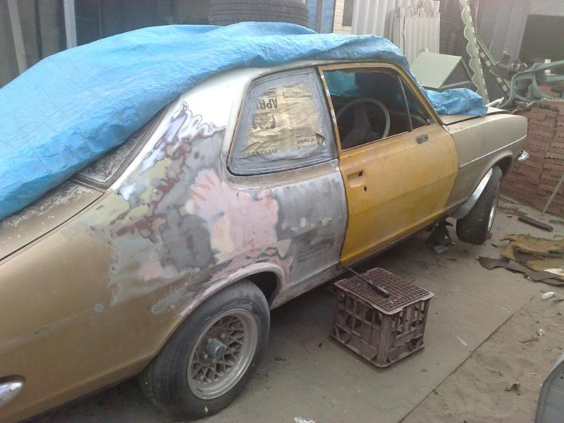

rear 1/4 nearly finished...

One thing that stands out to me is the B pillar on a 2 door isn't as chunky as the 4 door B pillar. Do you have the rear window to check for fit?
If you reinforced the roof and the 'rear door' area could you have a smaller/thinner B pillar? The front edge of the rear window looks like the biggest difference.
Need more pics...
Engineering-wise I have no idea except that you might be OK if the body rigidity is the same or better.

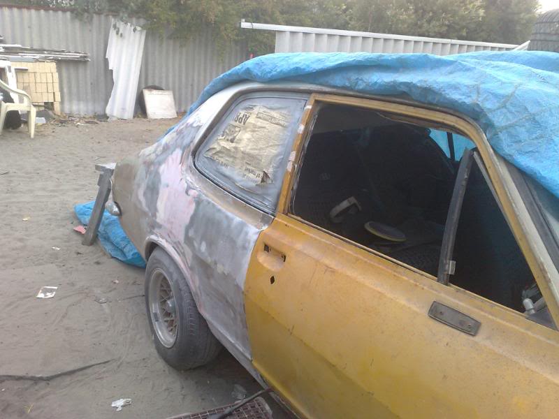

rear 1/4 windows fit nice
B pillar still a bit more work
