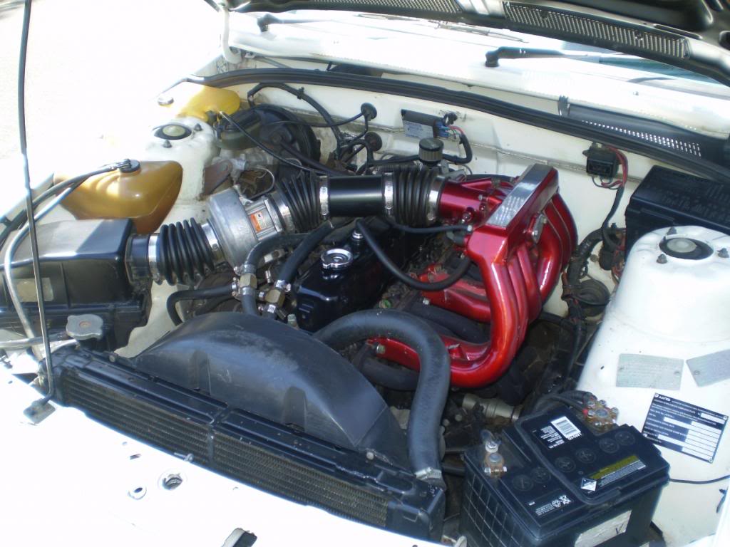

#557 _Lazarus_
_Lazarus_
Posted 08 October 2013 - 11:00 PM
If you're going for injection why not go with an injected 202 ?
That would be the cheapest. And no engineer's certificate.
Stick a 12 port head and VK injection on your motor (or buy a complete engine), an aftermarket fuel only ECU and a nice little cam and extractors.
A Celica 5 speed conversion maybe, and Bob's your Mum's boyfriend.
Until you start calling him Dad, that is.
#558 _mick74lh_

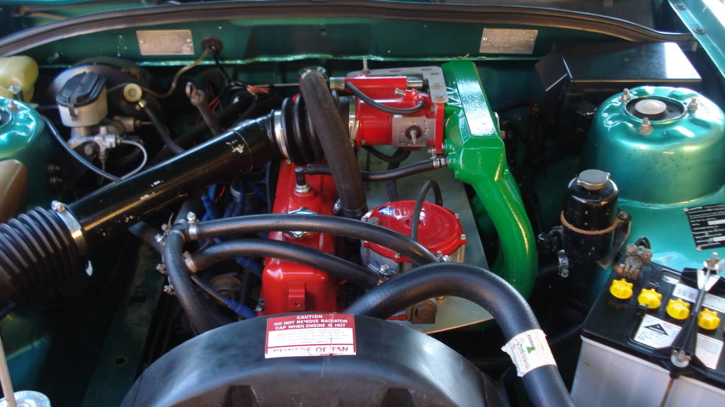

Posted 09 October 2013 - 12:00 PM
The injected 202 is good and cheap. And you can use the M76 five speed which bolts straight up. Bogans will say that its too weak but only if you're flat out abusive to it. With the overdriven 5th gear you could keep your short diff gears and it will cruise nicely on the highway as well.
Or if you want even better and cheaper fit a gas system to the injected manifold. In my VK I used an Impco 225 inline mixer and the VK EFI manifold and throttle body. Because it's straight gas I blanked off the injector holes with appropriately sized welsh plugs. The engine, gearbox and gas system (excluding tank and certification) cost me under 1K. Its rough but cheap as to run and responsive to drive.
And with gas you can run higher comp.
If you want it to look neater you could use a Gasresearch throttle body / mixer like this guy has:
