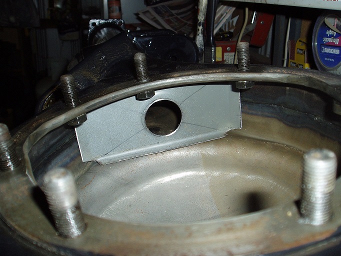

Rob, make sure you have some gaps around the baffle for oil to drain back from the axle tube to the diff.
#481 rodomo
Posted 25 November 2019 - 10:54 AM
You might be able to make out in the pic that the corners have gaps?
#482 S pack
Posted 25 November 2019 - 12:07 PM
Picture doesn't really show up any distinct gaps.
#483 rodomo
Posted 25 November 2019 - 09:27 PM
That's cos they're secret gaps.
