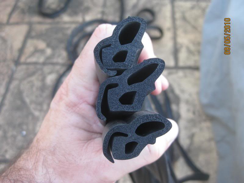

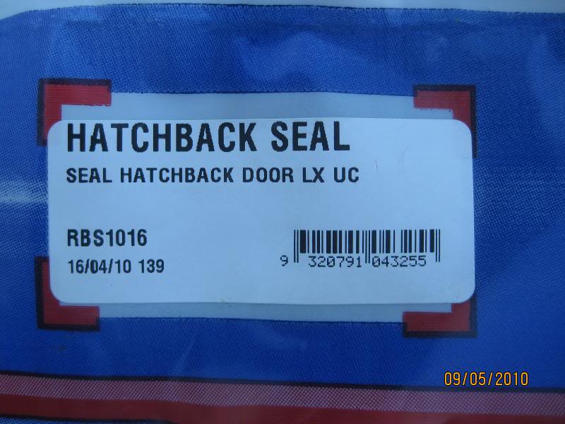

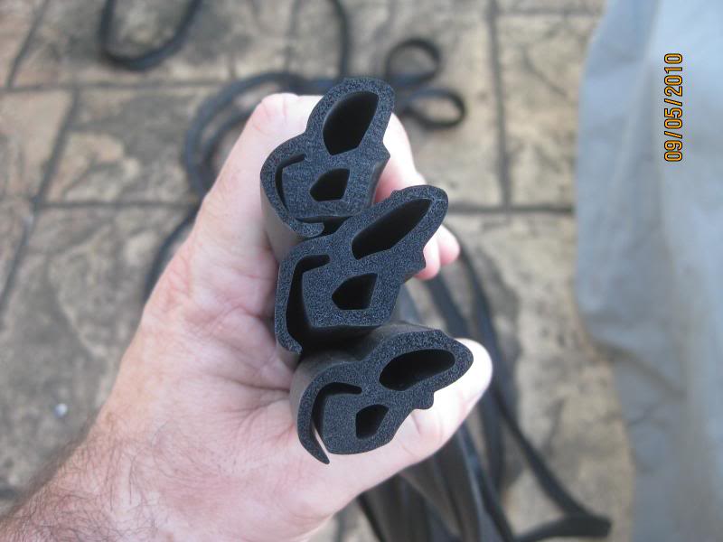

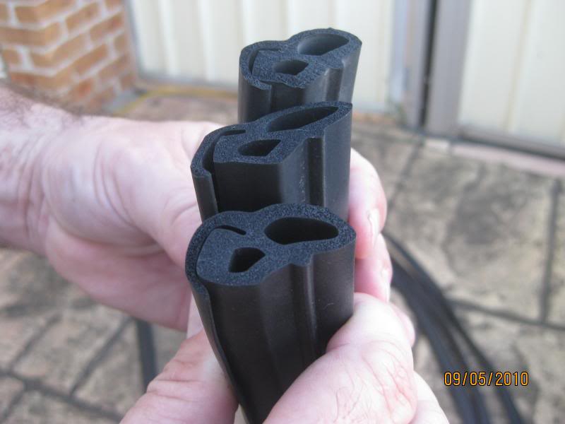

ok here we go. first with the 3rd lot of rares door rubbers. its been a few weeks since i fitted them and i have to say they did get a little better. the 3rd lot are very very soft and they did squash flat and out of shape in the problem front lower corner. all the way round the door frame the rubber was out of shape but did shut a little better.
now the new rubbers from aussie muscle car parts in qld. now these do look like the genuine rubbers with different locating lugs to the rares rubbers. i did have a little problem fitting them, the black plastic things in the door frame are a little to small, i had the make the hole rounder by using a small plillips head screwdriver. cause the genuine ones are not round enough for them. once that was done with a fair bit of pushing they went in. now looking at them fitted and checking the genuine ones fitted to the slr they do look the same. shutting the door at about 30 cms it closes perfect and you dont have to slame the bloody thing hard.

#35 _lx5008_
_lx5008_
Posted 08 May 2010 - 08:59 PM
yes some thing new. so many new lx stuff coming. even the correct rear hatch rubber made from a nos rubber. its even bent at 90dec in the top corners how it should be.

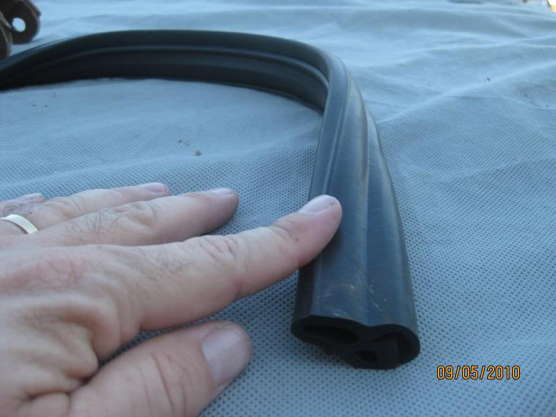

Rares has changed the hatch seal, but it is still not as per original..the section that sits in the square channel is not square as per the original for example.
But it is a massive improvment over what they (and others) have been selling for the last 20 plus years.
Just check you are getting the latest, as I'm sure a retailer would prefer to move old stock first!?
If someone has the latest RS seal, could they post a photo of the side (cut end) profile? Just to help other check?

Hey mate
Graham has rec'd the "latest" hatch seal from RSP a couple of weeks ago so he can post some pics of the profile, etc. We are waiting for the sample from AMCP to test both on his hatchback. When we test these we are going to shoot some video rather than trying to explain the differences..
One difference that we have been told is this.. The AMCP sample has the bends for the corners already shaped into the seal... This we have been told is how the original ones were....
Mick

the main thing that upsets me the most is the fact that these cars cost us so much to resto and the cheapest part of the resto is the rubbers. for many years we have had no choice and just had to put up with poor fitting rubbers until NOW.
now the top rubber i got a while ago, the middle one was sent by rares 12 months ago for free after a phone call to head office and the bottom one was sent also for free a few weeks ago after talking to head office.
now the two first ones had big problems shutting the tail gate and the 3rd one is much softer and smaller than the two first ones but been smaller it does not hold in the rail. and all three have big problems in the top corners. you just bend and straight bit of rubber 90 dec and expect it to sit right.
as mick said we are waiting on a new one from amcp made from a nos one which is correct with the corners bent.here are some pics of all 3. note the last rubber sent was made 04/2010. also only the second one sent had the air holes like the genuine rubber.the ist and last didnt????????

Thanks for the photos and indepth update.
